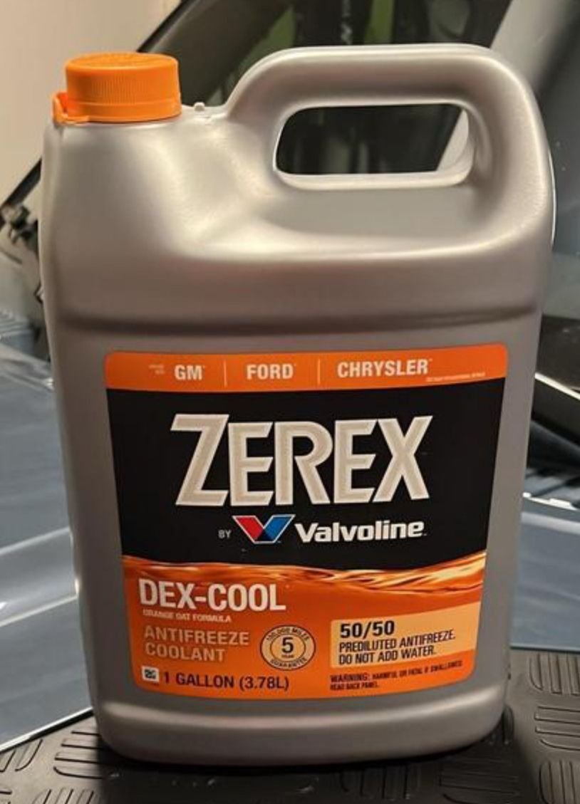

Originally Posted by outrise1101
My 2024 110S just had the low coolant warning come on. The resevoir is just below the Min line. I want to top it off before driving 1.5 hours to the dealer. Is the Orange Prestone DexCool a viable alternative or should I try to track down the Havoline XLC?
Havoline DexCool should be fine, since it is OAT, organic acid technology. I went with Zerex DexCool by Valvoline, most claims refer to the color, orange, as being the compatibility factor when choosing.
