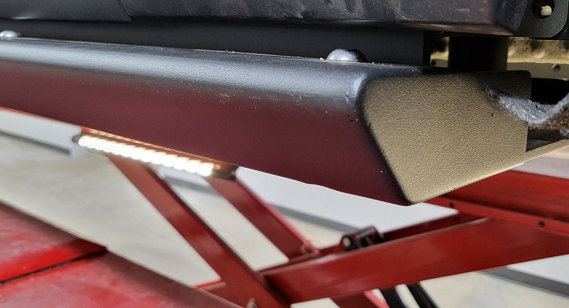

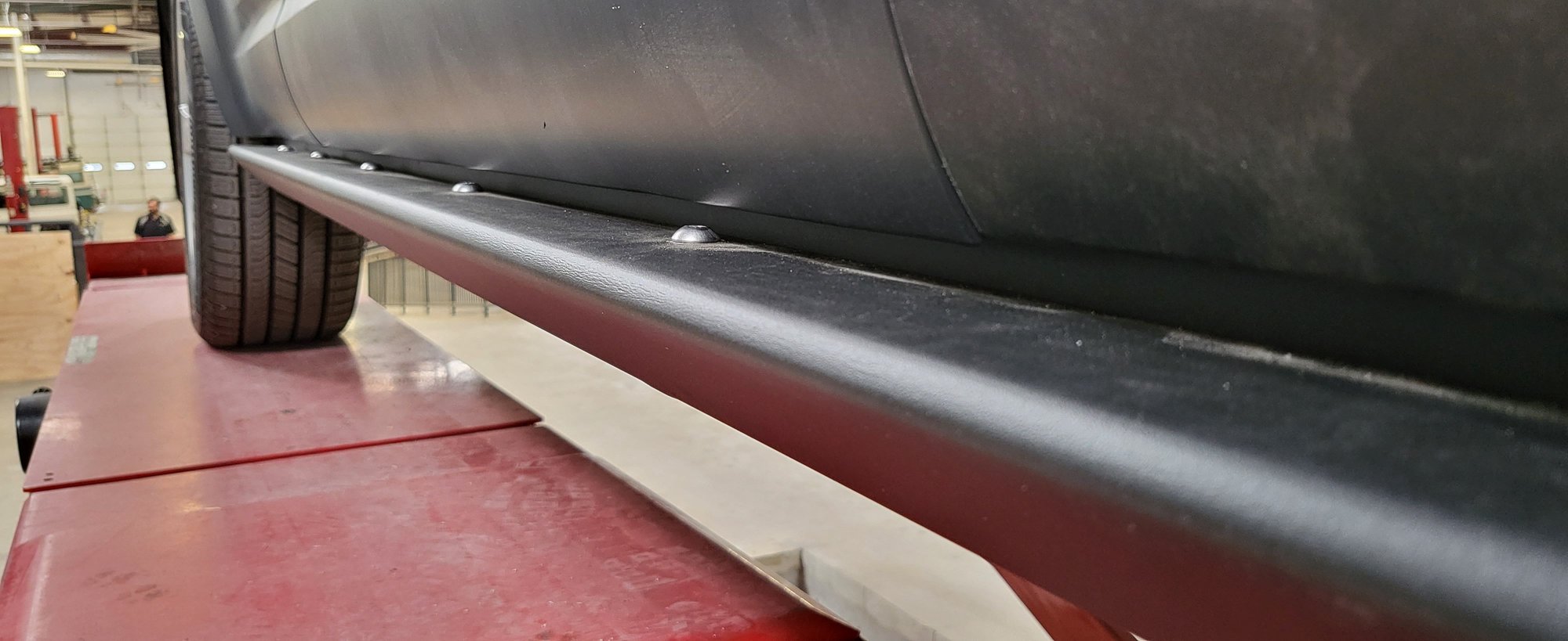

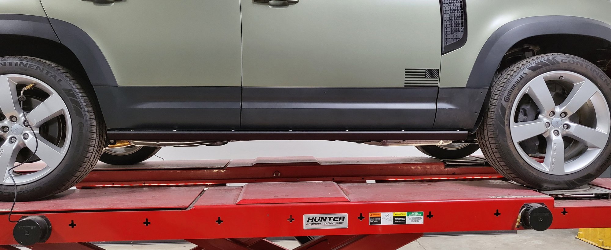

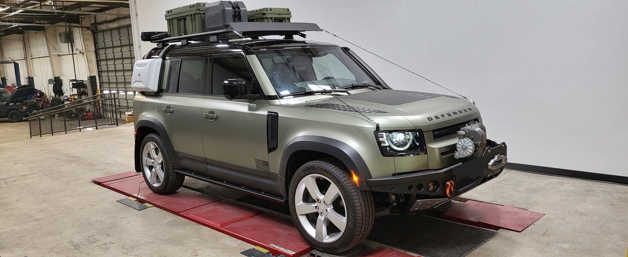

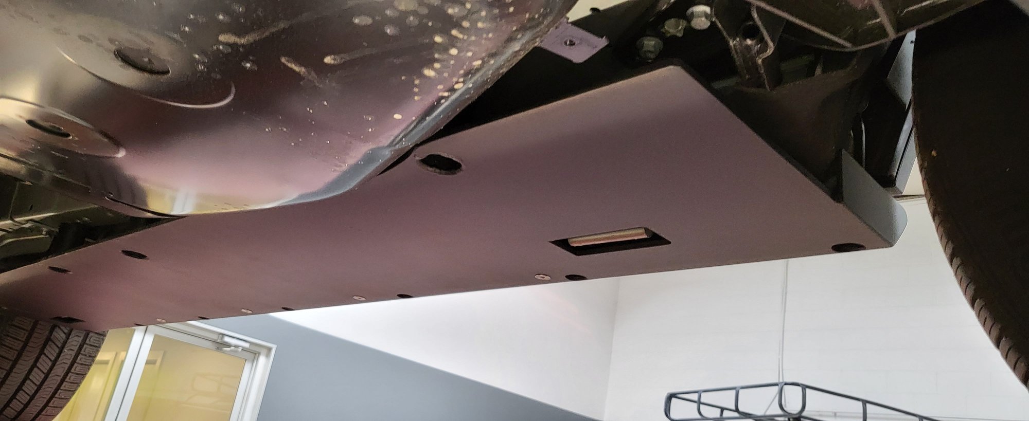

Default Aluminum rock sliders
Here is our 1st set we made for a client. Making a set for our 90 next. Followed by a set for another 110 with a requested mild tree bar. Note gap at front is for the accessory mud flap. Otherwise would be flush with fender opening. All aluminum 1/4 wall construction and will be offered with UHMW slider surface bolted to the underside that can be replaced.

Wow, these look pretty cool! How much modification to fit them? Any cutting of trim, body, etc?
Also...where is that front bumper from?

Sarek, that looks great, I would definitely be interested in a version for my 90

Love these! When will they be available for purchase? And pricing yet?

Sarek:
Well you said your rock sliders would be discreet, light, sleek, have renewable wear surfaces, allow access to the vehicle lifting points and be ready by the Spring -- and you achieved this !
Also, nice to see your aluminum bumper in black -- very interesting to see it on an unlifted Defender. I see you have the sensors in place -- nice !
