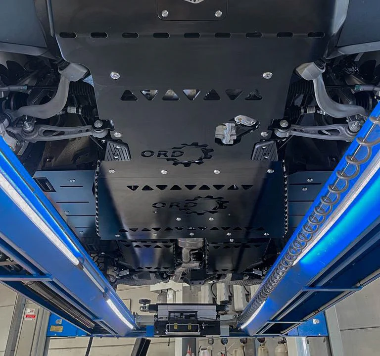

Not sure if anyone has seen the new underbody kit from new defender mods but it covers a lot under the truck. The question is what is that felt under shield for since it would not fit if you used this new kit from them. They said it comes from Germany so I wonder if this is that kit you were mentioning earlier.
Anyone know the true purpose of all that felt? Do you think the removal and replacement with steel would cause more noise? Do I really need all this protection. I am not going to Moab I just plan to camp slightly off road "boondocking" Can't really do something like Rubicon trail without a serious lift and larger tires anyway.

The felt which comes with the vehicle is of a sandwich construction -- felt on two sides over a stiff, thin composite sheet. It is stiffer and more sturdy than I expected.
Yes, without the felt, the vehicle might be a bit noisier. More importantly, without the felt the multiple tubes, pipes and wires under the vehicle will be exposed to being detached by sticks and rocks on the trail. Also, the felt keeps those items from getting dirty and stuffed with embedded leaves, small rocks, mud, etc.
Subjectively, I think more noise would be created when you add the proper off-road tires one would use to support the investment of $5000 USD in the metal sheets, than in just removing the felt.

The kit offers quite a bit of protection
