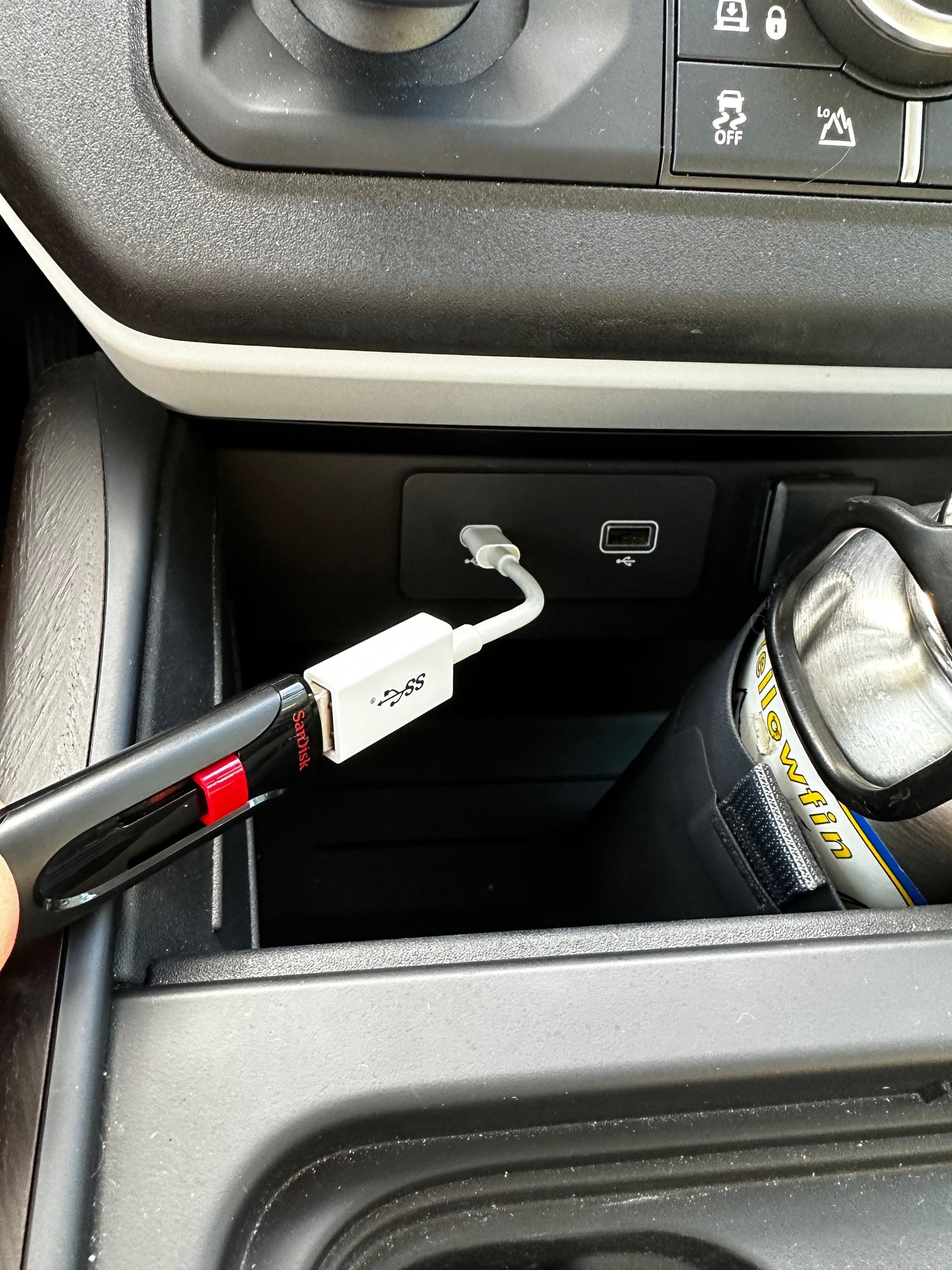

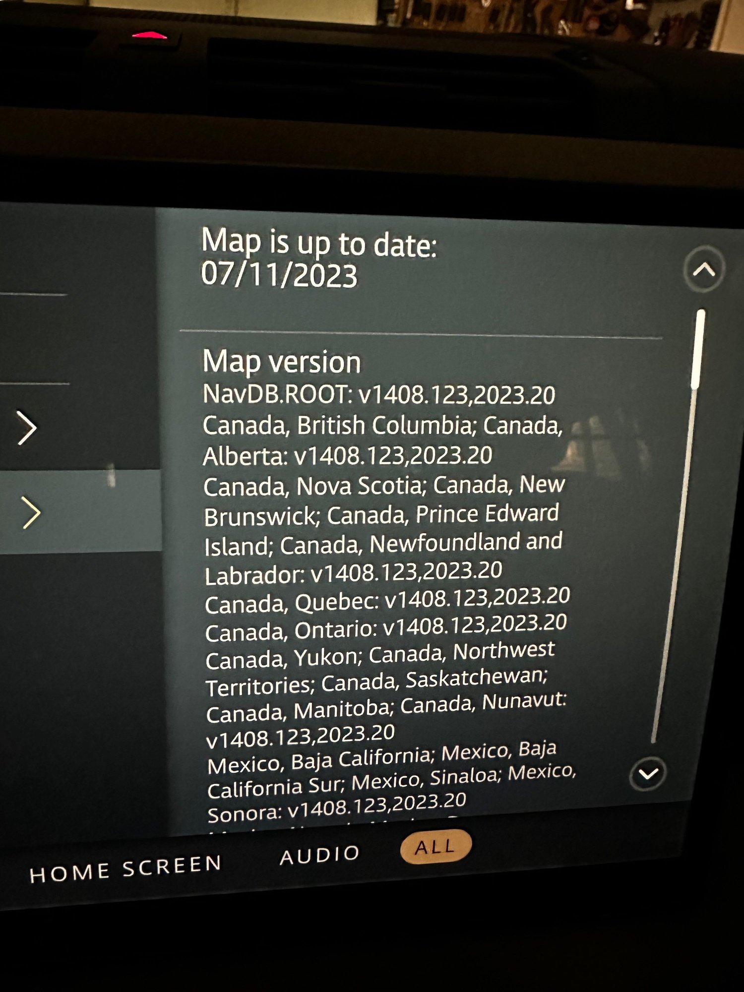

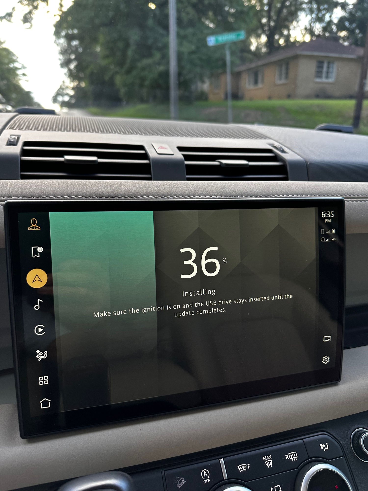

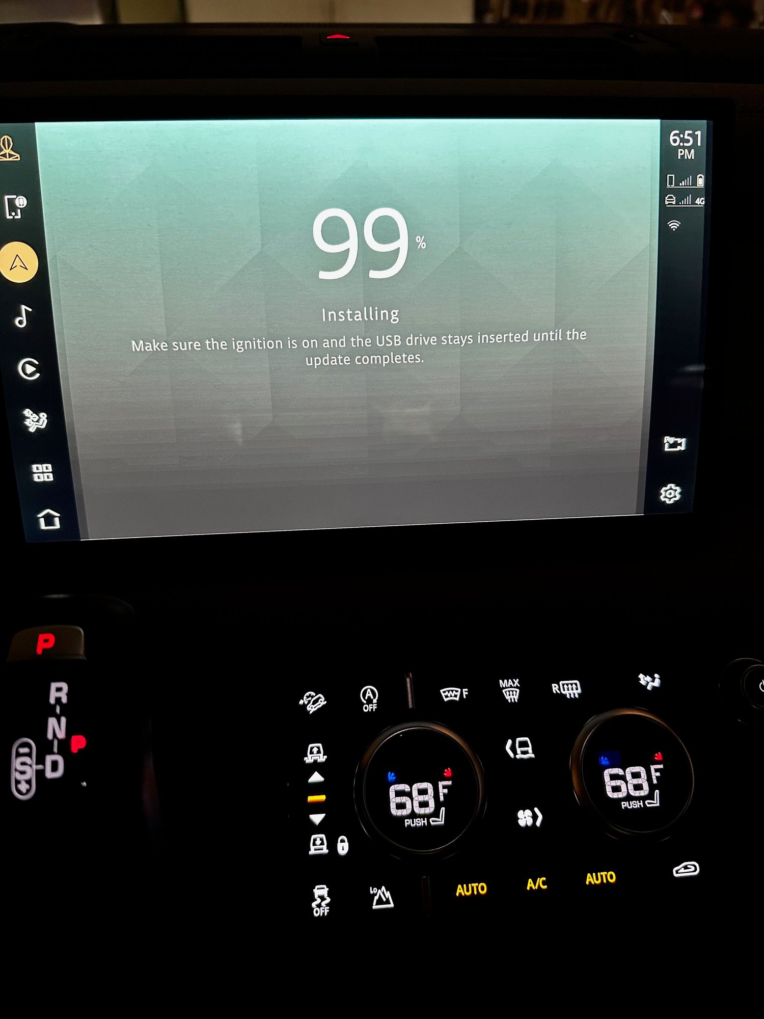

Went to navigation settings menu and saw that an update to maps was available "New Map Available". So went to my Mac and went to the Land Rover map update website, entered my VIN, downloaded the Map Downloader software, plugged in a 32GB USB-C drive and After the long (6-8 hours) download via the Map Downloader app onto my USB stick, I plugged it in to the data port on the dash and it took about 20 minutes to install, despite saying it would take 40. I just went for a drive while it installed. It hung for a few minutes at 100%, but then returned to the normal Pivi Home Screen. I went back to the Navigation settings and the screen showed "Map if Up to Date"

DRCOOP:
Thanks for the detailed photos!
By-the-way, the USB-A port works just fine so you don’t need that C-to-A adapter.
