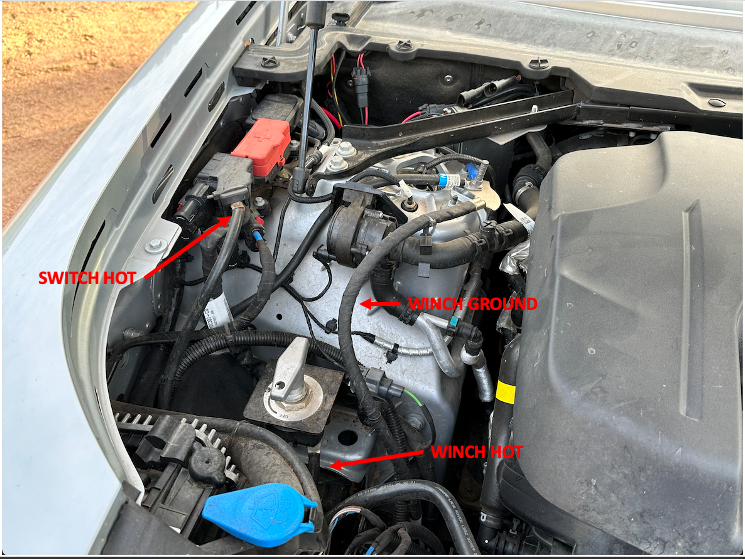

Hi GrouseK9, can you take a picture of exactly where you placed the HUGE switch ? Thank you in advance.

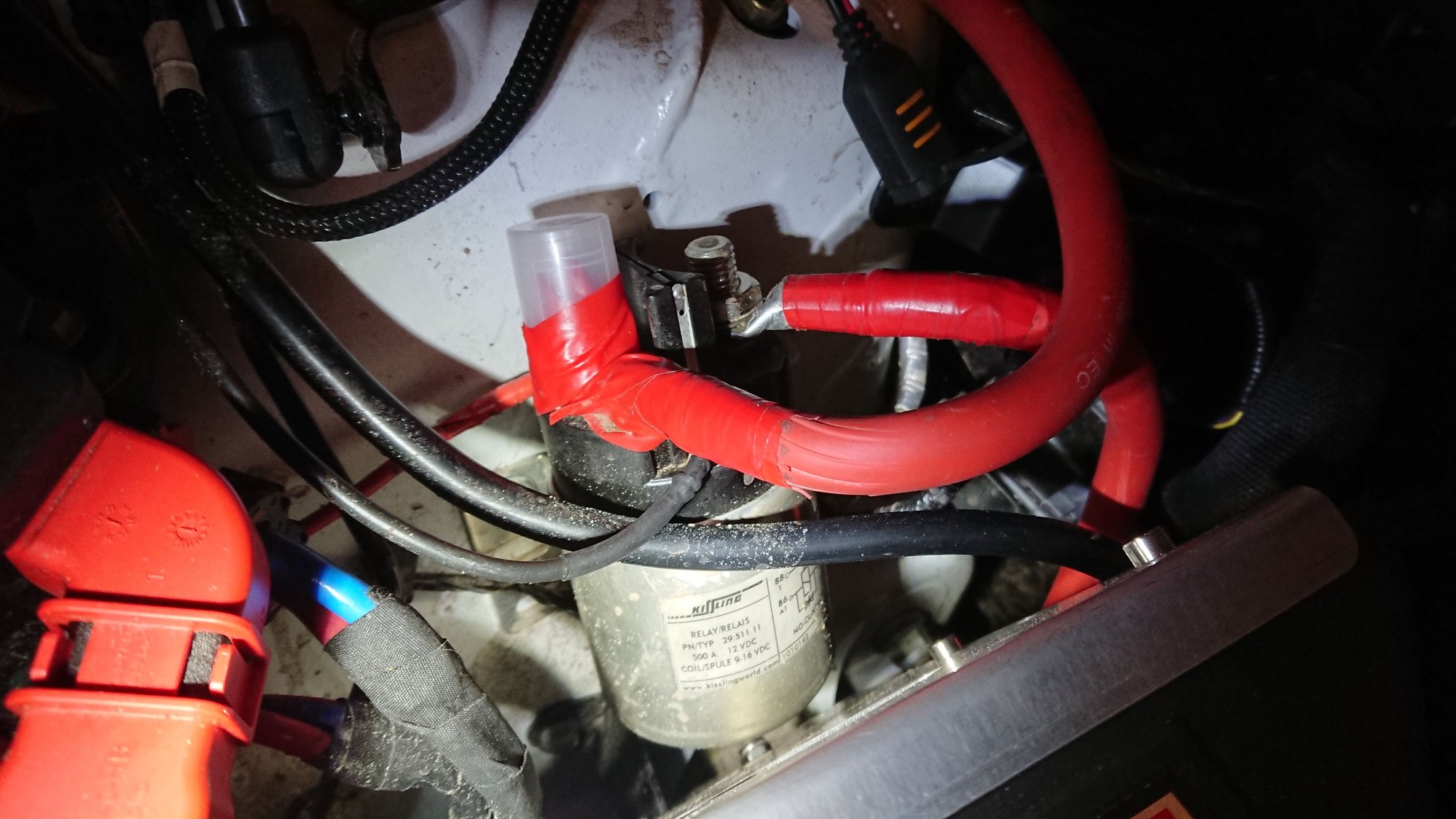

To isolate the winch a solenoïde / relay is needed. The winch can take up to 450A. So a heavy duty type is needed.
I use the Kissling 29.511.11 , so just with the flip of a switch I Power up my winch. After shutdown no current will flow, so everything is safe.

Here you go. It's in the left bay. Passenger side. I really like it there, but I am also going to drop in a compressor practically on top of it. I have a LONG number of things to do that are pushing it back, but I have the parts! It's the Saltek version (Link) bracket and the twin compressor from ARB. However, I'm REALLY eyeballing the hood. I may add some rivnuts and just mount it in the same location upside down on the inside surface of the hood. Hope you can envision that. Then when the hood is closed, it will fit there - but when open, I can get to both the winch switch and the compressor. I've laid it in there and think I still can operate the switch. I'm still thinking it thru and thought with my few brain cells usually takes a while...
Anyway, here's the switch location. Let me know if you want different pics or angles.
Sadly, I can't give you a link to the part because I got it from ebay. I took a chance and must have been living clean that week, because it's perfect. It's a 500-amp cut-off switch if you want the search terms. I'm sure someone more electrically inclined than me can give you a more proper spec, but I went overkill.
