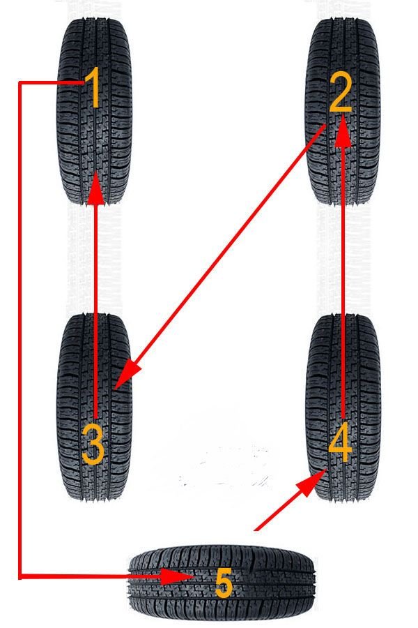

yeah. They do. with a full size spare on a “looks like the others rim” you should rotate all 5 from the get go.
That way you will always have a spare with comparable wear to the others
You will get 20% more miles on a set
you're paying for 5 tires. Using 4 is less than wise.
A five tire rotation pattern is the norm. Not using all 5 makes no sense whatsoever unless you are a tire shop.
rotating 5 takes a few minutes longer and means selling fewer tires.
Standard rotation pattern for a set of 5 on a 4WD

Bear in mind the 5 tire pattern shown is not for directional tires.
