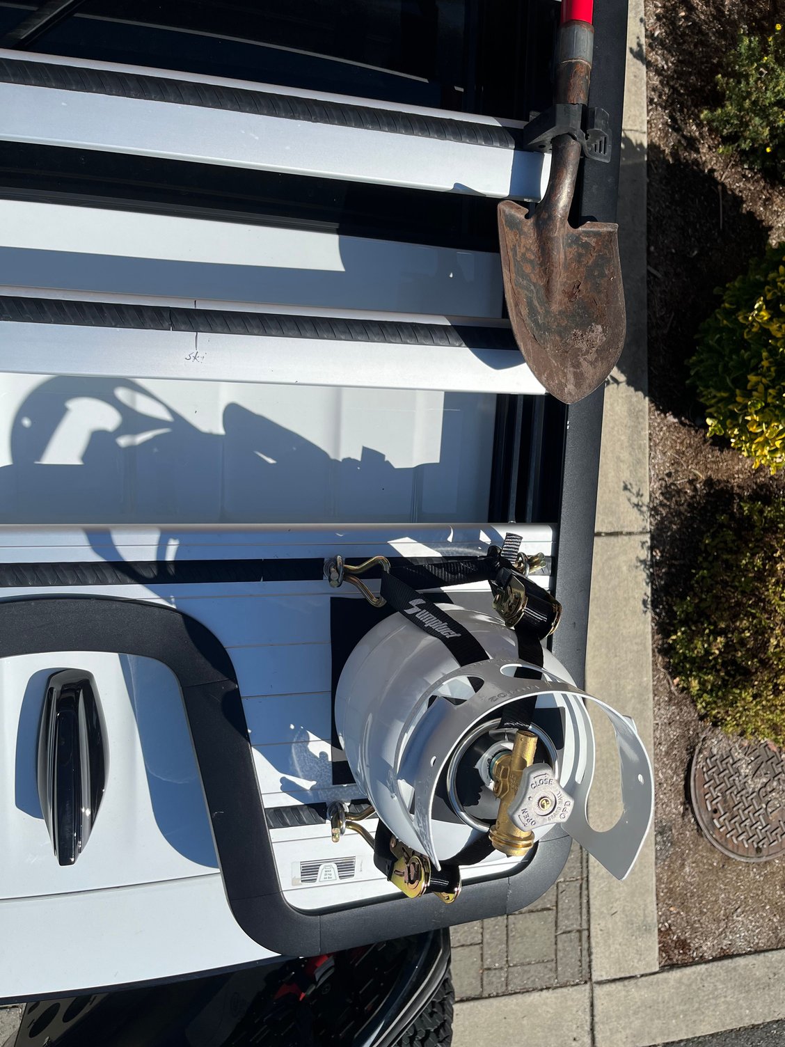

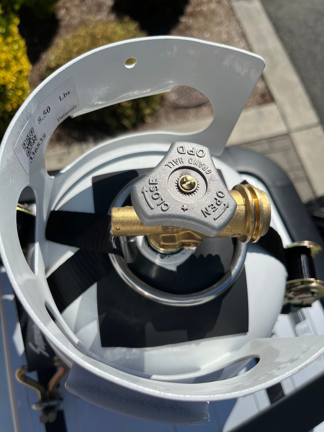

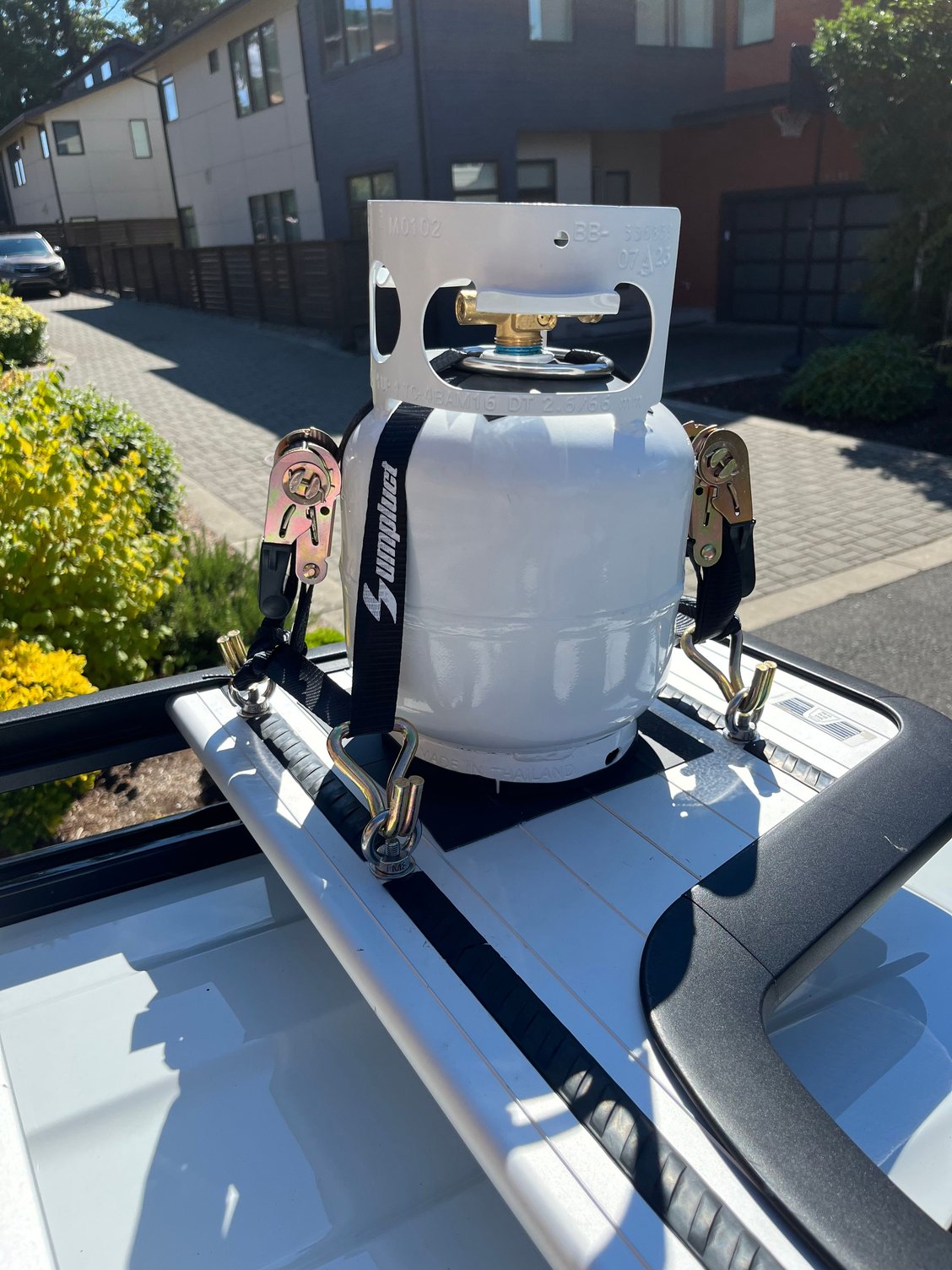

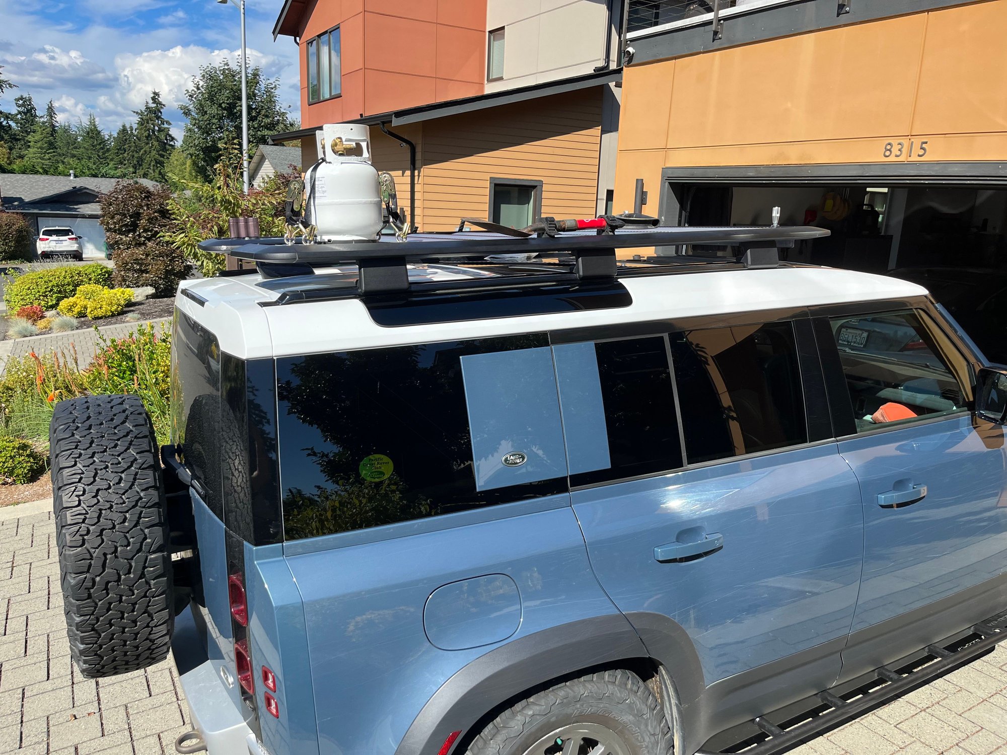

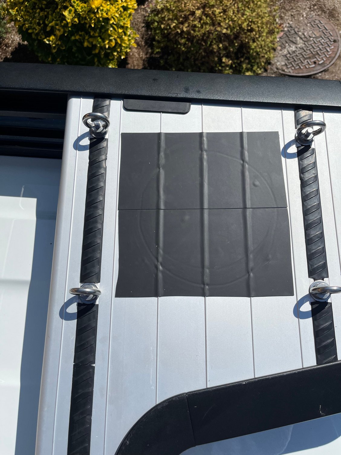

Tank Mount less than $50
  • 4 x M8 t-track bolts and loops in stainless steel.
  • 2 x 4' ratchet straps.
  • 1 x 3" steel ring
  • 4 x hooks.
  • 3M rubber sheet to cushion rack and tank.
On and off in about 30 seconds.
