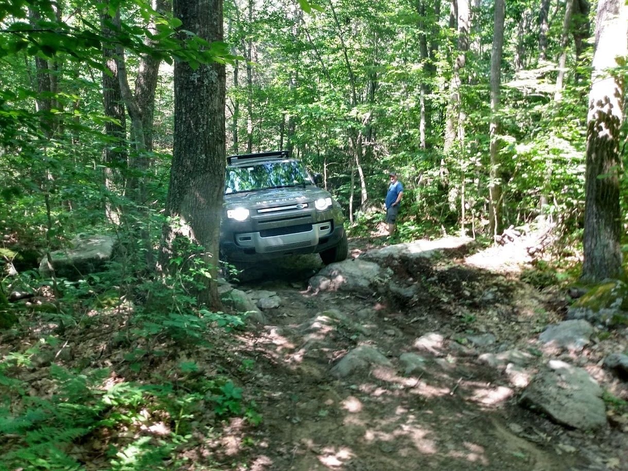

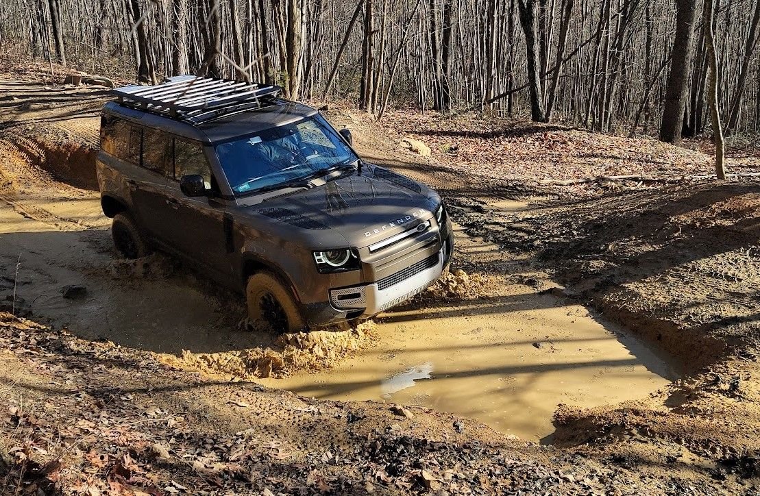

Everyone has a preference as to the tire they've invested a grand into. For me, it's the Vredestein Pinza AT 265/70R18 primarily for wet and dry traction, and noise. Check out the AT comparison videos at TireRack. FYI, these have been "field tested" towing my Airstream in the mountains of West Virginia and doing monthly off-road trail trips.

Thx. These were on my shortlist, as well. Tire Rack had them rated very highly, amongst the aggregated user reviews. My only hesitation was that the data sample was lower than the others. I'll have another look...

Note, the Vredestein don't have a particularly aggressive tread. But it does get the job done. That relatively mild tread is probably accounts for the quiet and comfortable ride.

Did you go with the LT or SL version?
