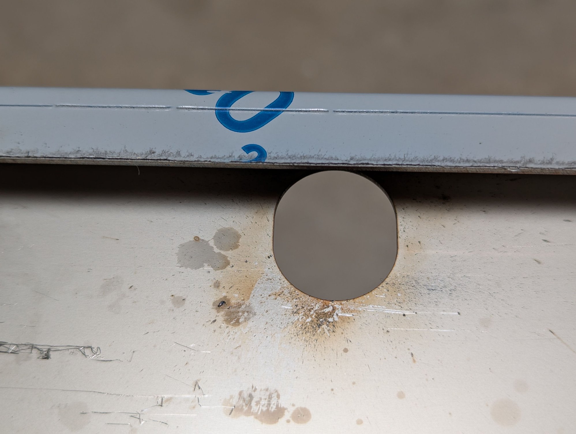

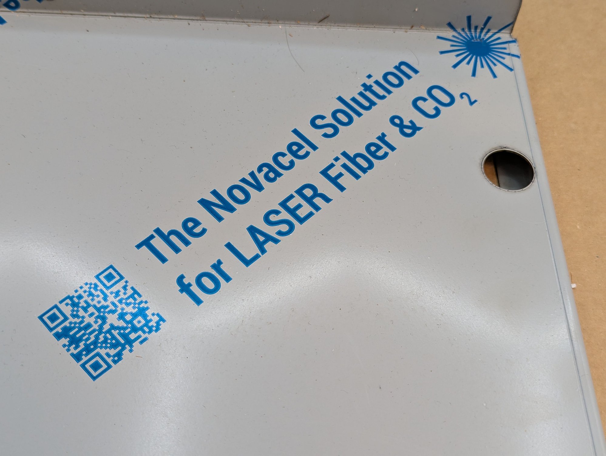

When Ronin Defender said "cursing and bleeding"... I don't know if I saw his post before and didn't realize what I'm looking at, or after I got the table when I knew what he meant, but yeah, that's basically what you get. The damn thing *demands* blood sacrifices. And more - not only the edges are sharp, that's not dirt that you see on the photos - that's steel spattered on the surface and welded to it. You will really need to work to get it off, and spend some time, abrasives, and elbow grease. Or else, your nice HDPE cutting board will be ripped to shreds in a matter of a few times of sliding out and in. Oh, and that protective film? It's not there to protect the manufactured part, but the raw steel sheet. The fact that it's there is not a symptom of caring for you (like it was claimed somewhere in the reviews), but of manufacturer's laziness (some call it "cost saving measures" these days, others "arrogance"). Look at the photos, you'll see what I mean.

Bottomline, this design has potential, but the execution absolutely killed it. I am looking at old reviews and see "no rattles" and "good fit" and am being genuinely puzzled - are we talking about the same product? It has the same website URL on it all right, but it absolutely doesn't look like the quality product folks say it was. Or did the manufacturer get complacent and relax their QA? But wait, no, that laser cut steel is a dead giveaway that it was supposed to be like that (along with some things in the Youtube installation video you will only recognize after you saw them in person while installing the table). It is as if they're saying "let's try to see how bad we can make it before they notice and the word gets around". Was it like that in the beginning?

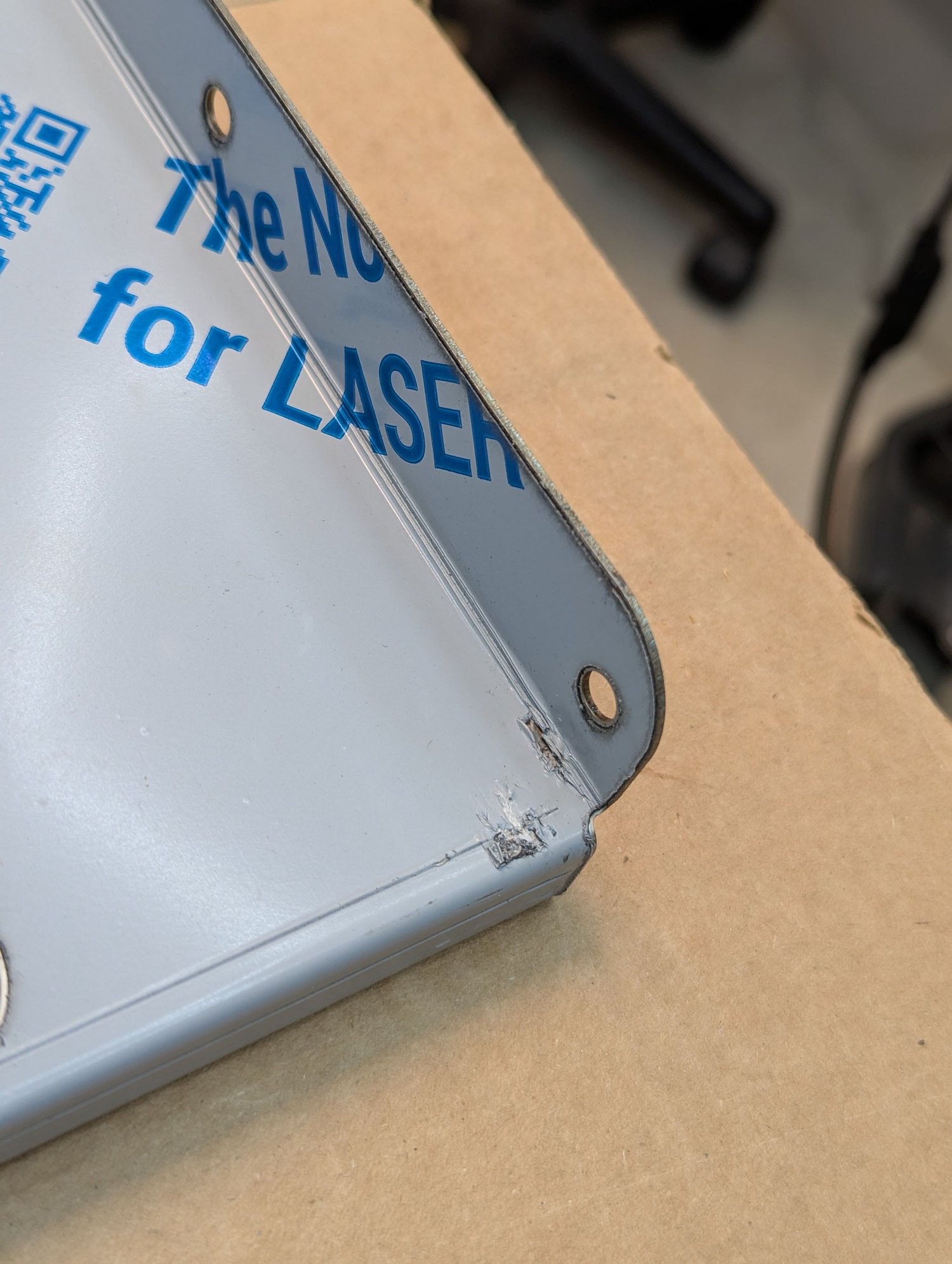

Part 1 - packaging. This was *inside* of the bubble wrap, so all of this happened at the manufacturer's site. Also note the crack in the powder coat; won't rust where I live but will elsewhere.

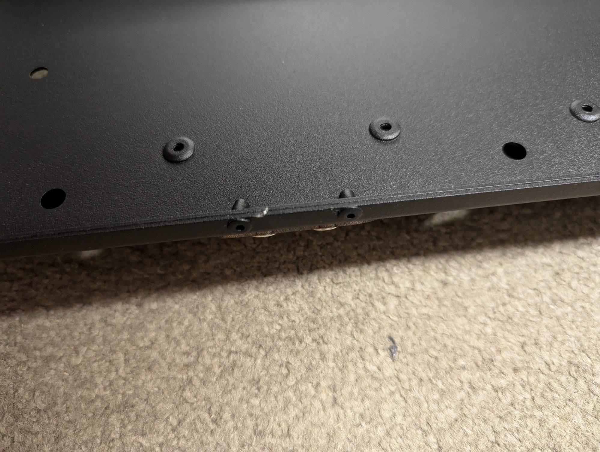

Part 2 - design. This is how the rivets look like on the bottom; you will never see them once the table is assembled, and that seam doesn't carry much structural load so it's just a telltale sign of cutting corners during design for me. You decide for yourself.
Part 3 - The Bloodwork. Unless you take care of this, your crew will keep getting cuts, and not the clean kind.

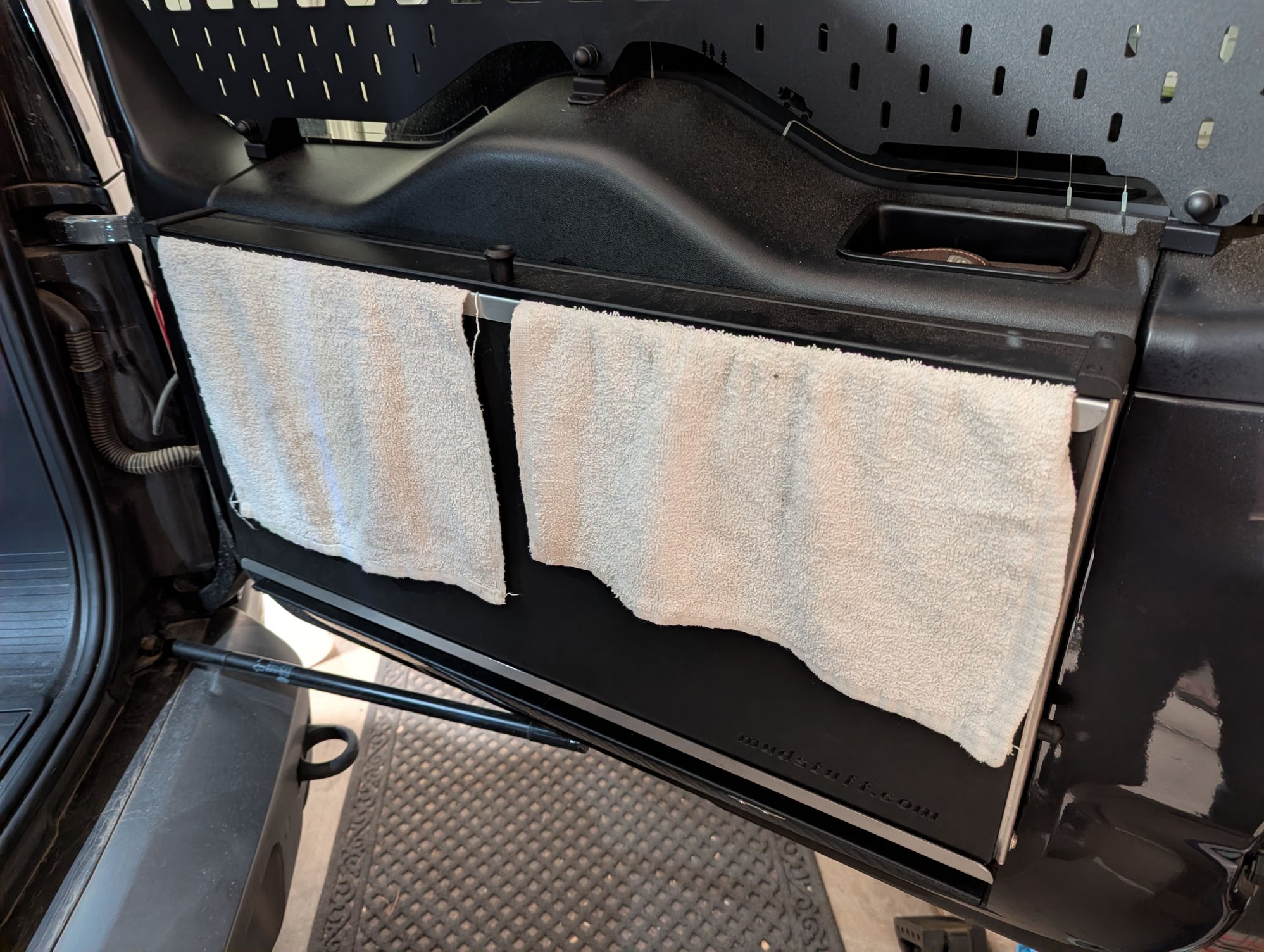

This is a stopgap solution that I use to prevent the table from rattling and sliding sideways. Yeah, I know, I need to get those rubber bumps extended in a high tech sort of a way, but Real Life (TM) gets in the way, so it is what it is.

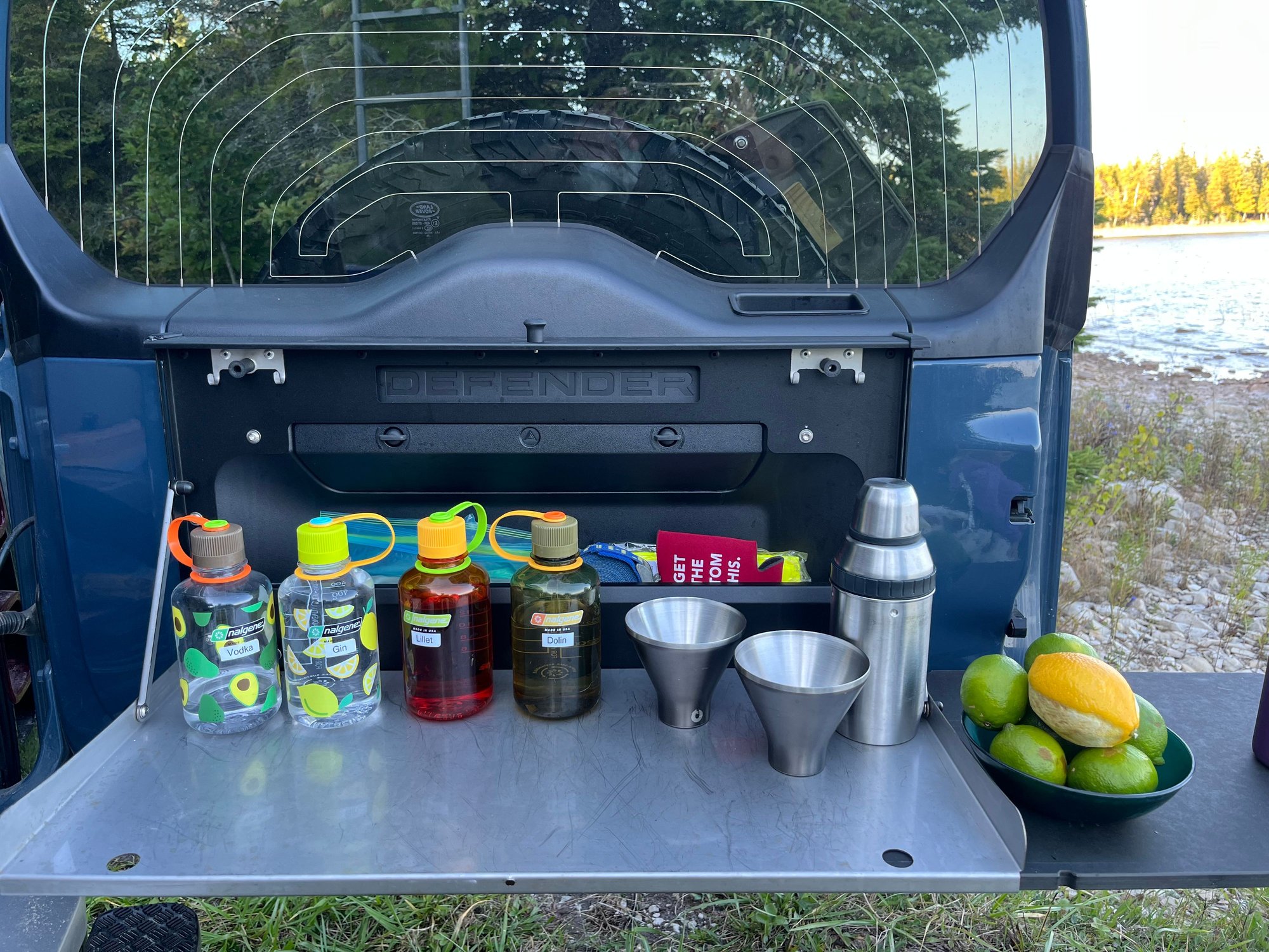

One pro you failed to mention, which is that it doesn't obscure the cubby panel in the door (when folded down, of course). A lot of competitors' offerings cover up the cubby and make it unusable.
And one con you have yet to experience (and the only one I've experienced to date), which is the plastic corner pieces. They seem to be fond of breaking off about halfway. I met another Defender owner at a show this summer and he had the same trouble. He said he wrote to MUD and they sent him replacements, which also broke in the same manner.
You can see the broken plastic corner piece on the left side of mine in this picture. The right side is cracked but hadn't yet fallen off when I took this picture earlier this summer.

Agree, should send yours back. Having to do that with the towels is absolutely ridiculous.
