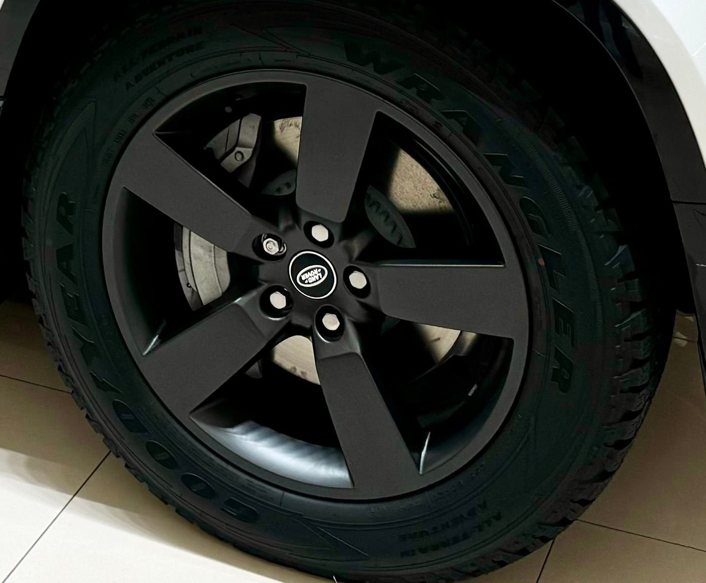

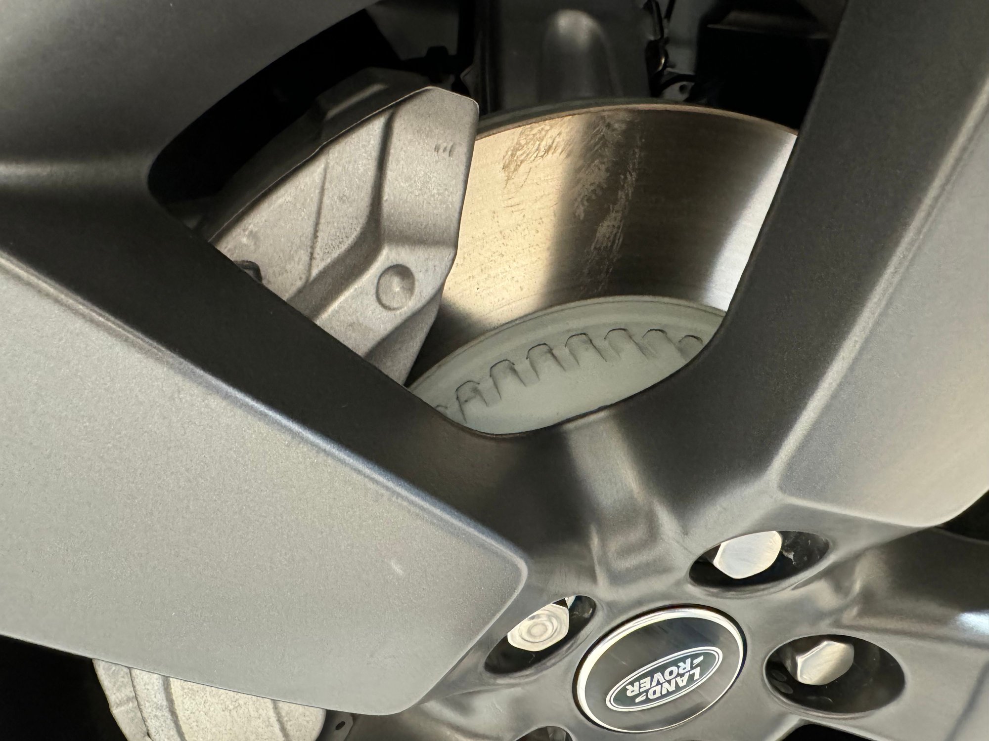

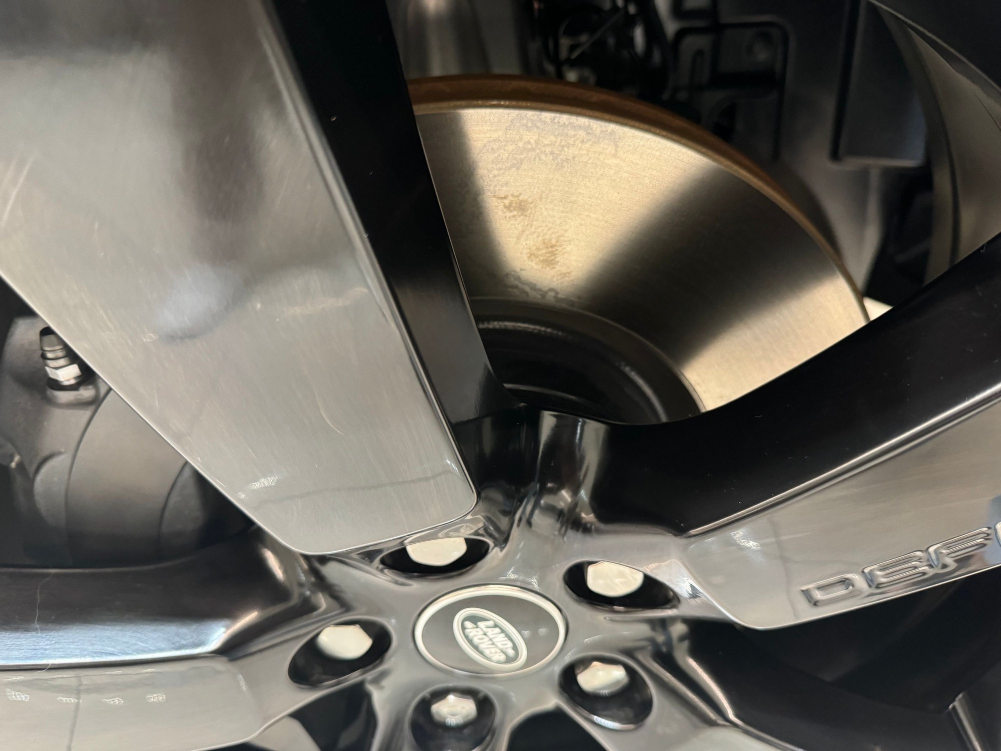

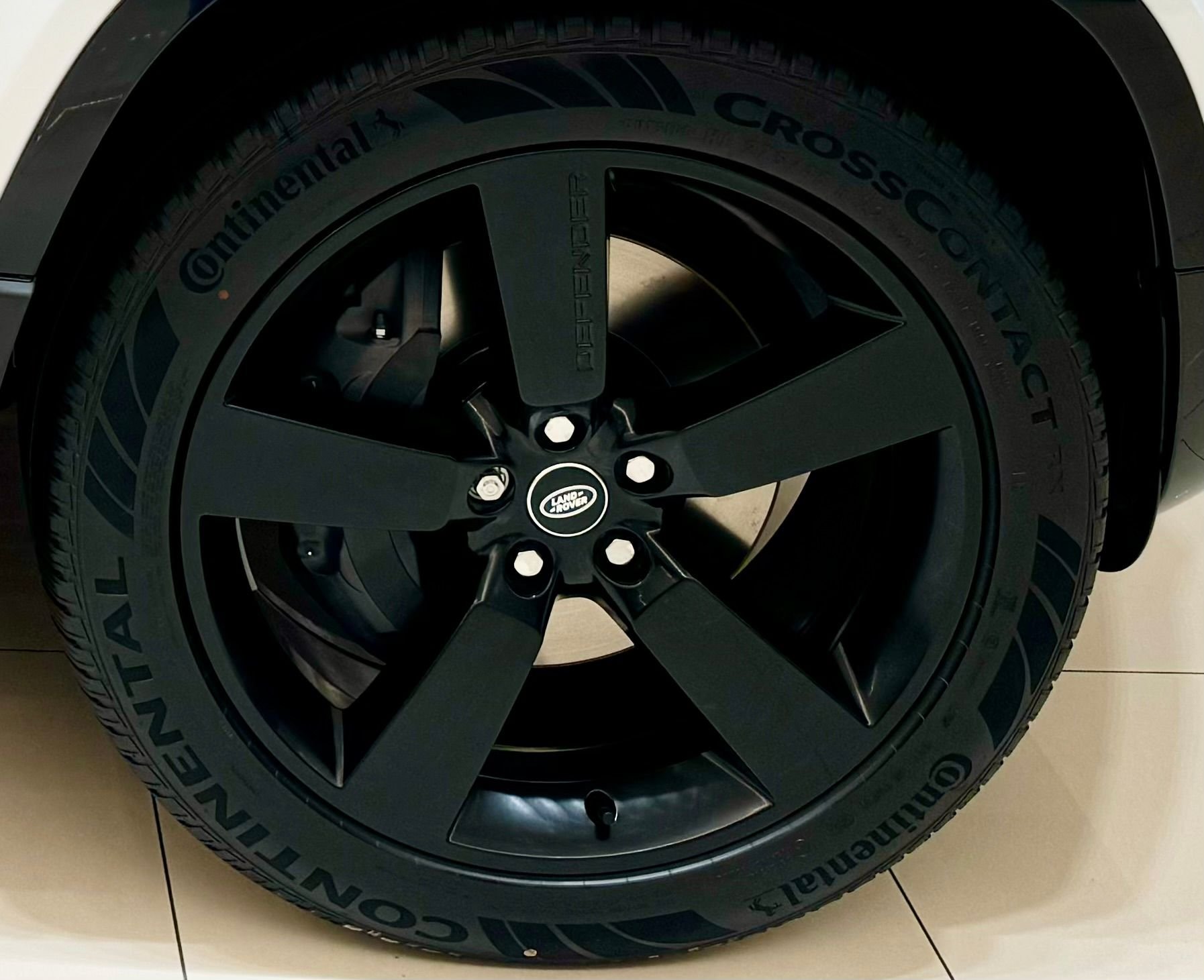

Hello
Am deciding between 20 and 22 wheels
22 are wider with 275 while 20 is 255
I also happened to notice the brake discs and calipers looked different!
Do you also get bigger brakes with 22 ?
Both are HSE with X Dynamic Pack
Please see pictures attached.
Sales person was a bit vague to seeking help here.
Thanks!
22 inch with different looking brake discs and calipers
20 inch with silver calipers and matt silver hub that looks different than 22 inch pictured

The main thing that changes the brakes is the engine as far as I know. Do they have the same engine? The D200, D250 and P300 all have ‘small’ brakes while the more powerful engines have bigger ones. Also, are the both photos on the same side (front/back) of the car? The front brakes are different from the rear.
The wheels don’t (well shouldn’t) have an affect on brake size.

That’s strange. That big silver bit with the ridges is for the ABS, so it doesn’t make sense why the 22’s don’t have it. Are the photos on the literal same side of the car (left right) even though I would think that wouldn’t make a difference. The calipers look to be the same
FYI X-Dynamic is literally just a trim level - in fact there is both SE X-Dynamic and HSE X-Dynamic.

This is pretty strange. Our current Defender (D300, 110) came with 22’s and we swapped to 20’s just fine. The centre bit of the brake disc looks like the photo you sent of the brakes on the car with the 22’s, while our old Defender (P400, 90) which came factory with 20’s looks more like the photo of the 20’s brakes that you sent. The actual shape of the brake caliper appears to be the same, and the size of the disc is the same - the only difference is that big centre thing. Does one of them have like an offroad pack or any differing option? Or is it legitimately just the wheels.

So my understanding is that the brake disc size does change with the wheel size, not the 'spec level'. So if you get the 22inch wheels you get the larger 6-pot front brakes (380mm front, 365mm rear). If you get the 20inch wheels you get the 4-pot front brakes (363mm front and 350mm rear)
However - that's not an 'essential' for wheel sizing as you can still fit the 20inch wheels over the larger 380mm brakes. And can of course put 22 inch wheels when you have the smaller caliper
But - if you have the larger 380mm brakes you can't downsize to a 19inch wheel. Whereas the smaller brakes that come on the 20inch wheel you can step down to a 19inch wheel
Confused? This may not be 100pc true eg I could see that a full X spec (not x dynamic) might anyway have the larger brakes but that doesn't seem to be the case..
The larger brakes actually say 'brembo 6' or something like that on the caliper so should be easy to check which you have
If I were you I would get the 22s if you're not driving off road. There is still plenty of sidewall and they drive very well. No comfort issues in my view
I am downsizing to 20inch wheels (still with the larger 380mm brakes) for my winter tires
