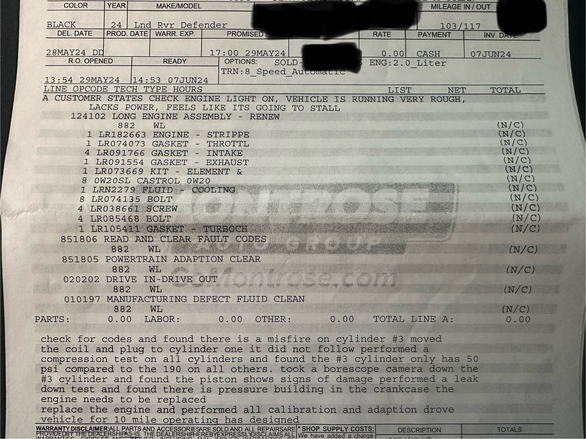

Default The Update
Welp. The defender has been back in my hands for about 2 weeks now and after the replacement, has been working wonderfully. My salesman applied for Joy cash, and I got an unexpected gift from a JLR NA VP the other day. The dealer had me in a weirdly configured 130 X Dynamic for the duration of the replacement (which helped me determine I’m not missing any of the extras i didn’t spec). Overall my dealer went above and beyond and I cannot recommend or sing their praises enough. If anyone wants a LR or Jag, go see them at Landrover Westside in Cleveland.
Now the info people were curious about: it appears cylinder 3 seized for some reason. I don’t have much more than this to go off of but it seems to be a manufacturing fluke as I have yet to see any reports on any forum or social media about this. As you can see it has 103 miles on the ODO. They put about 300 miles on the vehicle before giving it back to confirm it was good to go.

Wow! Two weeks (+) to source, ship & swap a P300. That's impressive!
