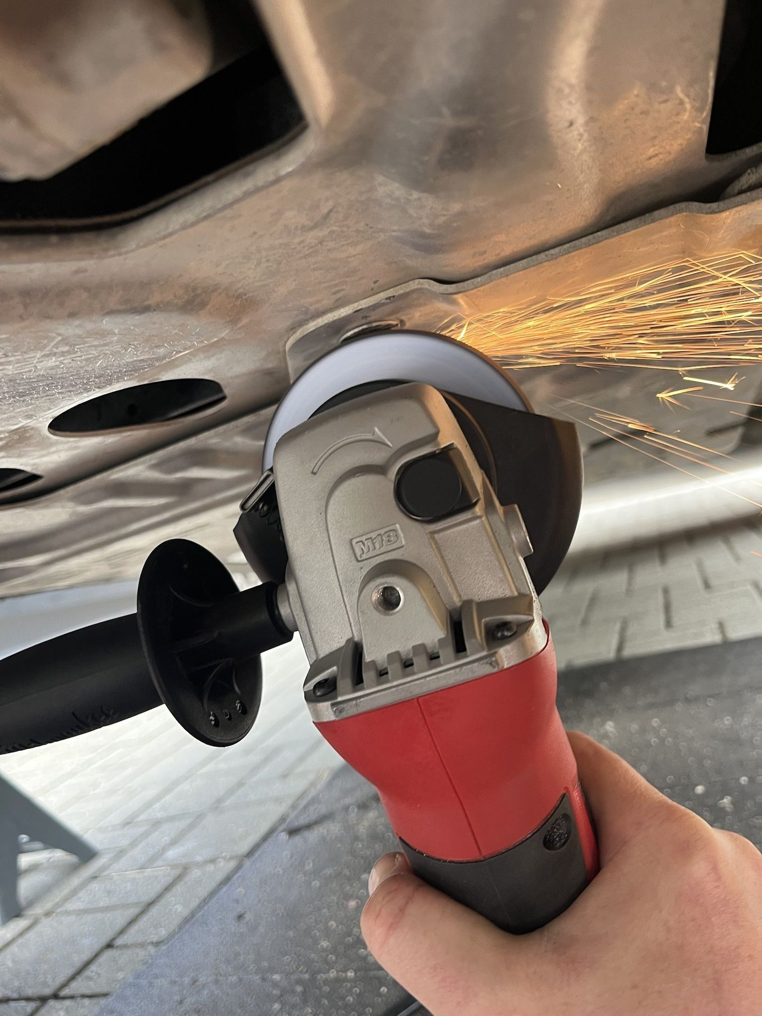

FWIW, I’m old school and prefer doing it the old fashioned way. While there are many proponents of the extraction method, I have read a few issues here of tubes getting stuck, tubes curling upward and not extracting the full volume. Don’t get me wrong, when all goes well the extraction method is quick, easy and less laborious, but the chances of something going awry using the drain method are far less. Plus I like getting under the vehicle, makes it possible to check out a lot more that might be missed. I give everything a good look while under there, looking for leaks, weeps, physical damage, etc. I installed the Fumoto valve and enlarged the access opening so changing the oil via this method is extremely quick and easy. To each his own, though.

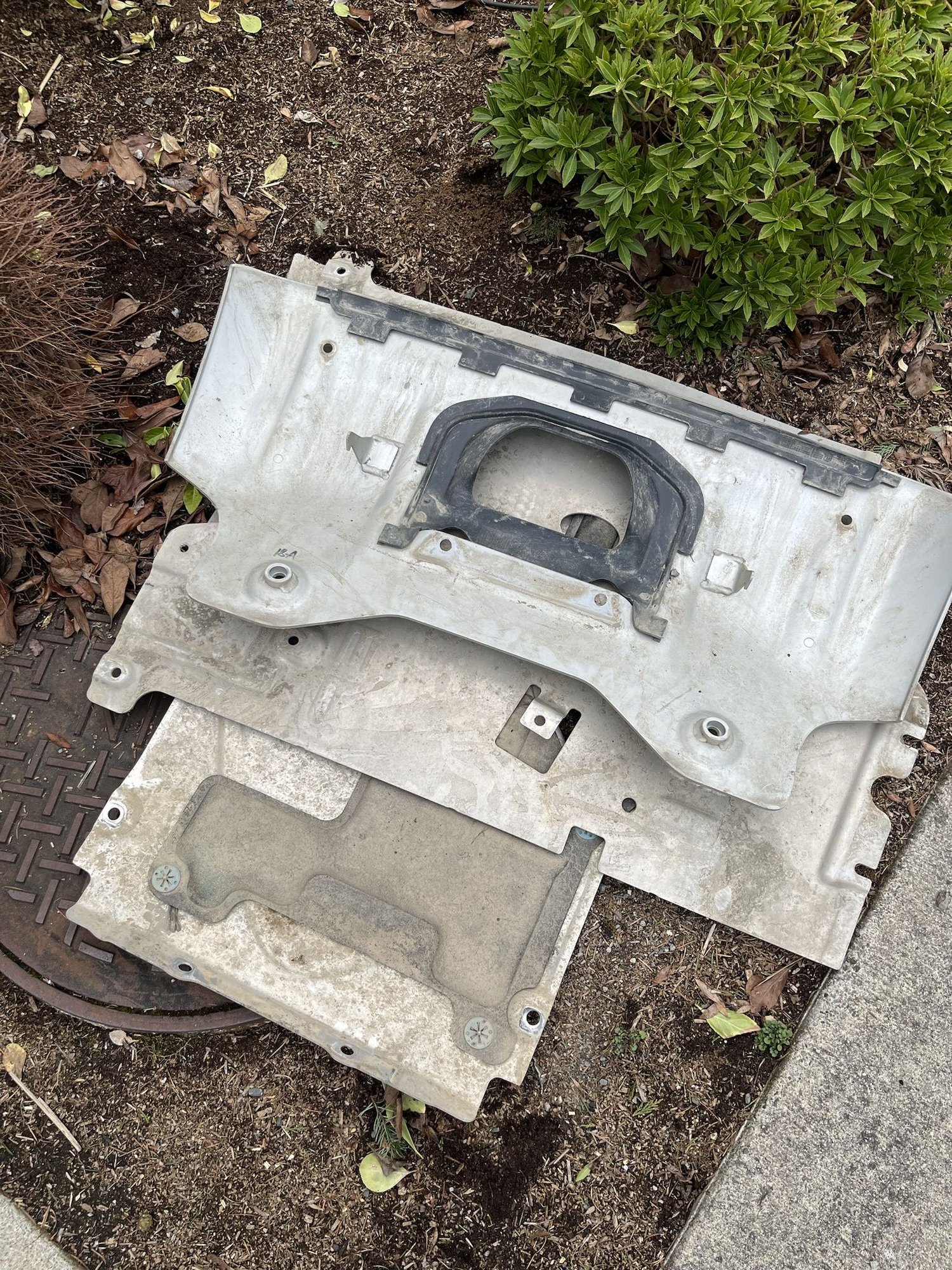

I've taken my under armor off to service my front diff. Total pain in the **** especially if you have the front bash-plate.
With vacuum I can do an oil change in 30 mins. (Getting stuff ready, to all tidied away). It's so simple and neat this way, I could do it wearing white tie and tails.
I salute anyone who feels the need to remove the under-armor to swap out their oil. You're a better person than I. Or possibly a masochist.
Bonus points if you encounter an over tightened/cross threaded bolt down there. Fun.
Bonus points if you encounter an over tightened/cross threaded bolt down there. Fun when the captured nut starts spinning.

Agreed, the under armor is a pain. First time I did it I lost count of how many screws and bolts I took off, but like anything we do mechanically, the first time is always the worst. Now that I know which ones need to come off, where they are located and which size sockets and bits are needed, with a power driver I can have them off in under 10 minutes. Like when doing a brake job. The second wheel takes less than half the time of the first, and each brake job gets quicker.
