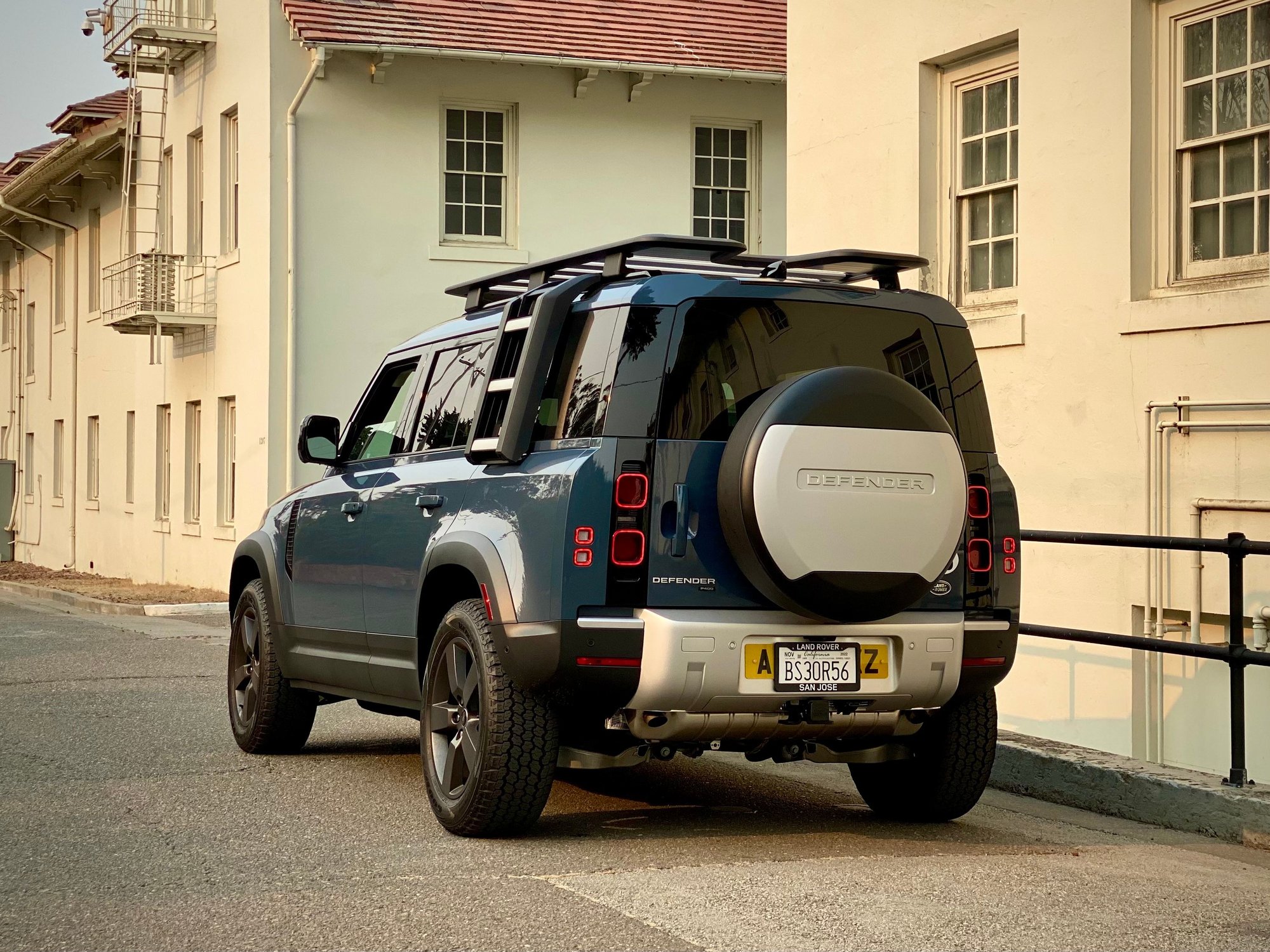

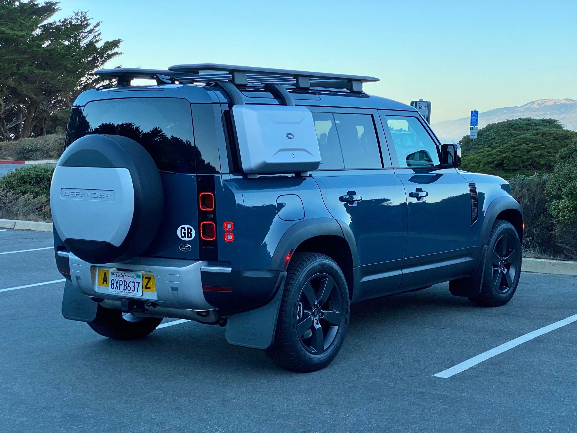

@nashvegas nailed the answers. But I should add a couple other thoughts.
1. I have both and the sunroof functions as designed. However the rack's cross rails are very wide and take up almost half of the view. Worst, the rack makes it very difficult to clean the glass so it's pretty funky up there anyway. I love the rack so if I did it again, I'd just not have ordered the sunroof. In my case I think it came with the trim, but I would have actually preferred not to have had it.
2. Doing the roof or lunch box install is not tough for a DIY. Maybe 2 on a scale of 1-5. Here's the link to Accessory instructions if you want to do a look see: Link. Two things to note. Before I installed things myself I went ahead and bought the little trim piece under the window (~$90/ea). Now I can replace to stock if I ever want to remove them. Also, I didn't know if I would F it up. I didn't and really didn't need to. Next up the two sides have different spacing of the two rivnuts. I think that the lunchbox and ladder have different spacing requirements. I'm not totally sure, but I'm reasonably confident. If I'm correct, you will need to install a rivnut on one side. PowerfulUk has a video on installing external molle plates that go over installing a rivnut. The 2 on the scale is in case you need to do this. Otherwise it's a 1. I vaguely remember that one side (forget which) has all three rivnuts already (for either the lunchbox or the ladder), but the other has only two. Depending on which way you want to go you would need to install it. You should watch the PowerfulUK Molle video as he covers it there. Here's the video:
Good luck however you mod your Defender to meet your uses! You'll love it.

the side bag just seems a little useless and trying to hard. Short of some fish, muddy sneakers, or roadkill I'm not sure what I would put in it that couldn't get tossed in back.
I would use the ladder a lot and felt like it's less to be hanging off the side. This is going to be my DD for 5 out of 7 days.
But you may have just sold me on leaving the bag and adding the ladder!!
beautiful photos! Thanks!
P.S. sincerely interested in your use case for the lunch box?
