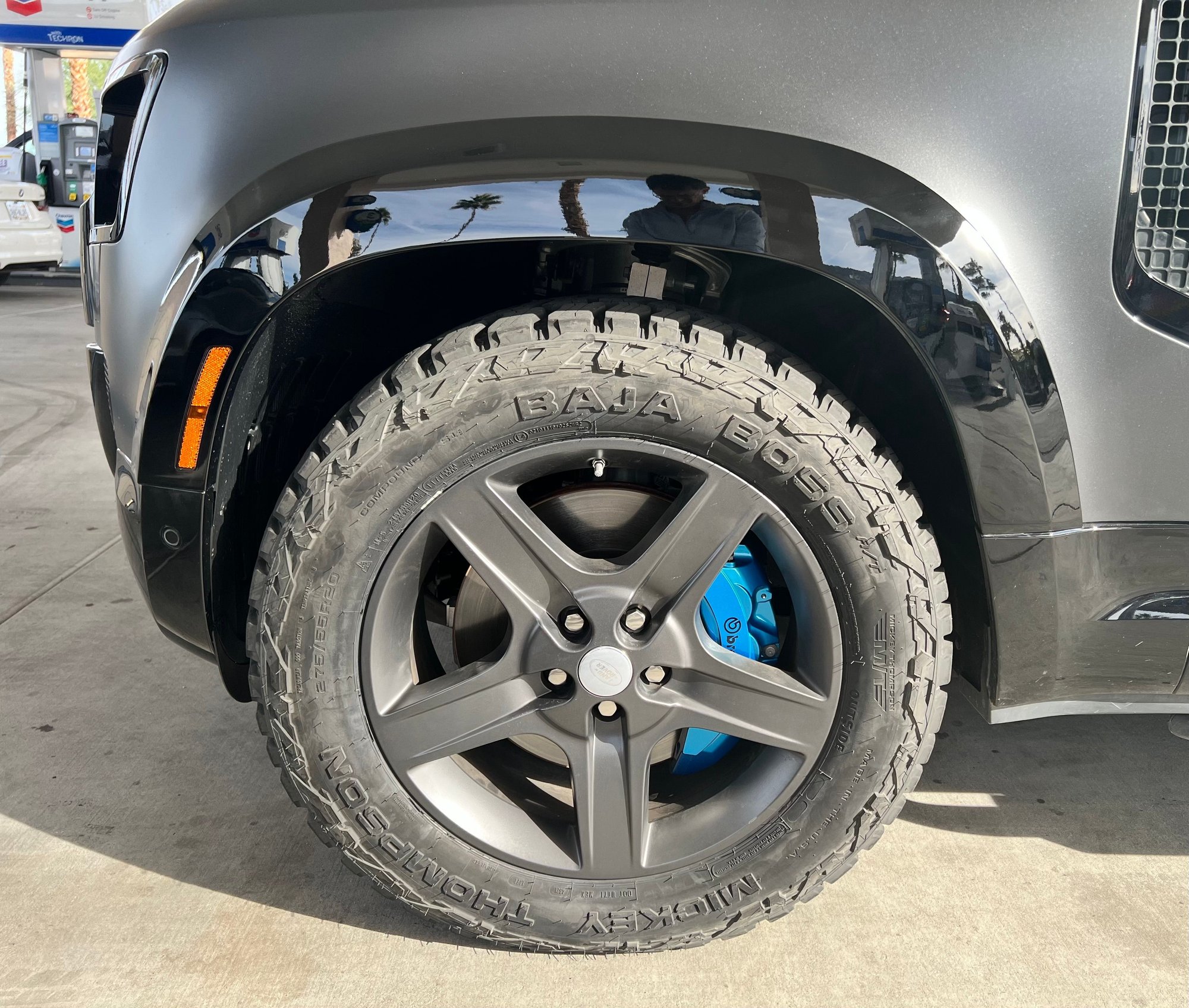

Mickey Thompson Baja Boss 275/55R20 on a 2023.5 V8. No noted rubbing or other issues. I just took these to Joshua Tree this weekend, up Berdoo trail starting at the south end and coming out of the western entrance of the park. They handle great off road and on road. Plenty of grip on rocks and control on deep sand. In fact, I was slightly surprised at how well they handle in both highway and offroad conditions and while they are slightly noisier than the standard Continental tires on the freeway, they are not horrible. Since I mounted the MT's on a second set of rims which get put on the car only when specifically intending to go offroading, the noise is not an issue for me for the few days at a time when they are on. But they would not be hard to live with running them full time.

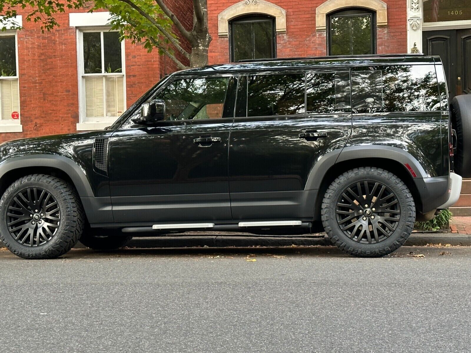

Default 20" tires no lift
You can run 275 55 20 no lift no rubbing
here are a few pics
275 55 20 nitto ridge grapplers no lift , no rub, no spacers needed

I have the impression that in terms of sidewall running this set up is almost the same as running ATs on the 22 Wheels (275-45-22) as I sometimes see folks doing. Am I wrong?

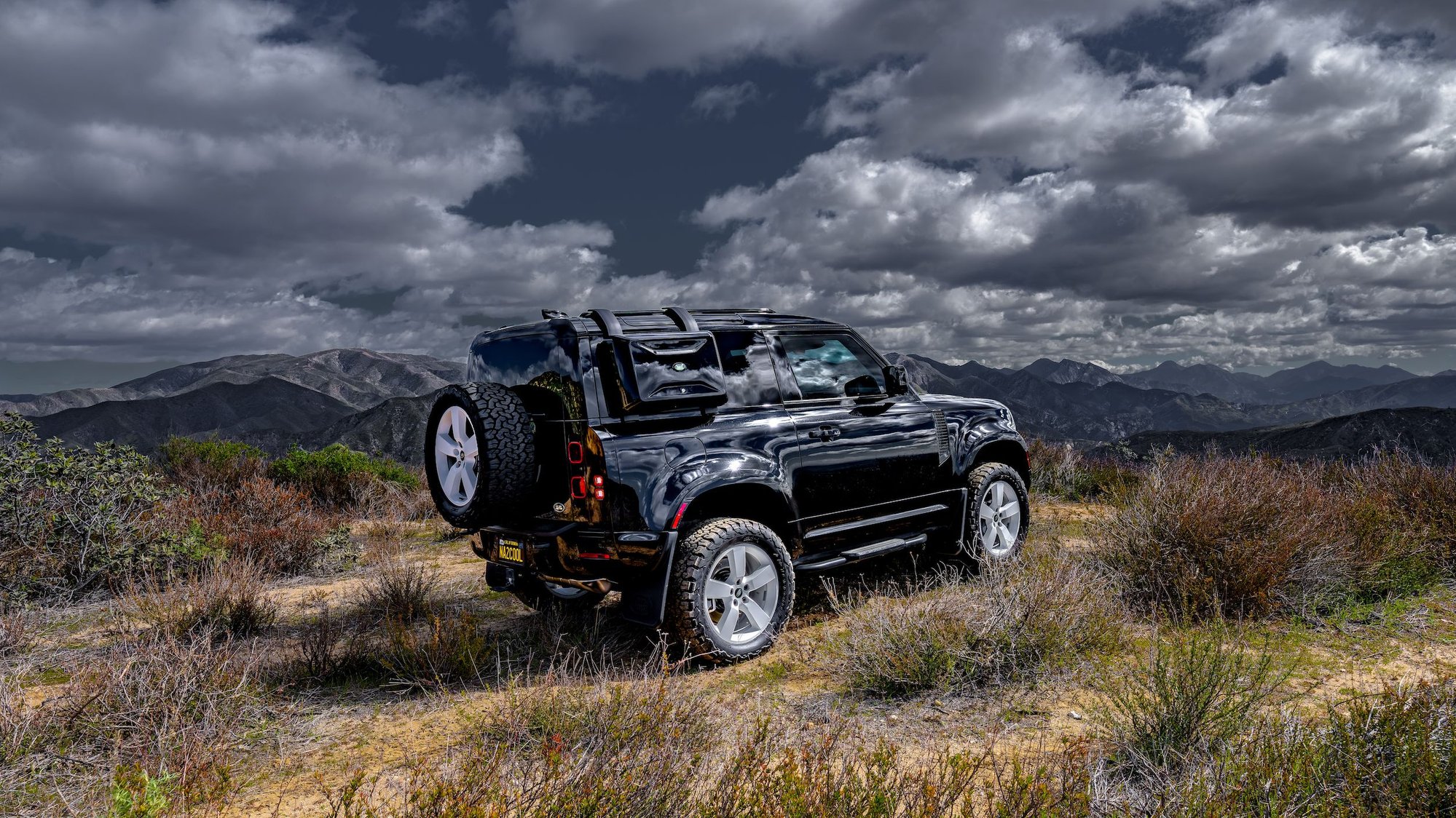

305/50/20 BFG no lift no rub..

Nice! The dealer told me 305 was the biggest you could go! What are those lights on the front?

Lazer elite 9"
