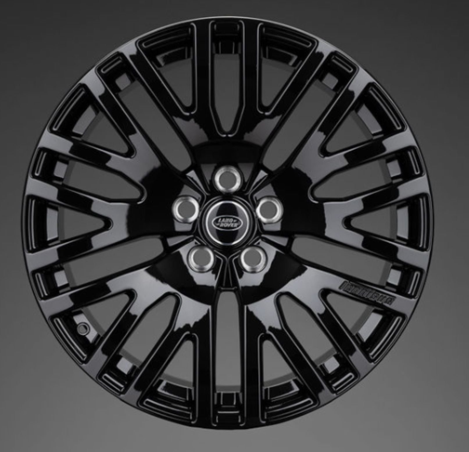

Looks great!
I like the 20s too.
I had pretty much written off the idea of being even able to drop down to the 18s till I saw some P400s running 18s .
I was planning, or leaning towards going with some rims like this.
These are a 20x9.5 +25 offset
Been researching here on the forum rather the 285/55R20 or 275/55R20 would be best on a 100% stock suspension without rubbing and without any trimming.
‘I like the 285 width the best.
I see you went 305s how is the fit on your setup?
What offset are you running?

Damn I wouldn't want to clean those rims. Stock wheels with a 30mm spacer on the rears only..zero rub

‘To drop down from the stock 22s I have to buy rims anyway, no plans of buying spacers too.
I am ok with the stock 32” tire height I just want optimal flush stance , and more of an AT tire with in a more common size and more sidewall then the stocks 22”s would ever allow.
I defiantly don’t like any poke, not only because it through dirt, mud, and rocks at my car, it also throws stuff at others.
Best I can tell so far is my OEM Rims are 22x9 with a +43 offset.
The + 25 offset in a 20x9.5 should push my tire right at 1” which I am concerned is going to creat some poke?
+43 - +25 is difference of 18mm which translates to 0.71 inches plus the 0.25” the added .5 inch width gain causes,
Total added stance 0.96” per wheel
. Basically adds about 2”s of track width,
