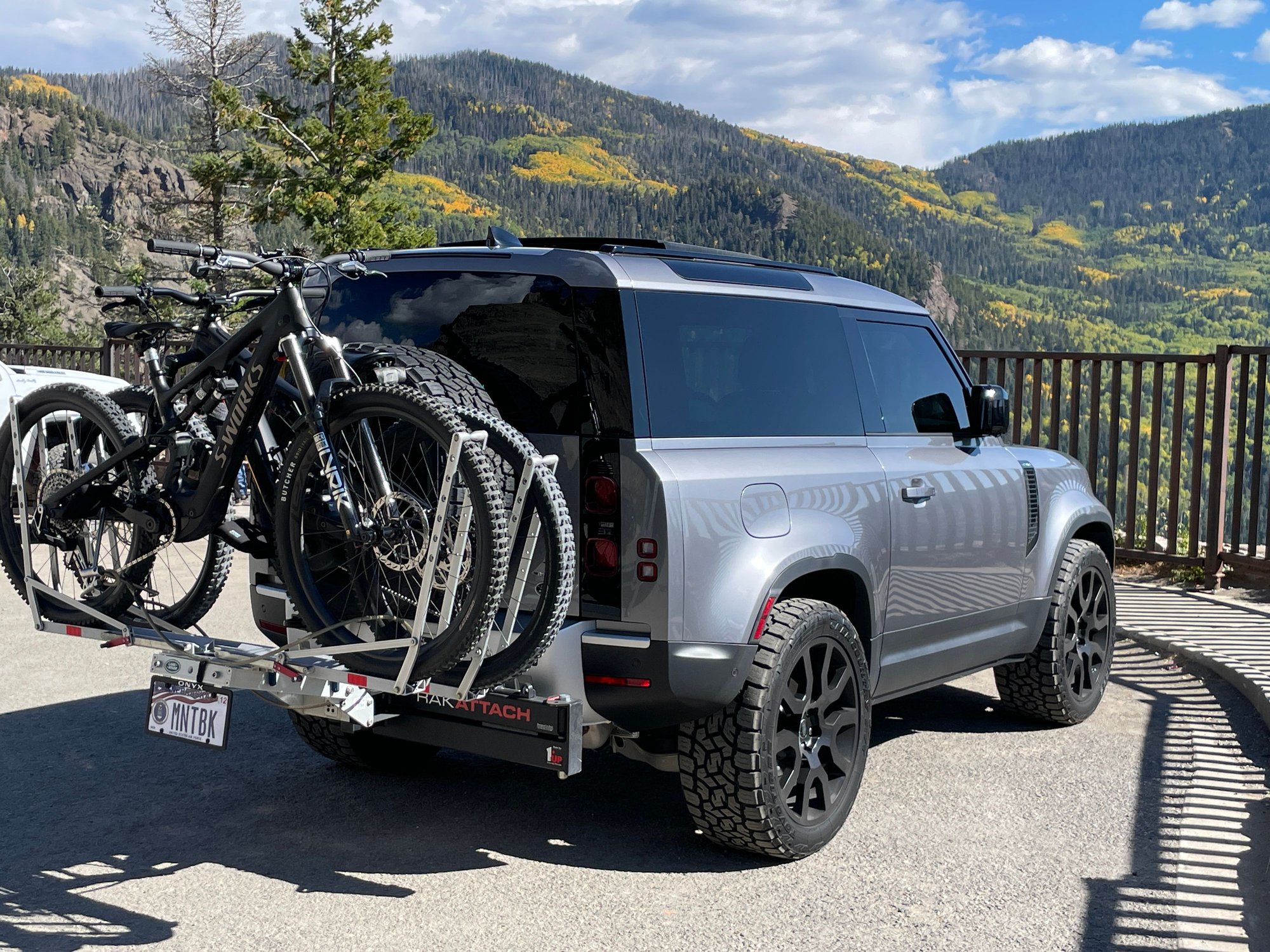

Hey, thats a picture of my car. I have 285/45/22 on there now with spacers ( I think they are 30mm). There is a slight rub on some of the vent fins on the lower part of the wheel well, i cut them off and it was fine. The 25mm spacer woudln't fit w/o triming the lug nut and I wasn't wanting to do that.
Moved the intercooler and about to put 35s. Yes, it's ridiculous but i can and will. I take my car on dirt/gravel roads, farmland, fields, big bend national park and mess around al the time. Works for me. I don't do real rock climbing but i got rock sliders and a winch anyways! you do you....

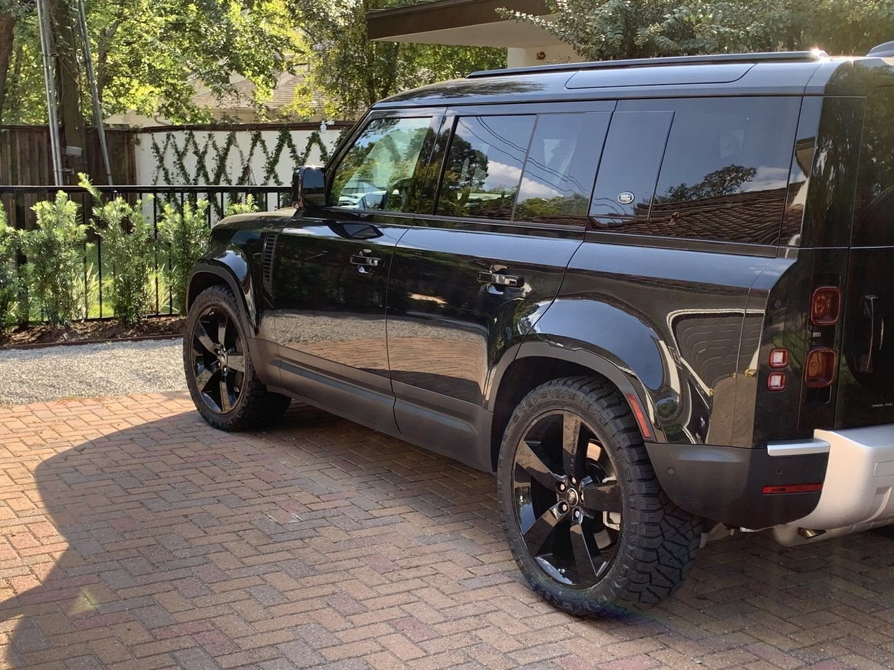

My last Defender was a 2020 which I put 20" Redbourne wheels on with 33x12.5 Yokohama tires. For those that have been here for a long time or poked around on older threads, you may have run across the pictures of it in multiple threads. Here is a quick look:
My new Defender is a 2023 90. I couldn't find the 20" wheels any longer, so I went with 22" wheels this time and added Toyo 33x12.5 tires. Looks about the same, but I actually like the stance of the 22" wheels as the offset pushes them out just a bit more than the 20" wheels on my last Defender:

Both had 1.5" lift rods installed and it will rub in access height but not in any other selected height.
