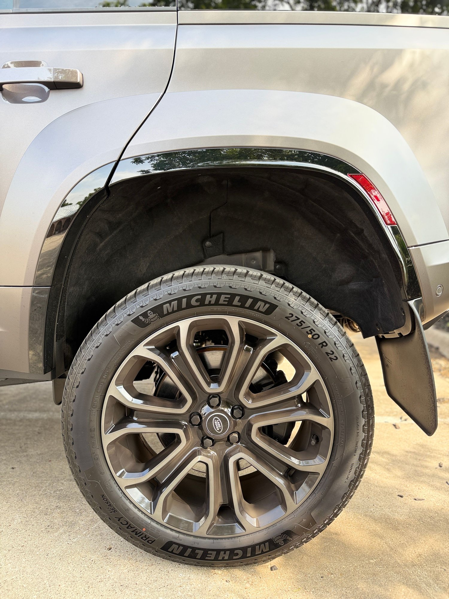

Hello Tex130V8 - sorry for off subject question - how do you like the Michelin tires on your Octa? Are they quiet? I haven't seen the Michelin Primacy tires before. Thanks - BTW, Beautiful Octa and I also love the wheels! I just picked up a Sedona Red Edition a few weeks ago and it is being ceramic coated now as well.

I love the tires. I felt like the contis wore out quickly (though evenly) on our sv and 110v8, so I’m hoping Michelins last a bit longer. In fairness, we drive the **** out of these things so maybe it’s just us pushing tires to the limits. Ride seems improved over the v8 no doubt. Assuming that’s mostly 6D suspension.
