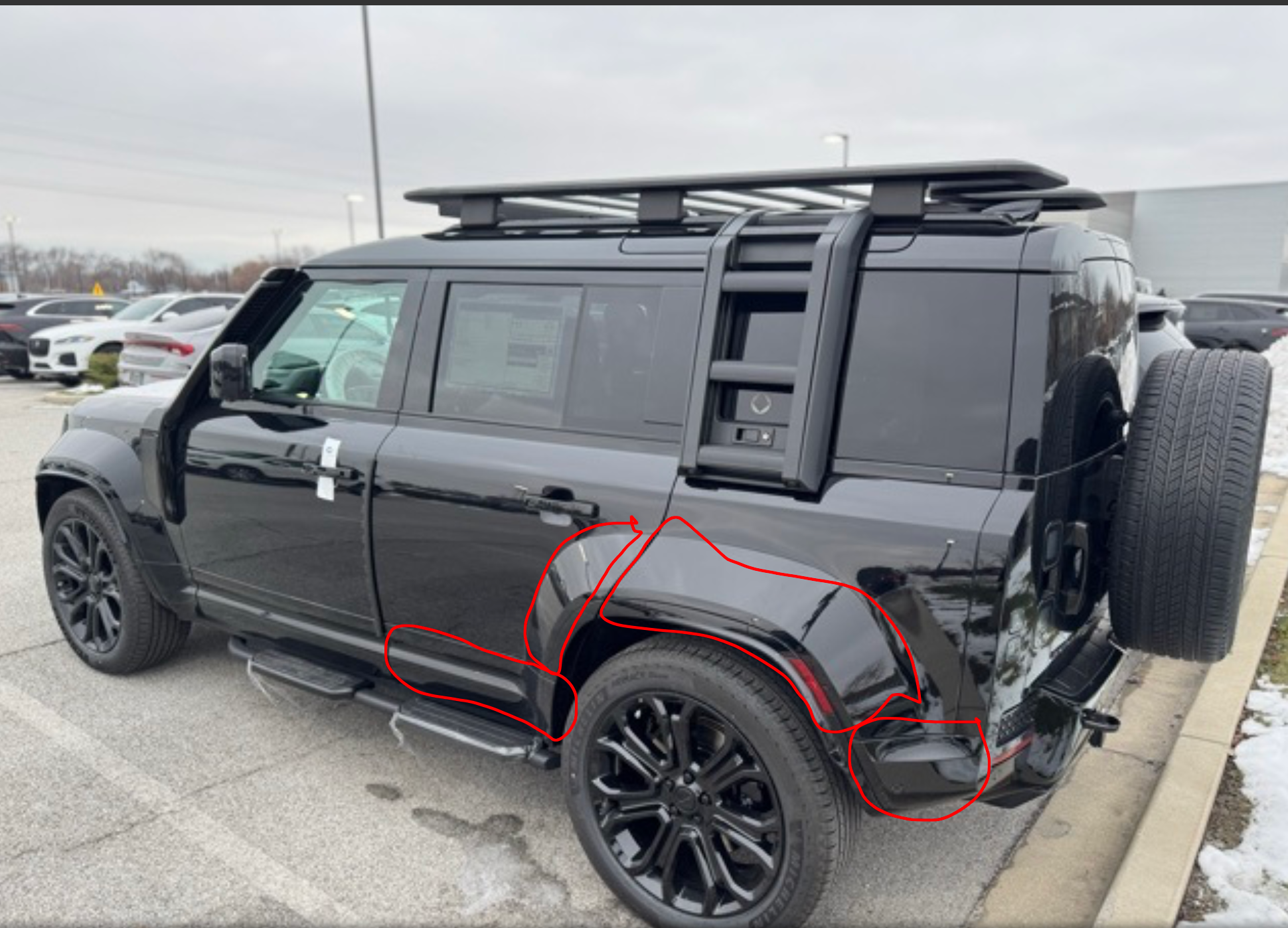

Reviving this thread, if you could get parts I believe it could be done. The rear is just arches that are attached to the rear fender and door. As well as a transition piece for the rear bumper. The fronts, if you really want to be sure, you could just get the full fender along with the flare, as well as the front bumper transition piece. Lower side trim panels would be easy as well. And the fender liners. You technically would not need to change out the front center bumper and grill (unless you are going for the octa look there as well). Obviously if you do the arches, you will need to solve the wheel spacing through custom wheels and offsets as it's not likely to swap every suspension piece over from the Octa for the additional track width.
Does anyone have access to a parts ETK to try to get part numbers (I know it may require an Octa Vin)
