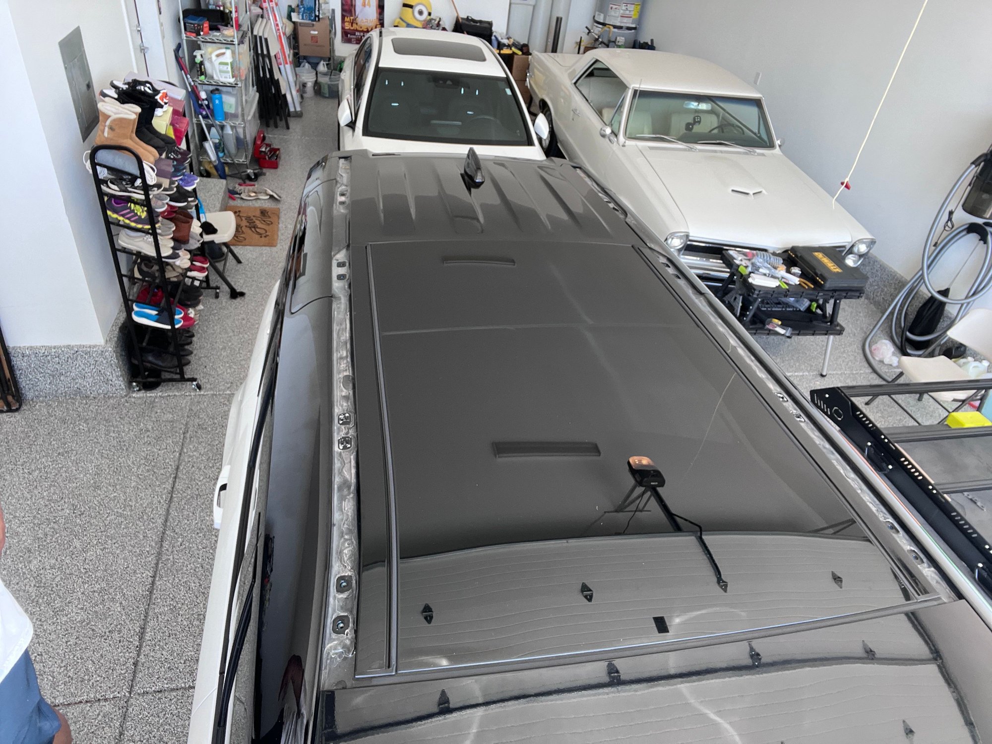

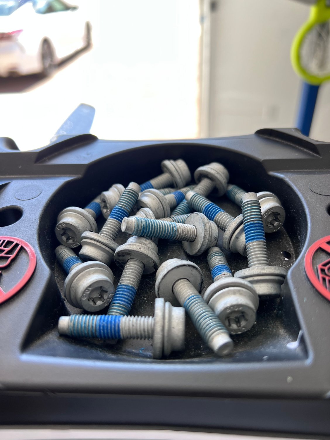

Removed the roof rail bolts today. Patience and heat seemed to do the job. You could tell the front 4 bolts were much harder to remove.

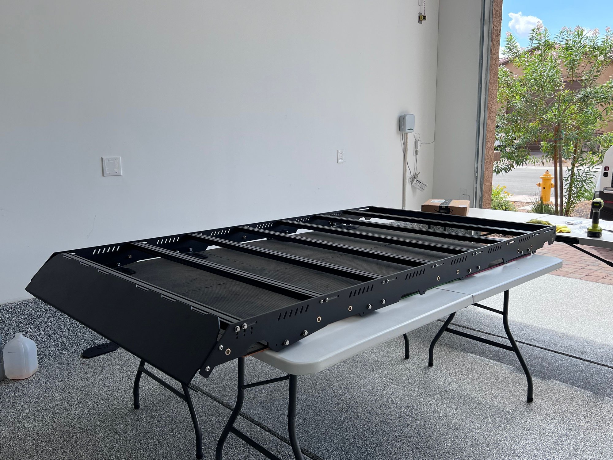

Here’s the finished project. I’m really pleased with how it turned out.

Just installed my front runner rack. I was all prepared for the bolts to have lots of loctite and need some heat to loosen them. To my surprise all the bolts came out with not a single drop of loctite on them. Guess I will be sending back that induction bolt heater. I have a 2021 P400 SE.
Guess I got lucky

You should reinstall them with loctite (blue only) if you want your rack to be secure.

Yep already did that
