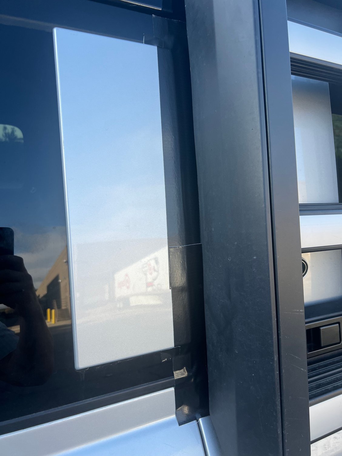

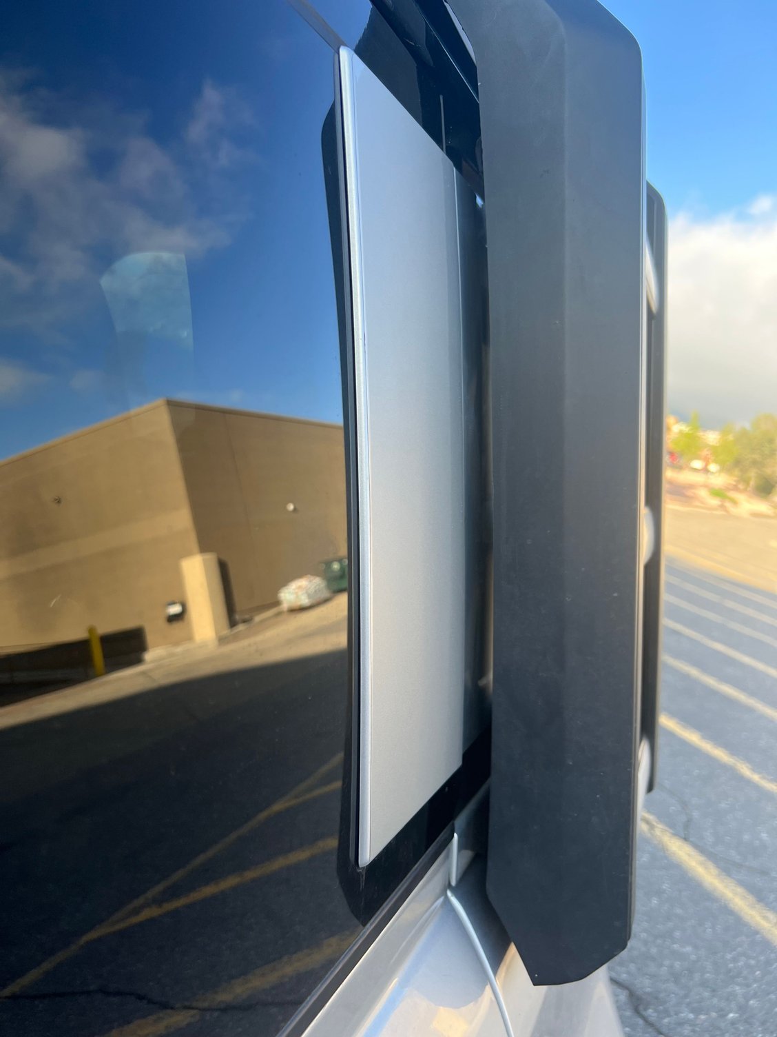

Sort of.
I've done a ton of tests and the best solution is taping the window area between the back driver side door and the rear back window which removes the whistle. If you notice in the picture the grey plate sticks out on the bottom and does not sit 100% flush. It's pretty solid when I press on it but if I open the door and pull out it moves ever so slightly. This might explain why I only hear it at higher speeds.
Long story short, I am thinking it might be the same problem that you mentioned with that fixed panel. I have an extended warranty so hopefully this is covered.
