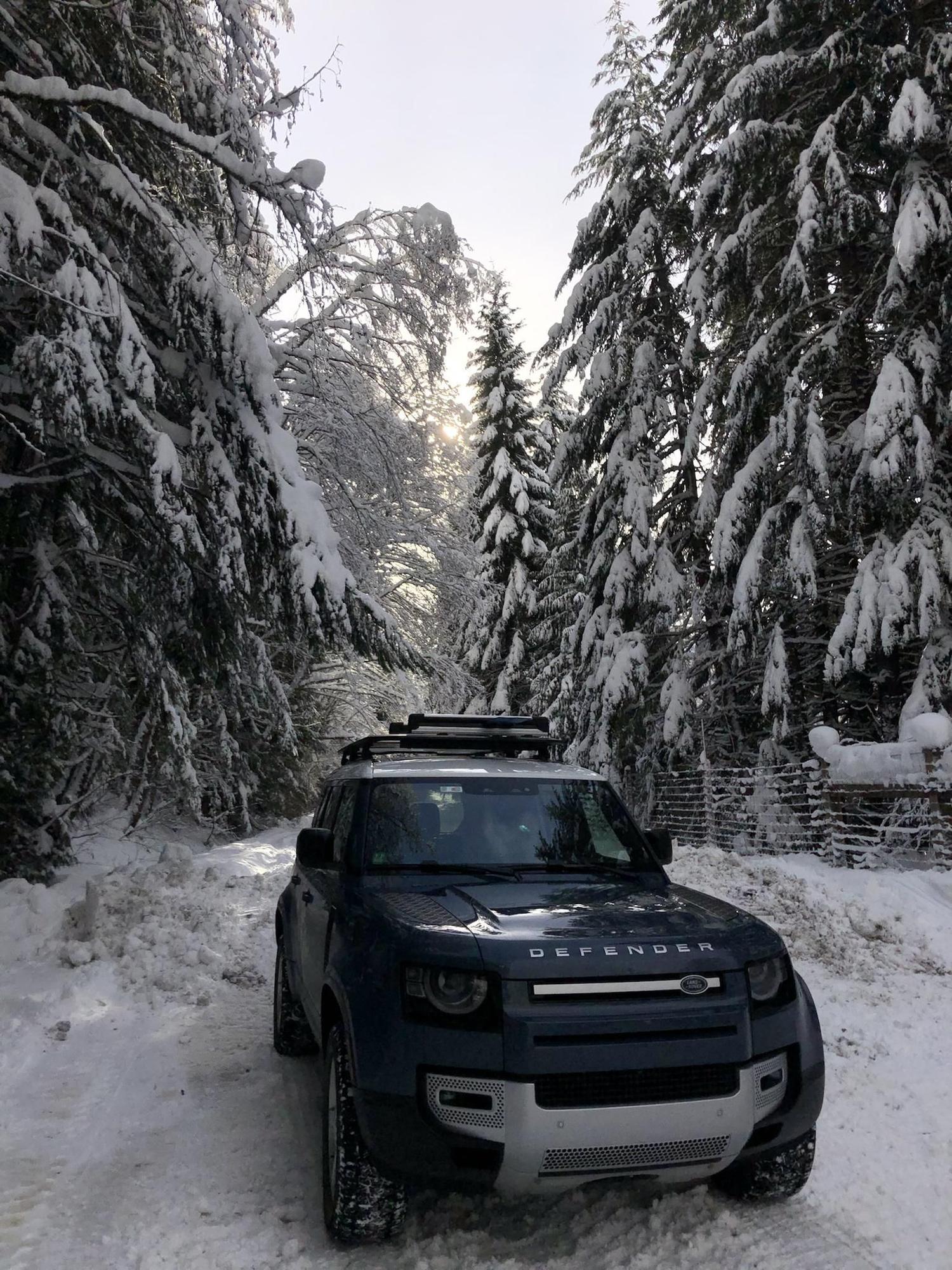

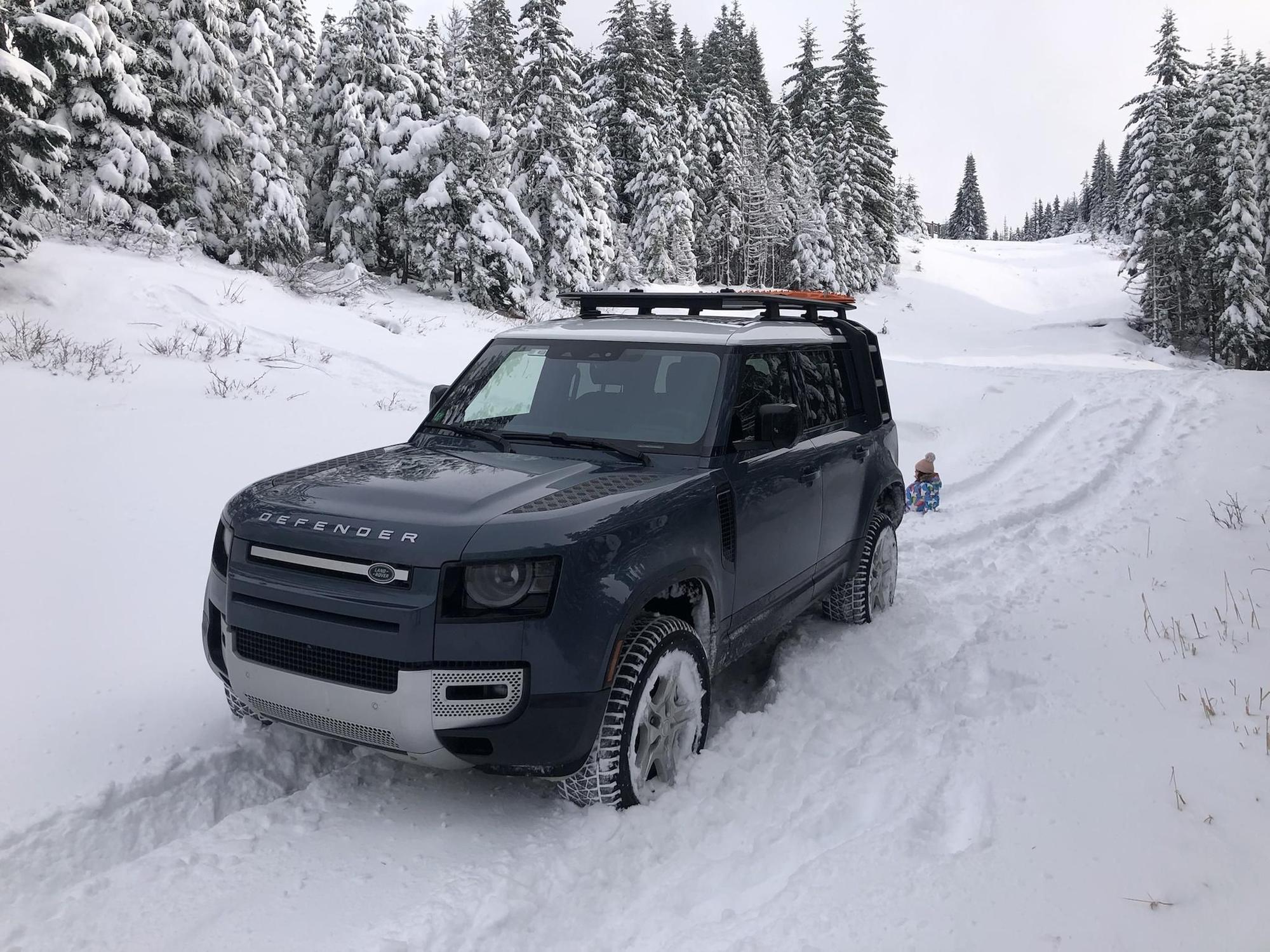

I had an eye opener with the Goodyears in the snow shortly after I got the Defender.
(I always intended getting winter boots as I've used them the last few years in WA on my last car and would never go back to not using winter tires. )
Coming to a stop in the packed snow from a gentle 15mph on a relatively flat forest track and it just slid and slid. I couldn't believe it. Not even that hard a pack. Nothing near me thankfully but had it happened in traffic on a mountain pass it would have been a very bad day indeed. The Wrangler Adventures, even with all of JLR's tech were completely at the mercy of my momentum.
The Defender is a big heavy vehicle. The OEM A/T tire is not something I trust to provide adequate stopping in the snow. They'll get you going just fine but stopping is a different beast.
With the Blizzaks, Lo range and ATPC engaged, the control on the descent down snowy tracks has been fantastic. A real Wow! experience.
Probably someone with more skill and experience could mange better with the stock tires than I.

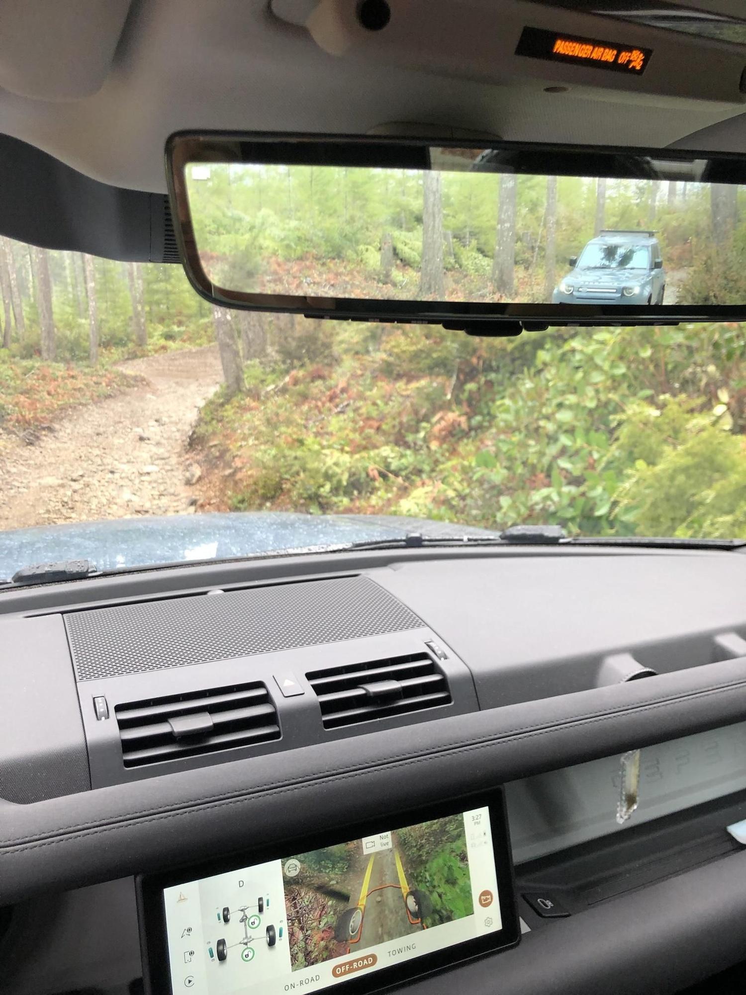

I have them in the 20" and you really can't air them down. Even at higher pressures, going over rocks and roots, the rim is almost pinching the tire. The few times I've tackled more rocky stuff it's been a jittery experience seeing that sort of thing. They are a light weight tire ill-suited to what the Defender is designed for but very good for 99% of what owners will tackle, have a low rolling resistance and long tread life.
Fortunately the off-road camera system is great so you can tip toe about rocky/rooty terrain but for the most part, so much fun terrain is off-limits with this 20" wheel/tire setup.
