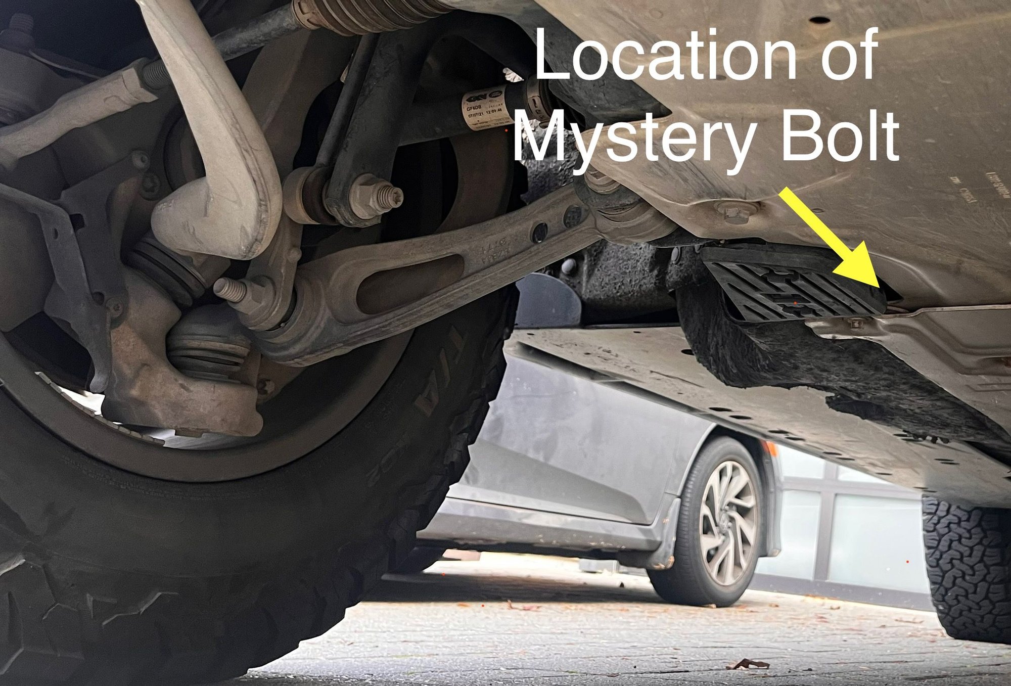

During a quick inspection of the underside today (prepping for a transmission service ) I noticed a bolt dangling from between the jack point and armor
I was puzzled and after some internet crowd sourcing, it appears that this is one of 13 exhaust manifold bolts
As expected, this is a fiendishly difficult bolt to get to and replace
I’m not sure if it’s sheared off or unscrewed or both
Getting it replaced is not going to be fun
A dirt cheap part positioned deep in the belly of the beast
This will not be an easy job
I fear it’s something that needs to be fixed if more serious problems are to be avoided.
currently there are no associated symptoms or problems.

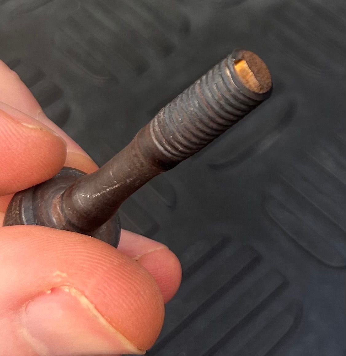

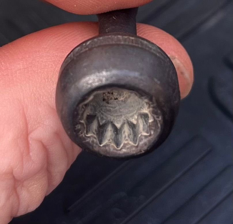

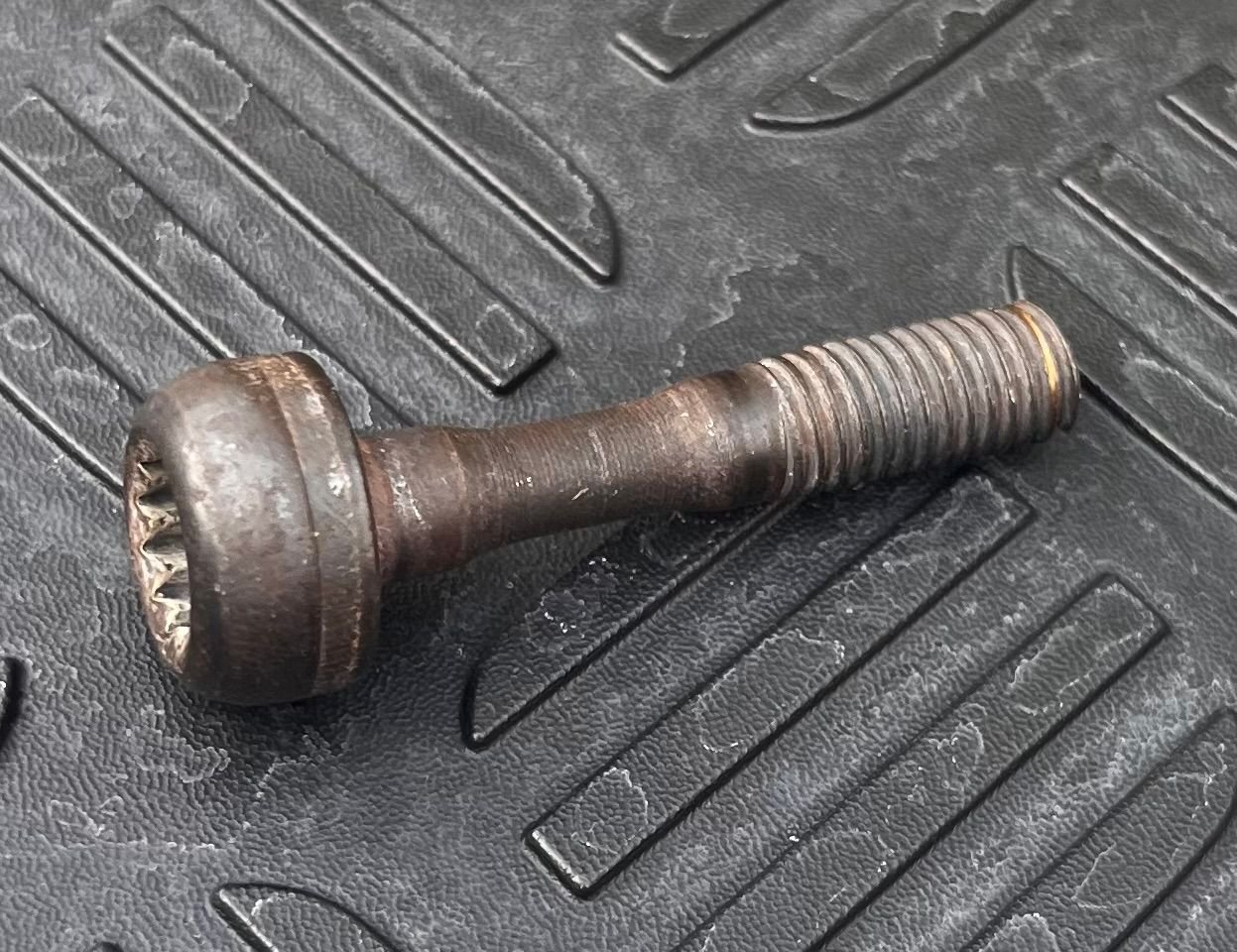

This is what the part looks like.
LR125335
