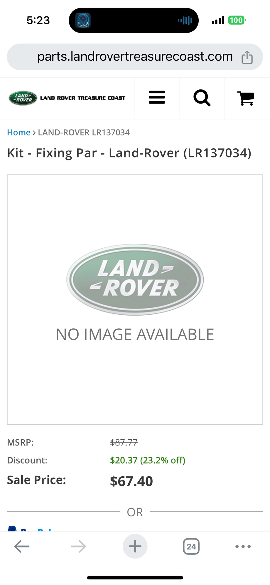

LR makes a repair kit for $67. I ordered m-Attachment screws for $7 on eBay. I’m gonna drill through the plastic and reattach to the frame with the screws.
It may be hard to get to the rear screw due to the spring mounting lug. But we’ll see I ordered the kit as well

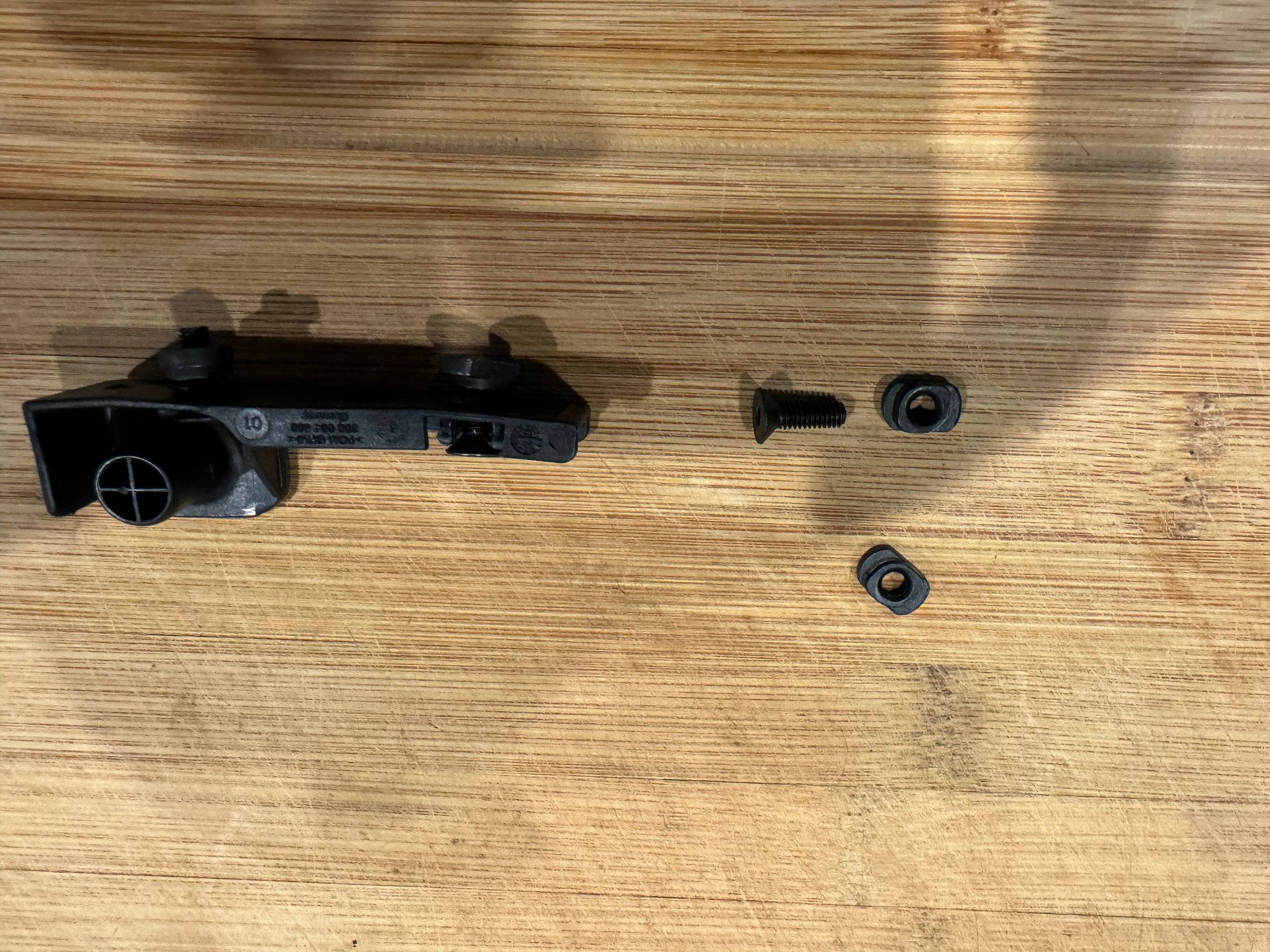

I fixed the broken plastic piece even though I ordered replacement. The m-lok screws came in today. I used a
-5/32 drill bit to make holes In the plastic where the 2 tabs broke off
-placed a screw In each hole and attached the fastener(nut) to the bottom
-reattached the plastic to the spring and lined the fastener(nuts) to fit through the slots
-used a 2.5mm hex key to tighten the screws ( longer is better)
the rear screw took some finagling but I was able to tighten it from an angle.

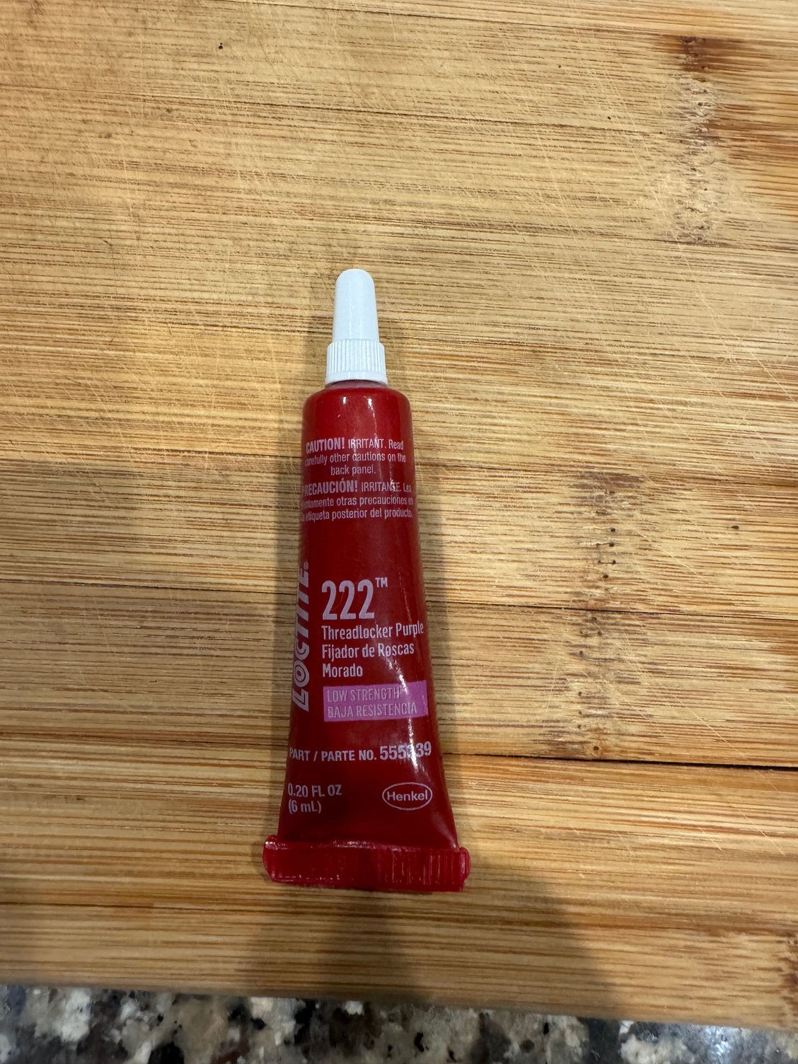

I applied loctite 222 purple light duty thread locker to prevent them from vibrating loose.

All in all took about 20 mins. May not be worth it to some since the replacement kit is only $67. But the screws were $7. I may still install the new piece when it arrives at the dealer. We shall see

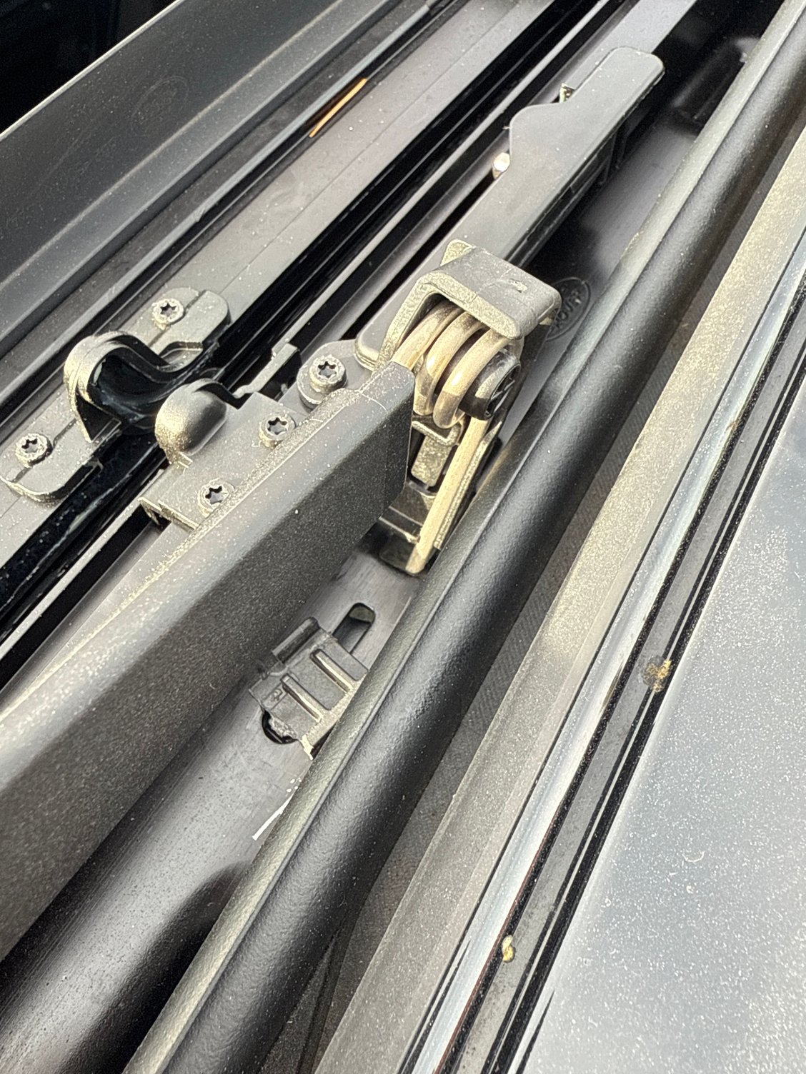

I parked the defender and left the roof open, when I went to close it it only closed 3/4 of the way as if something was obstructing it. I climbed up and found a plastic piece that hold the spring to the wind deflector had either broken or came off. I had to hold it in place to get the spring to stay out of the way of the roof. which allowed the deflector to be pushed down. So the roof is closed, which is good, but i cant seem to locate the part or a picture of it. I really dont want to drive to the dealer and waste time just to get a part number. Has anyone experienced this? Anyone have a part number? Hoping its not gonna require the entire frame to be replaced that would be stupid. the pictures of the frame dont seem to show the part that broke. I havent looking into it too much I just closed it and went about my day. Ill look more into it over the weekend. but any help would be appreciated.

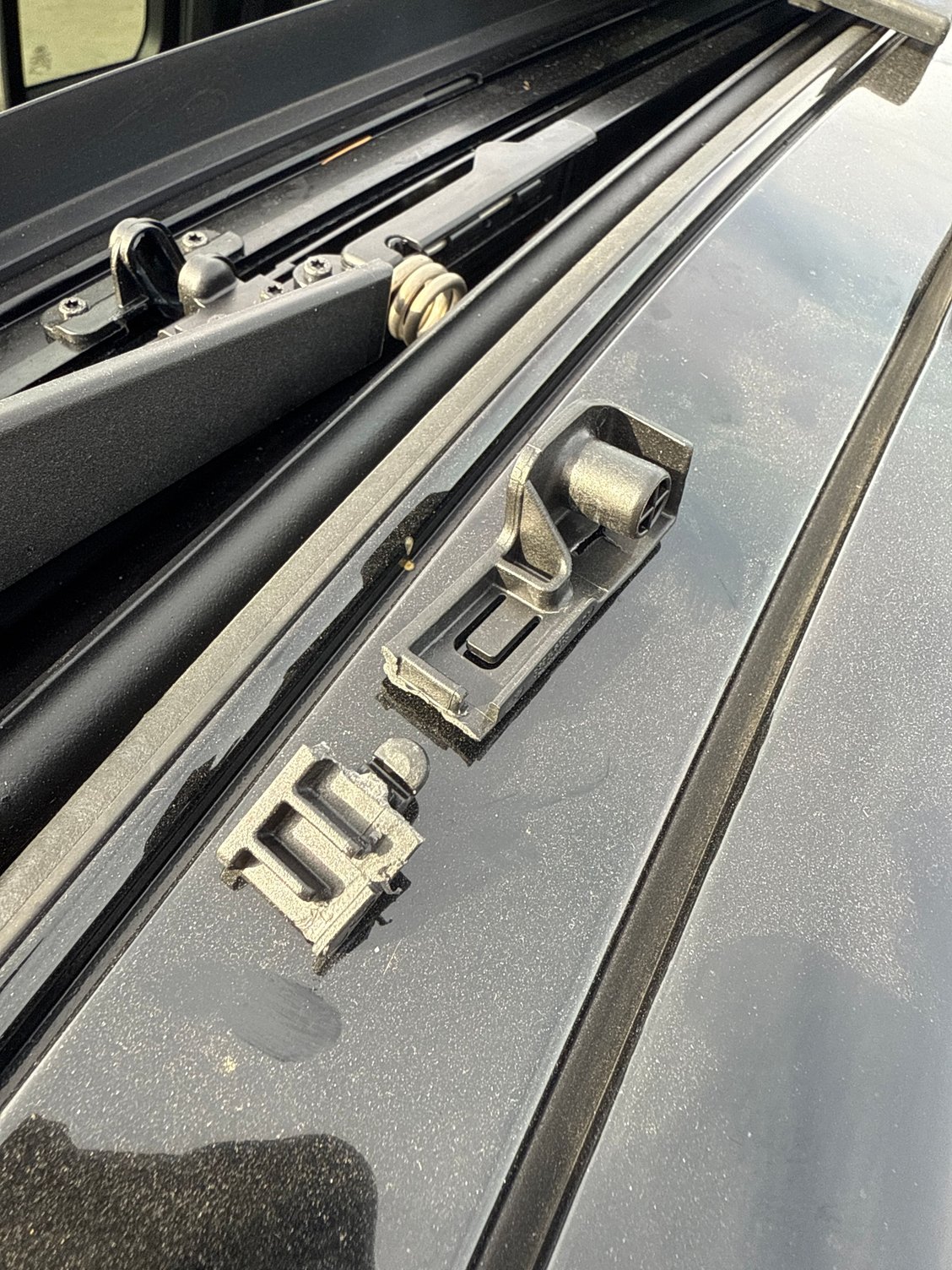

Mine broke also - this is with the spring side still in place (you can see cracked piece in the track)
This is pic of spring clip (cracked) removed from spring and track
Hope this helps!

Happened to me too - replaced under warranty. Exactly same scenario. I suspect that the plastic gets damaged by weather-related heating/cooling and becomes fragile. I don't use the sunroof a lot.

Should we just be buying this LR137034 - install fixing kit - and installing it on older L663’s? I’d rather proactively change it out than wait for this to crack, which seems... inevitable based on what I’m reading in this thread?
