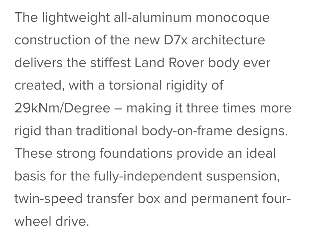

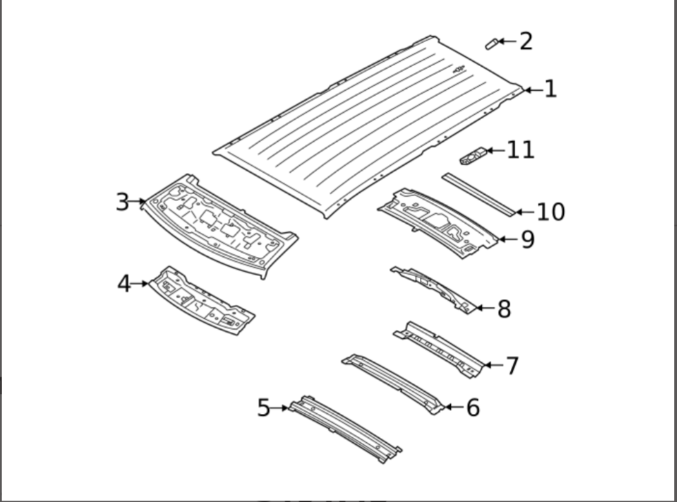

This torsion strength I think is not true. They only make one structure that either gets a glass panel or structural filler sheet metal.
The interesting thing is, it looks like if you want to delete your sunroof, you can replace it with this panel and then put a new headliner in.

The diagram posted by Allegedly shows the design and function of the build, and panoramic roof or not, the load is affixed to the roof rails, which will have the same load-bearing capacity as one with or without the glass roof. So, LR actually doesn’t believe that someone would load objects ‘ON’ the roof directly.

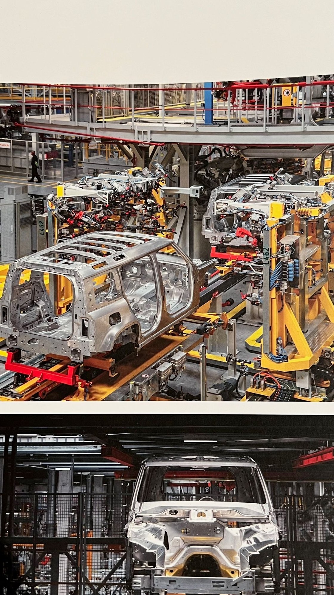

I believe non panoramic defenders do have extra brace or two in the ceiling, Ive seen pictures of production line in that _epic defender book, page 216.

Here's the more complete diagram. The assembly had reference to Speedbonder (glue) that I couldn't open on my phone. Glued to the frame and glued to the top panel.
At least to support the sheet panel from collapsing. Improves stiffness vs a glass panel? Maybe, maybe not.
https://media.landrover.com/en-us/news/2019/09/icon-reicon-reimagined-21st-century-new-defender-makes-global-debut-frankfurt-motor-show
