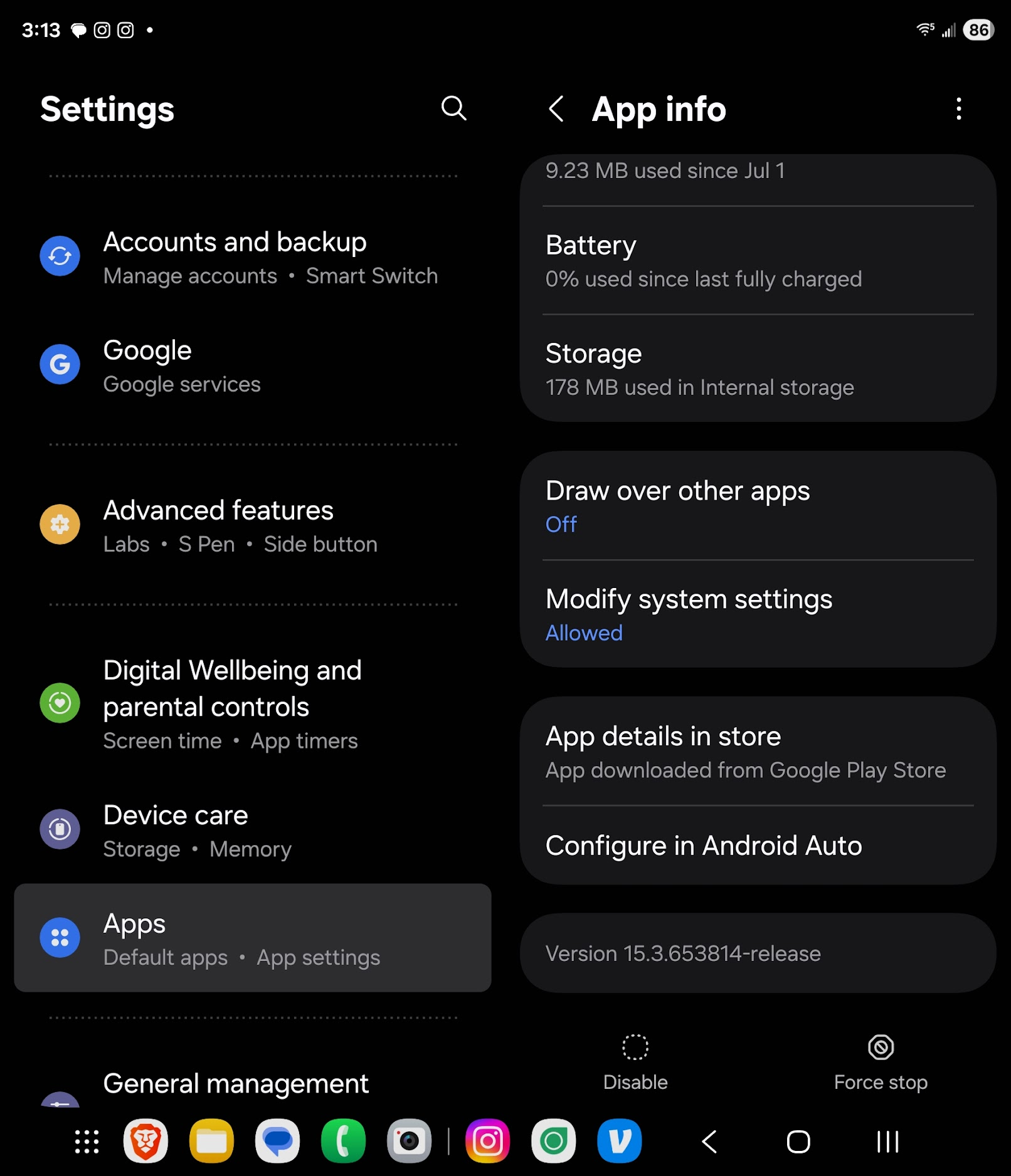

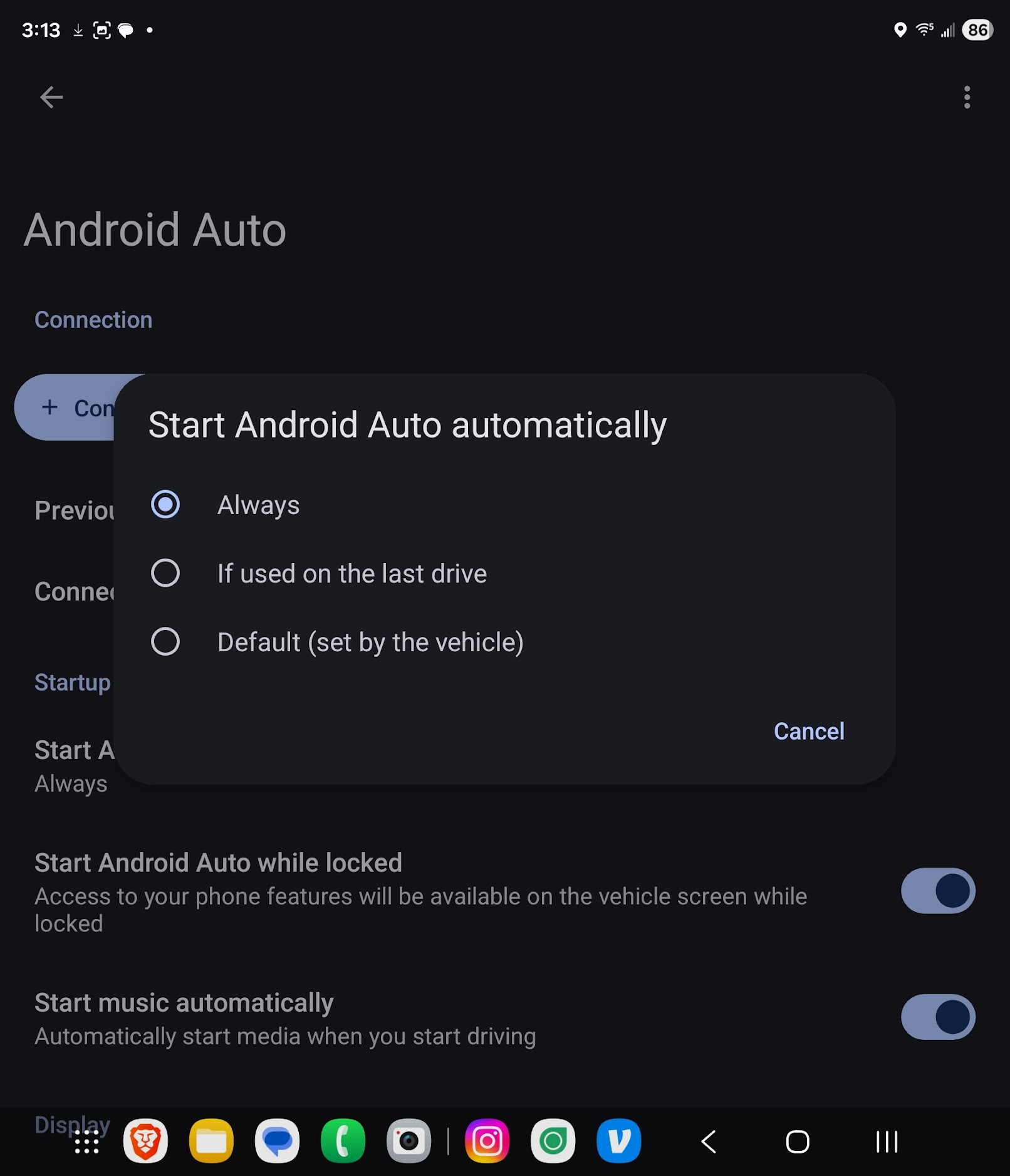

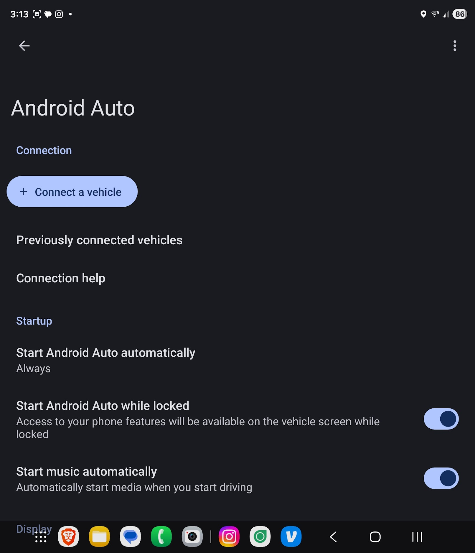

Its funny, because in my other vehicle, the head unit doesn't offer the option of auto-starting AA which I find incredibly annoying. Whereas in the Defender, my phone always connects to Pivi and launches AA before my wife's iPhone (which really, REALLY makes her mad).
Apps -> Android Auto -> Configure in Android Auto -> Start Android Auto automatically. You can also set it to not launch if your phone is locked.
See attached screenshots.
