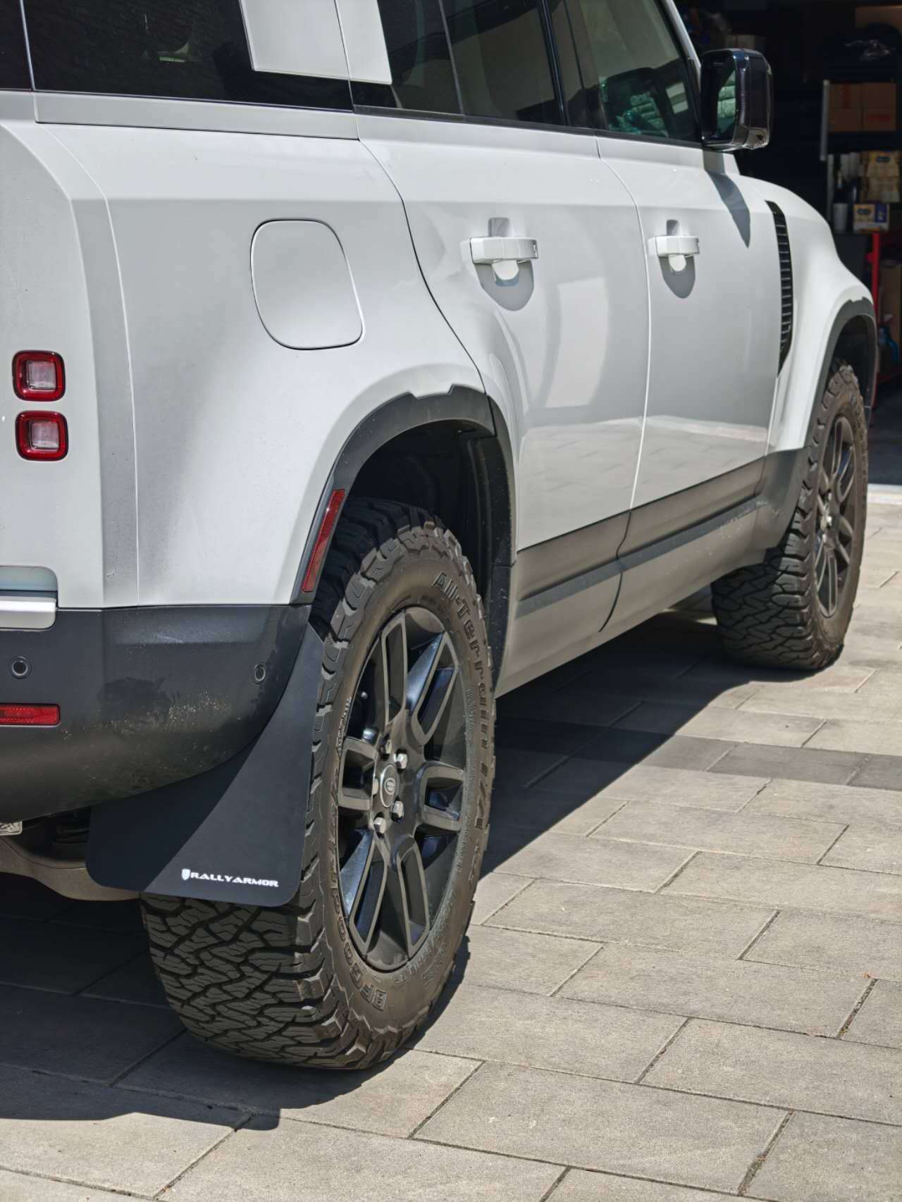

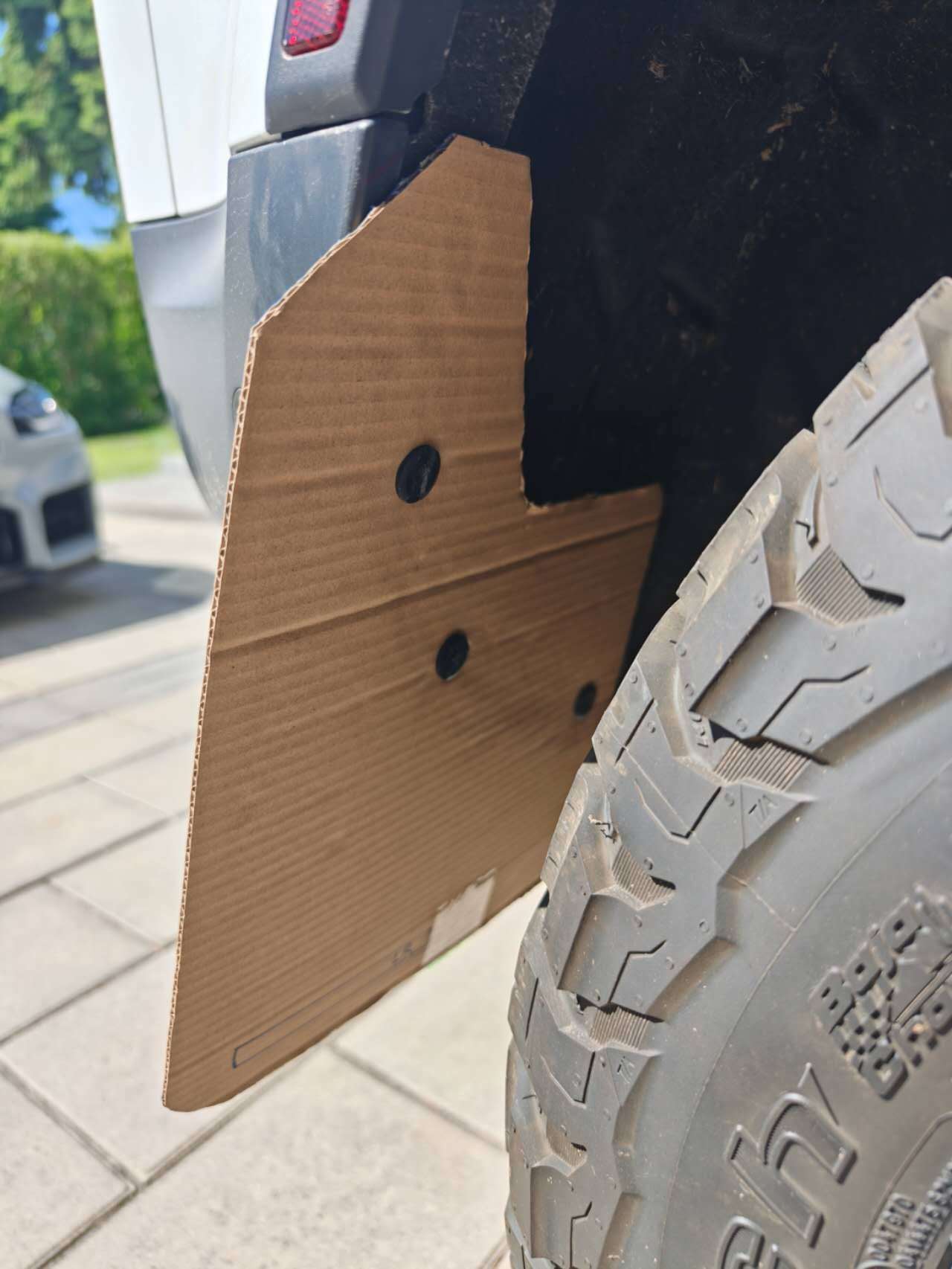

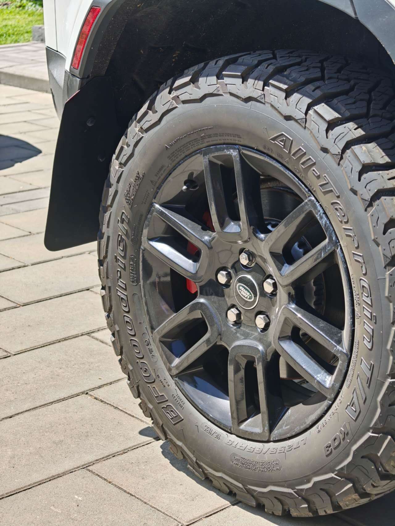

Because I wanted to create a rally-style look, I decided to make my own mudguards, using the original three clips on the car. I've listed the part numbers in the end of this post. You'll need to make your own template. The finished product is very secure, and the installation height is higher than the exhaust, so it won't affect the departure angle. No cutting or drilling is required, so it won't affect the car's appearance. To clean the inside of the mudguard, simply remove the innermost clip to remove stones and mud.The front wheel installation will be done later; the front wheels require drilling holes in the plastic frame. I will continue to update this post.
