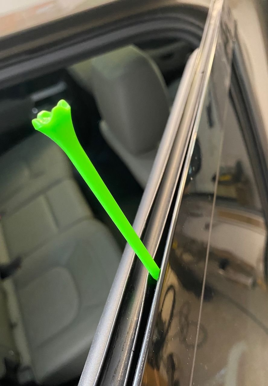

Quick and maybe stupid question - where do you apply the grease? Do you pop the seal off and put it inside?

@gurka01 - Think of it like sunscreen. You just want a very thin coat everywhere. If you knew where the sound vibration was coming from, you would only need to put it there! (jest) Since you don't / I didn't, I put it / you should put it on all of the rubber where the noise is coming from. I put it mainly where the outside air stream is hitting it and causing the vibration or whistling.
No need to do that. You can easily work it between the door and the seal:
