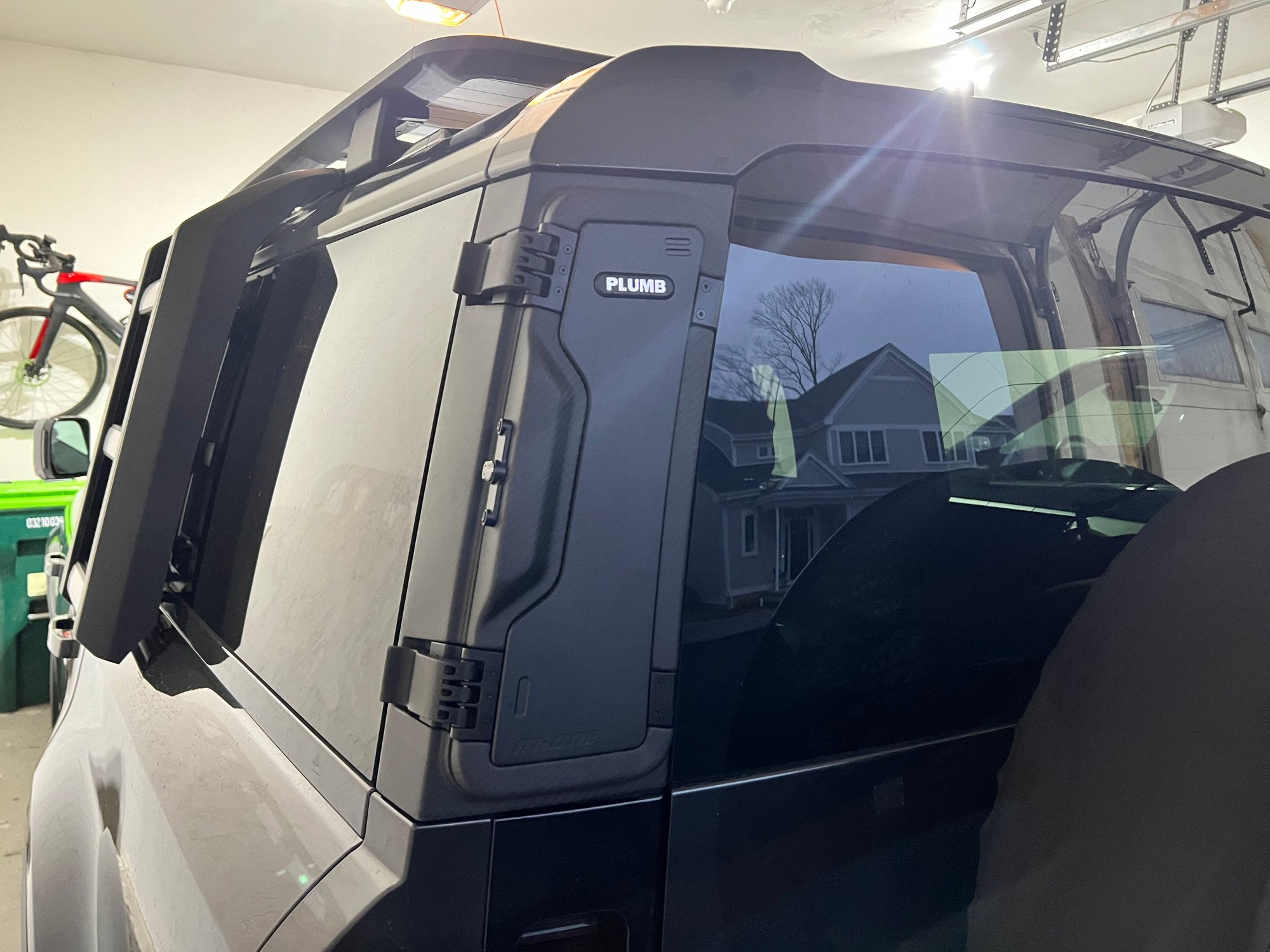

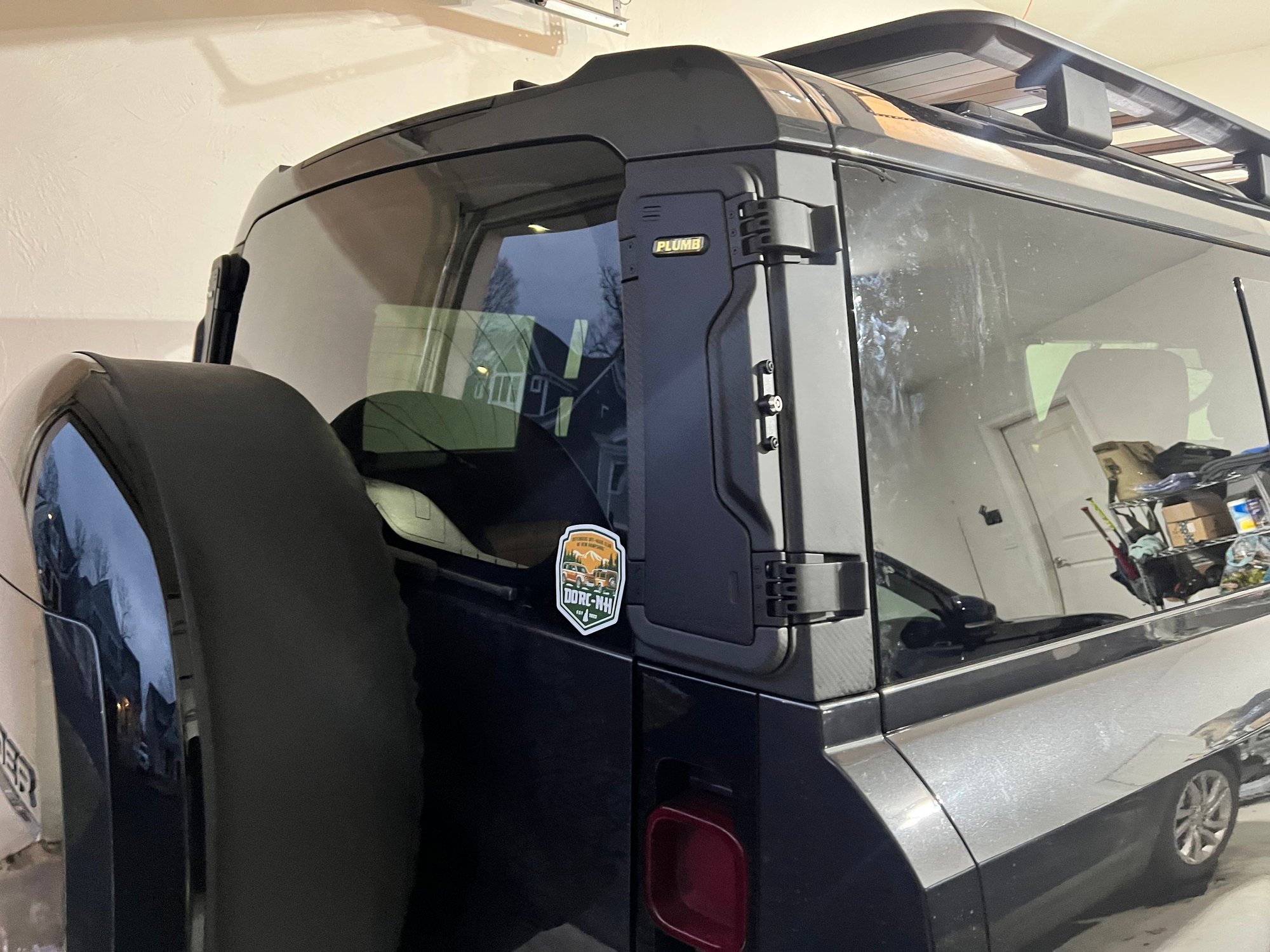

Yes, the price is crazy but I think it looks great. I did not go with the included rivets and went with my own rivet nut installed. I will take logo off. No damage on install in fact very simple pop and pull. Can reinstall oem by just drilling out rivit nuts. I did put vinyl tape over holes that were not used to prevent water getting in.

Couple questions for you @Michael130 . I have a Rhino/Lucky8 ladder and wondering if it would still open behind it. So, about how far do the doors extend out when open? Also, how far do the open? To about 90 degrees or more? Thanks for any tips you can provide. Looks great!
I just measured them. The door itself is 5 1/2 inches from the hinge and the snaps add another 3 to 3 1/2 inches but again those are fully adjustable and do not need to be open fully. It does open approximately 90°. Hope that helps. I am very happy with them.
