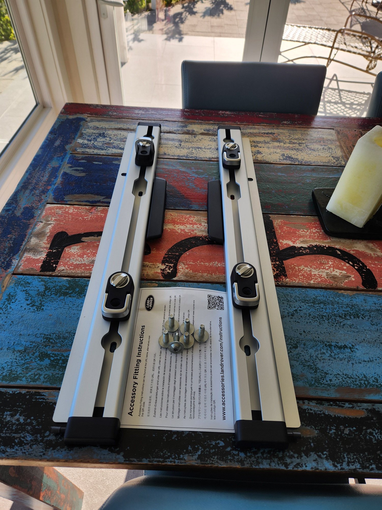

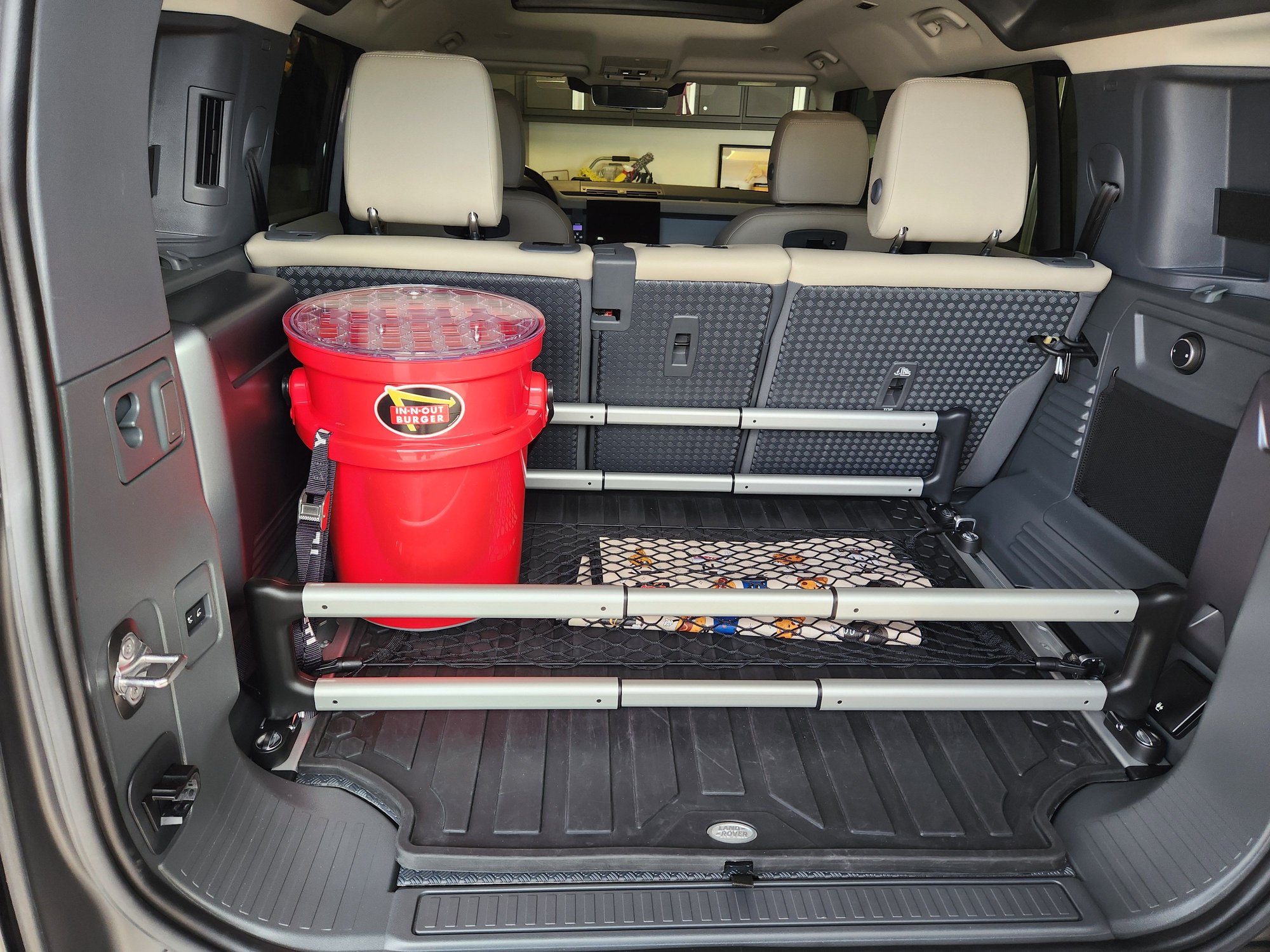

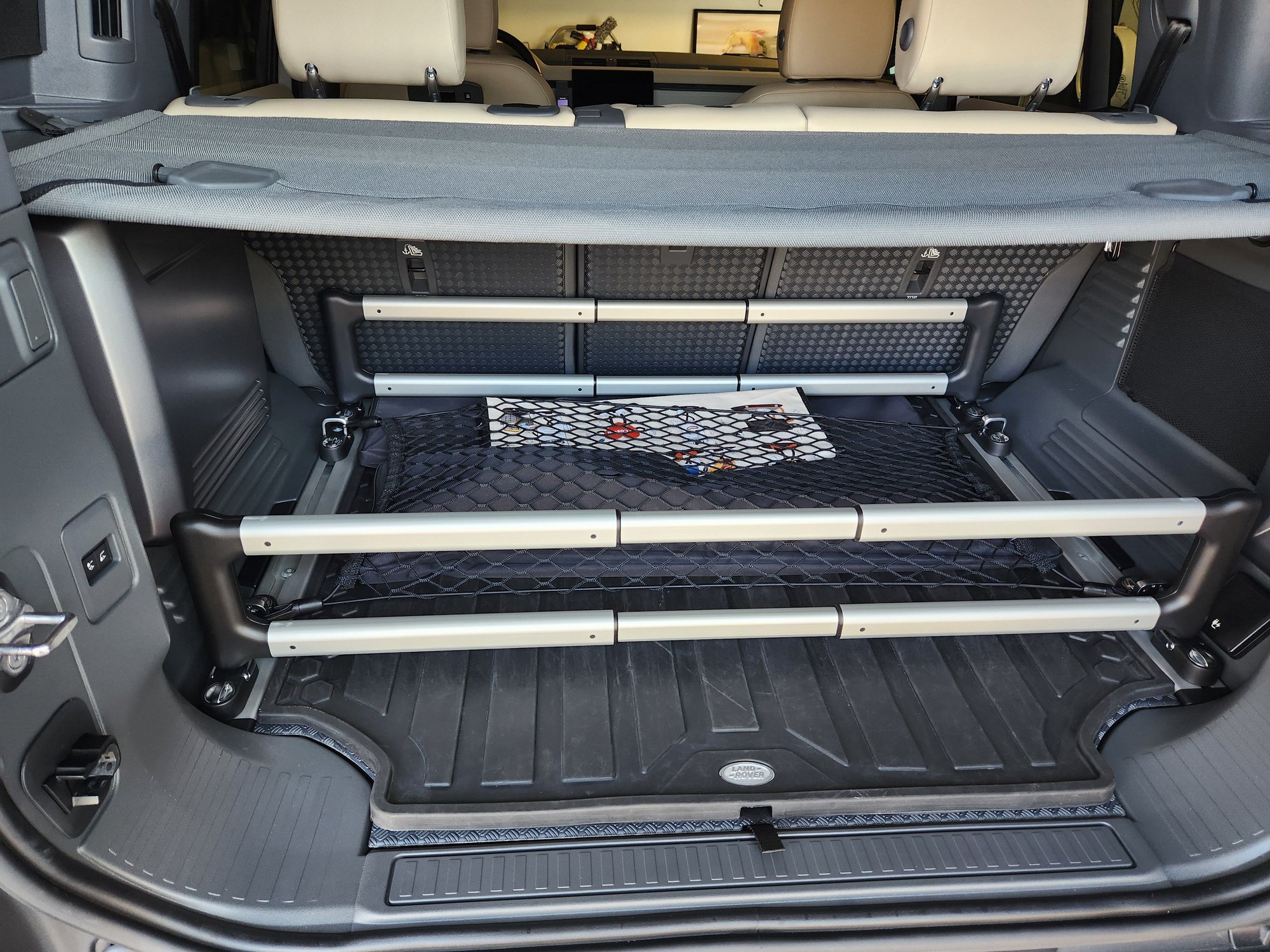

To better control / organize items loaded in back added the adjustable loadspace rails LR part # VPLES0543. Found that Jag parts for the adjustable bars and hooks were much cheaper than LR. Used two sets of Jag bars / retention straps part # C2Z31984. Also added 4 more Jag clips for a net part # DX23​​-19A428-AA. Just push ​​​​​ on top of the clip to slide on rail or pop out bar / nylon adj. strap. Very happy with the result.
