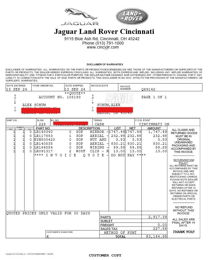

I requested a quote from my parts guy at my dealer for all of the parts needed to do the retrofit. This is my price including a 10% discount.

Hunters has it for $2100. You will need a GAP tool to program it which is why they say it needs to be done in house.
https://huntersprestige.com/products...oNs8X-2FmdsNW1
It can be sourced for less the more used, or aftermarket you go.
Here's a person that has performed the entire retrofit with parts sourced from all over.
https://www.defender2.net/forum/topic88338.html

That is the forum where I got the part numbers from. Also, Hunters Prestige doesn't include the wiring harness or video cable, or the hardware parts that will most certainly get broken (clips). I have access to the Pathfinder software to code my car. I have a few friends who have ordered from Hunters Prestige and they all had issues with shipping to the US and they said the customer support was dreadful. It put a bad taste in my mouth, and I don't plan on doing any business with them.
