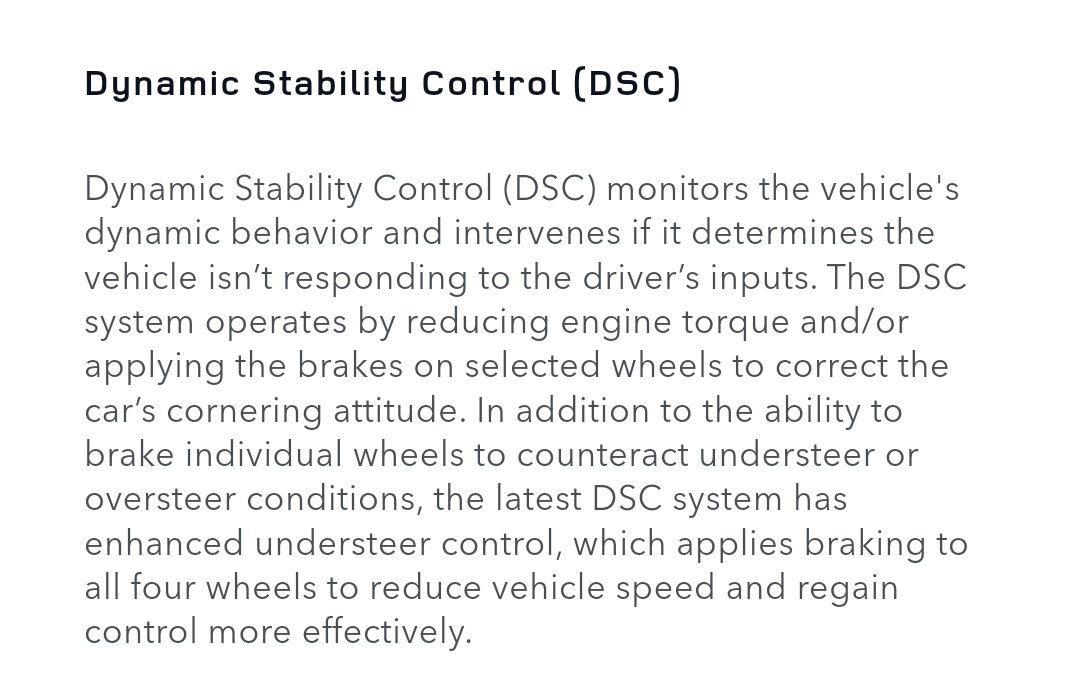

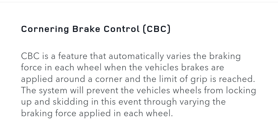

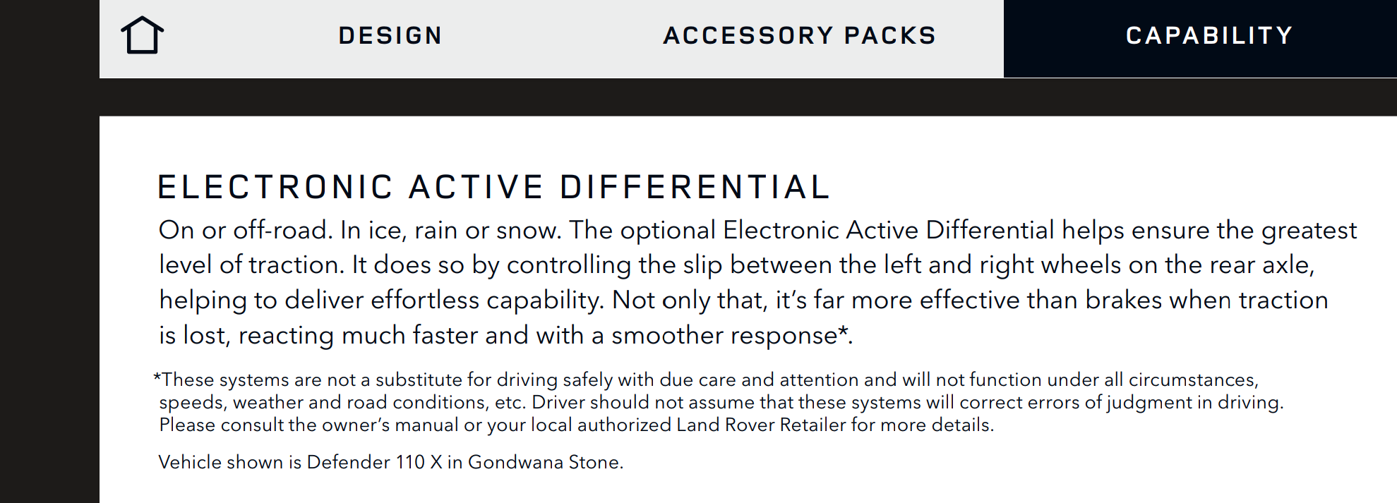

IMO, it's a stretch to say it's going to do much for "regular" daily driving. It's somewhere between being a 5th semi-similar enhanced safety feature and a drifting mode. I push my 110 pretty hard dry and wet and I've never lost traction.
Standard systems in the Defender:
Those can reduce torque to a wheel but none can re-route to increase torque. Against other big heavy boxes I've driven, these are excellent at controlling cornering.
The e-diff option can send more (increase) torque to a wheel as long as it's coming from the engine (throttle input). In fast turns, this can control oversteer (rear wheels losing grip) or understeer (front wheels losing grip). Op asked about "daily driving suburbs and highways" and this is really not that.
