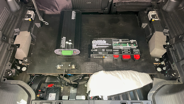

I no longer have our defender. But I was able to easily fit this battery, then a mounting panel across the whole the space, then a carpeted cover above that. Plenty of space for an aux battery setup, BMS, Inverter, etc.

Here's what's underneath there once the seats are removed.
And here are some install photos.
Partial Install

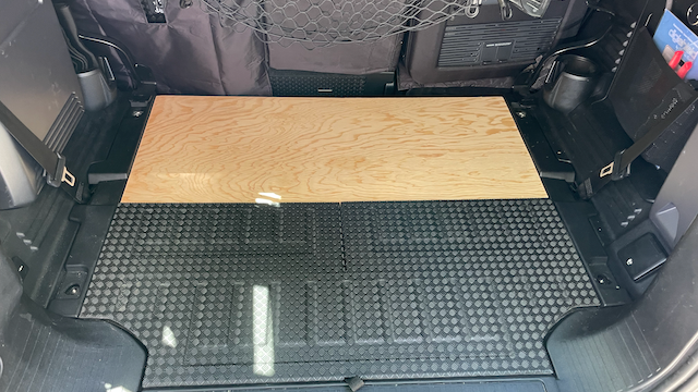

New False Floor

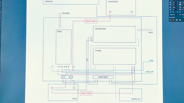

Wiring Diagram

New False Floor
I wonder if its possible if the cargo floor from a five-seat 110 would fit without issues.
