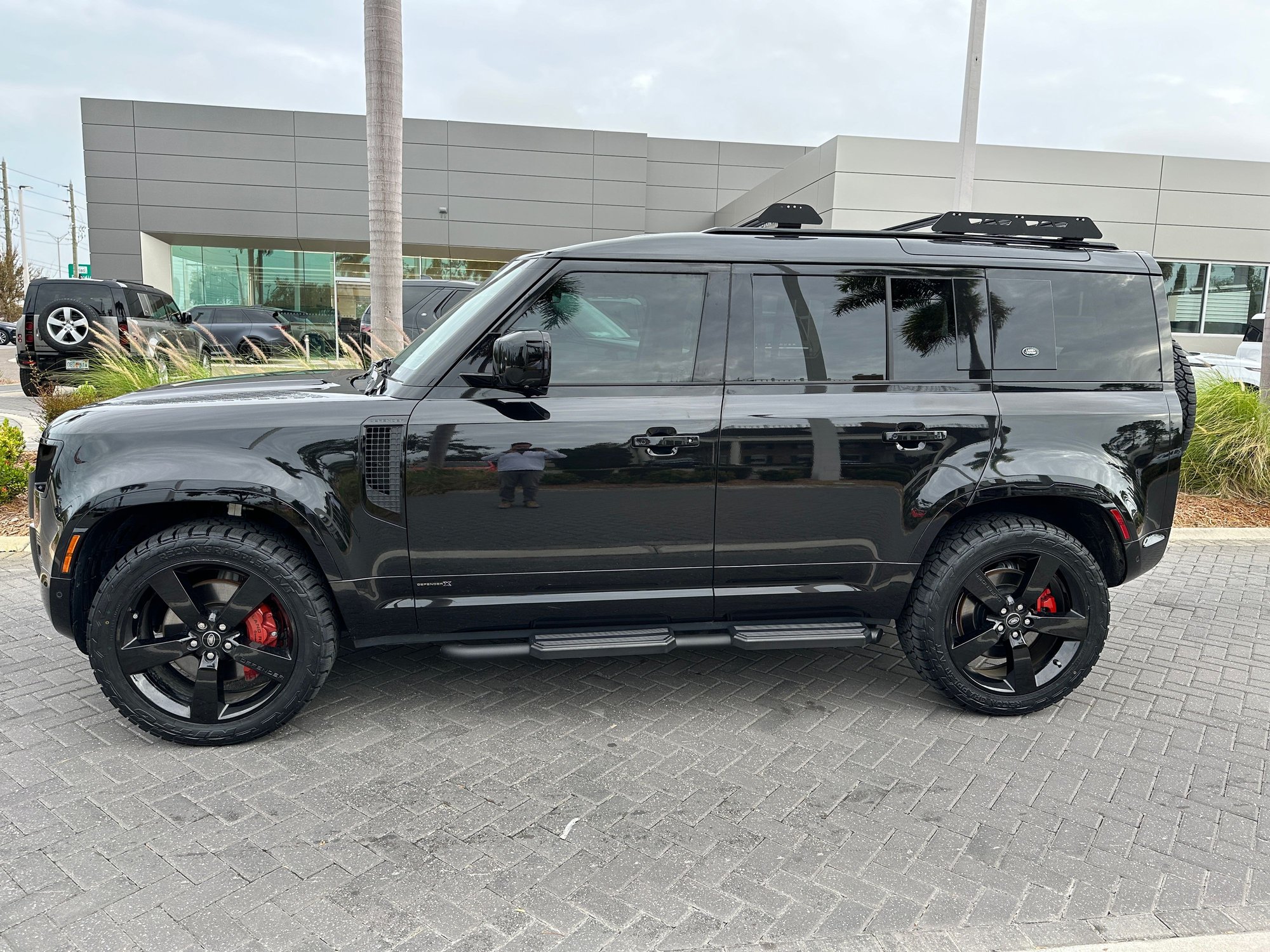

Just got a new roof rack and having major noise and vibration. anyone else have the bad *** tent, low mount? its unbearable over 50 mph with a caveating vibration and only helps when I crack my sunroof or drafting behind someone. if anyone else has suggestions on cross bars or racks that won't make the wind noise, im open to suggestions for switching. only need a few times a year for a kayak so could go with a removable option.

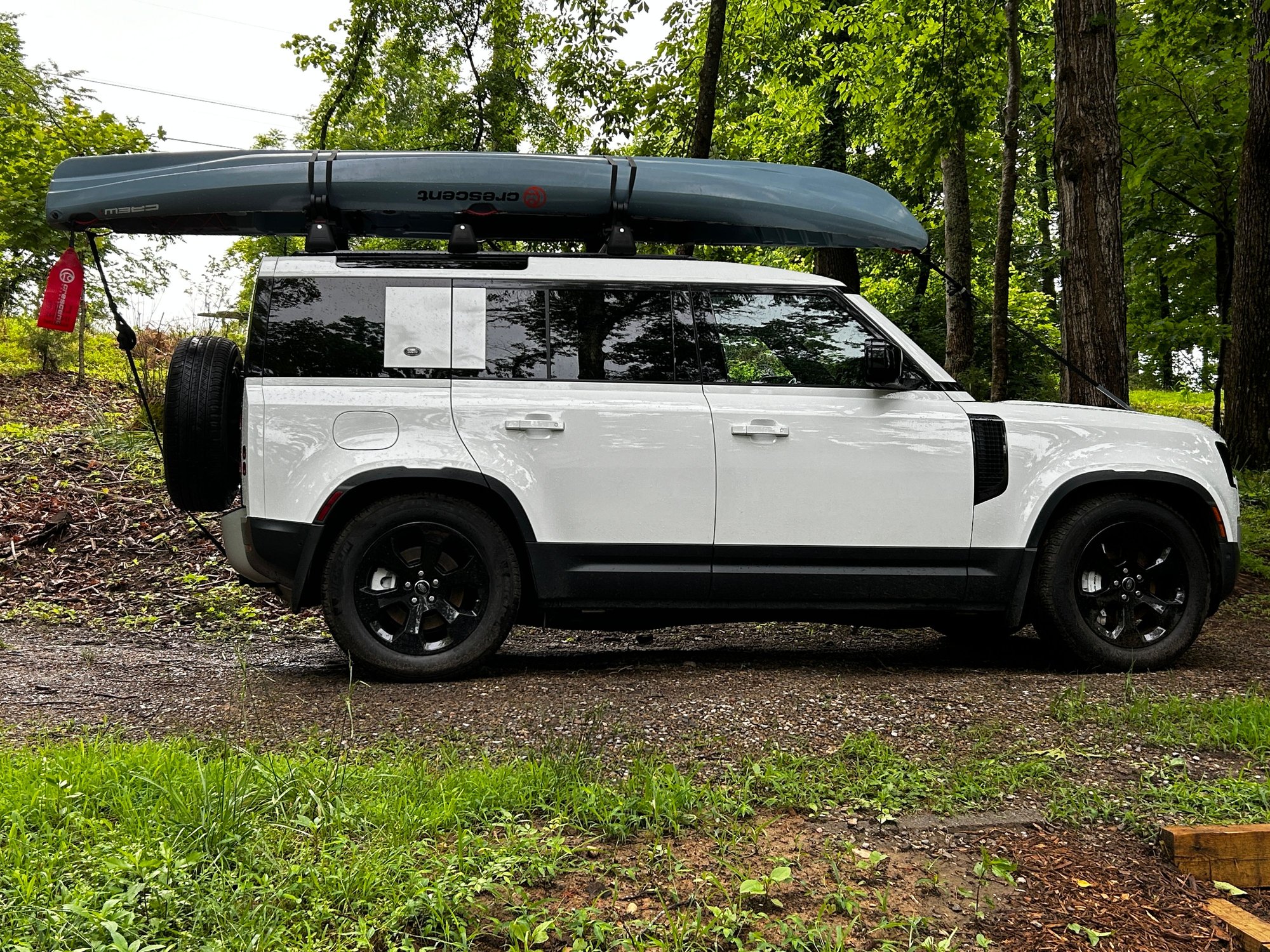

I added a third factory crossbar (with a little customization) so I would be able to put my 13ft fishing kayak on the roof. It works great and I have not experienced any excess noise or vibration.

Yeah, I have the same setup and it's the front bar that's causing all the noise. I use it to drive surfboards to the beach on a low speed road (highway 90 or local roads instead of interstate). But we took a trip from New Orleans to Green Bay and I had to stop and remove the front bar a half hour into the trip. The rear bar isn't bad at all, not much different in noise, but you will notice a difference in gas mileage. I haven't had any issues strapping the boards to the rear rack without the front bar, even at interstate speeds.
