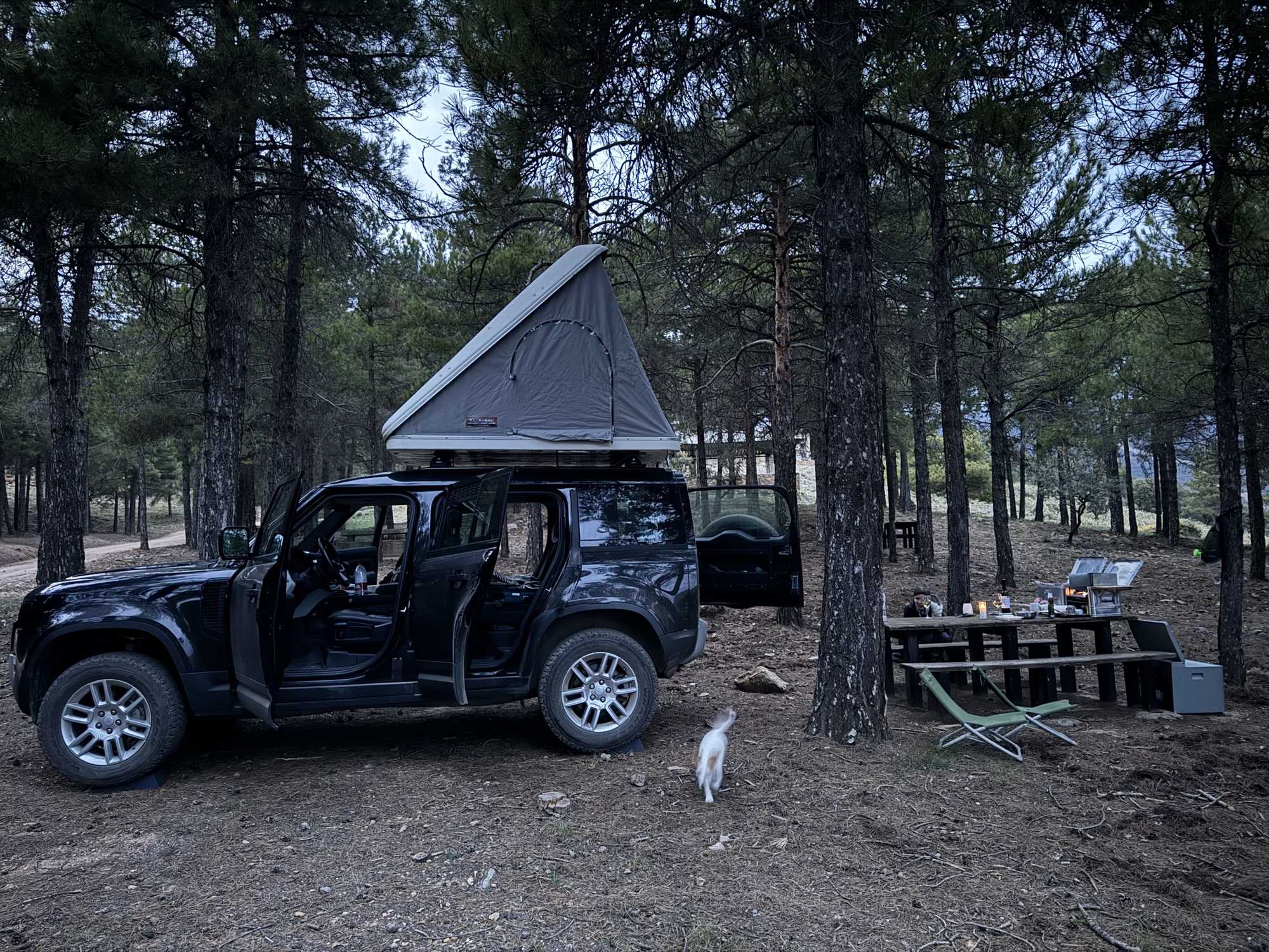

Check this guys setup
I was considering this setup but decided not because of our dogs. You will need bars or a roof rack to support the RTT. You can go factory or plenty of aftermarket alternatives. I have a Rhino Rack only because it was on my LR4 and I bought alot of their accessories and put it on my Defender. Others can chime in on other bars or roof racks.

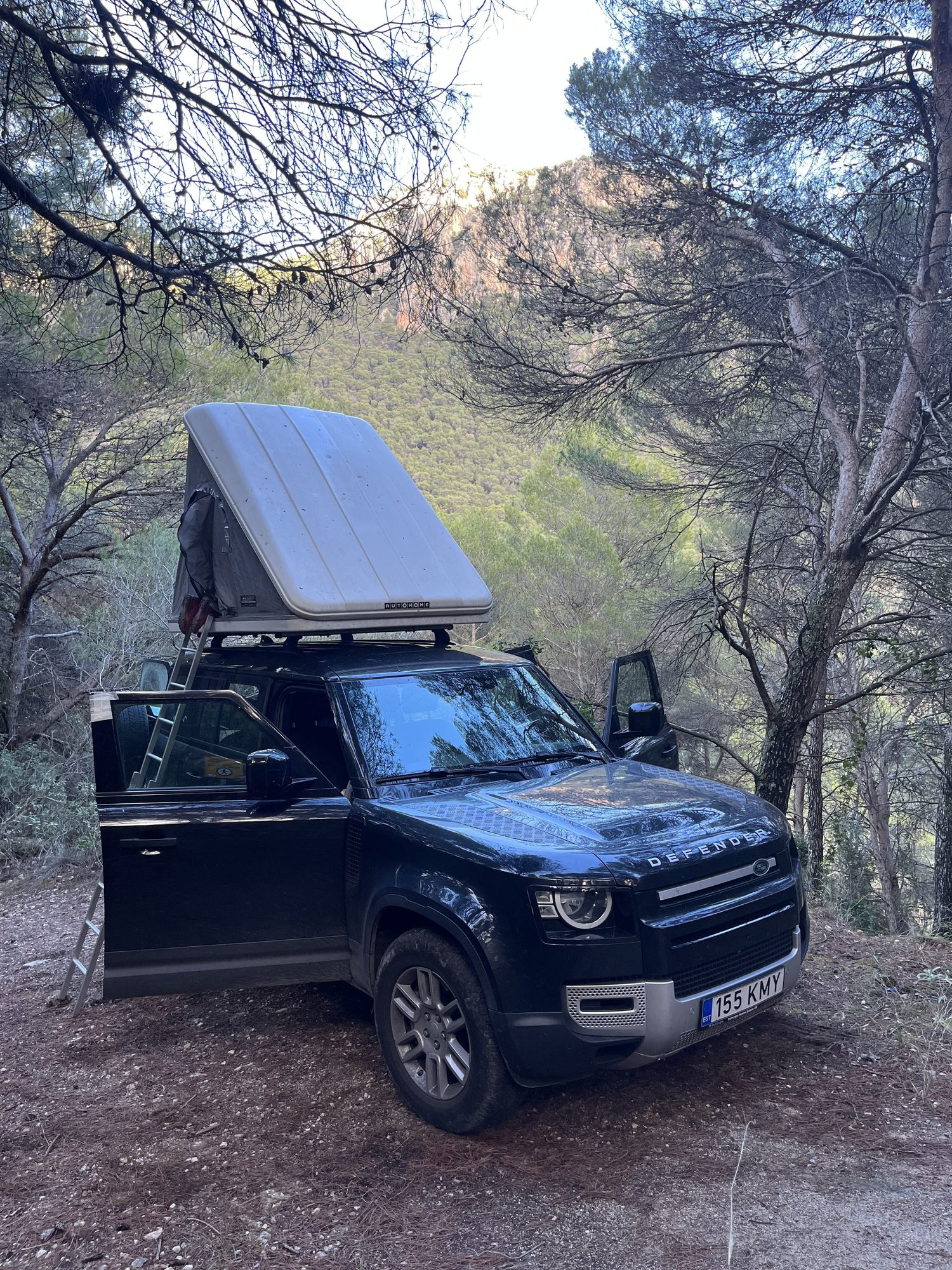

I have used Autohome for 5+ years, very nice. They are also Land-Rovers official partner, check them out
Thule tents are supposed to be good as well
No point of getting the huge rack if you put tent on top, just get cross bars, if you just want the tent get some wingbars
I use Thule ProBars, you need to get the bars and feet separately, might need to cut the bars to size, but this allows to also add an awning if you so desire as you can get them to be a bit wider and go over the feet and as they have T slot als0 on the backside, it allows using all kinds of accessories. They are also sturdier, which I'm happy when I drive over 70 with the tent on top.. might add 3'rd bar if your tent allows..
You will get a ladder with the tent anyways, and yes it is nice to have 2 ladders at night when you need to go... but in all honesty, don't bother. I ended up removing my ladder due to the wind noise and build quality, It broke 2 times under my 170 pounds.. There are quite a lot of topics about that in this forum, check them out. Also my wife was not happy to use it, as it starts quite high and she is not that tall.
