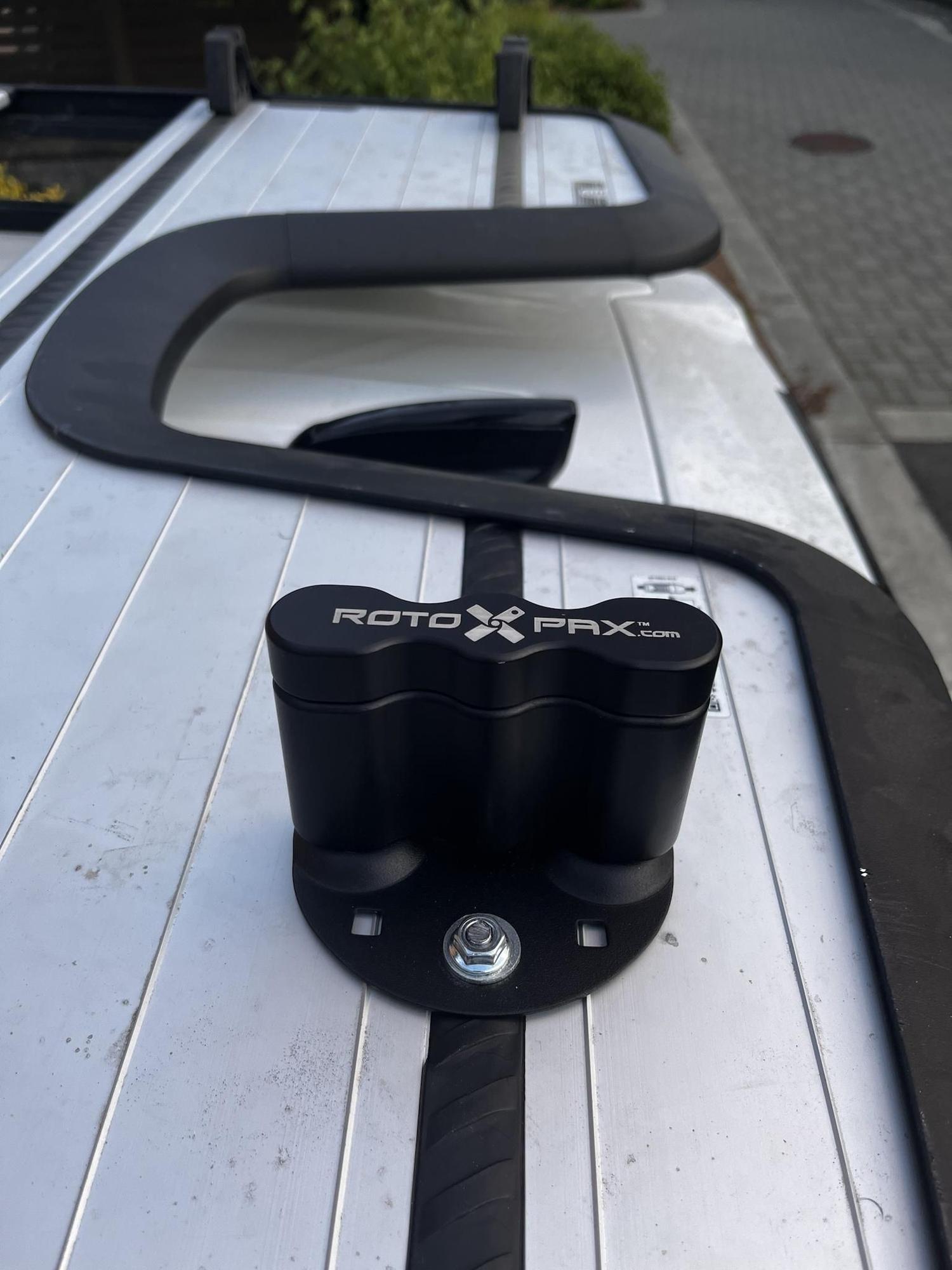

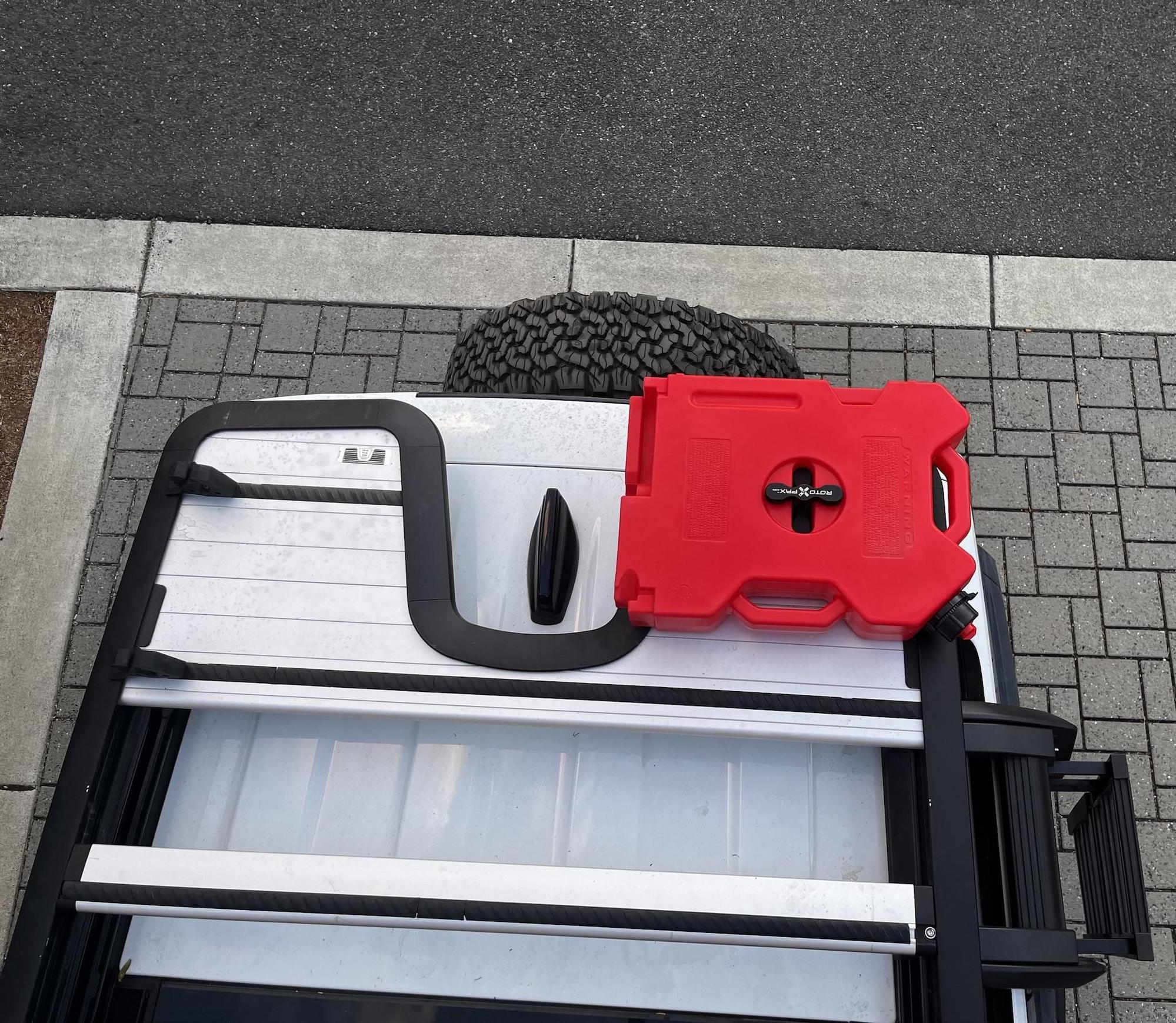

As simple as you like. After searching online and seeing the myriad of options for these at various costs, and after debating making a plate from 1/16" aluminium myself, I decided to first try the OEM rack with a couple of Thule T-track M6 bolts. Not sure why I didn't look at this option first.
Works well. Costs about $10, not including the RotoPax hardware. KISS
The setup with Pax mounted.
Mount positioned this way to reduce drag when not in use 99+% of the time.

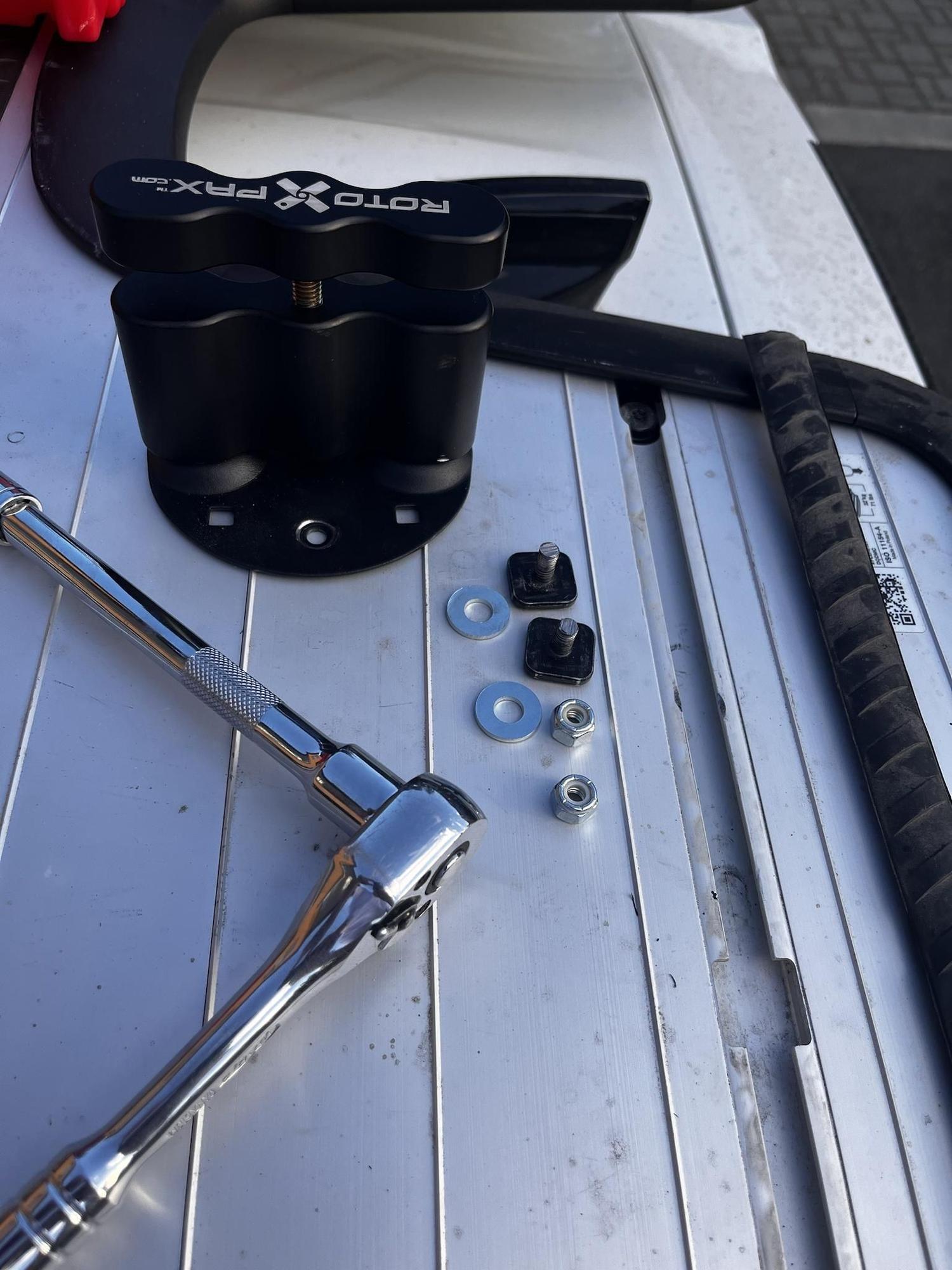

Washers and rubber stripping
Monday evening tinkering

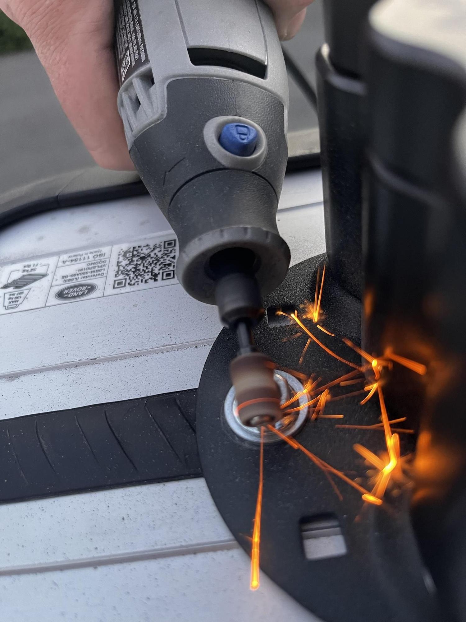

I used shorter nuts in the end.
A final polish.
