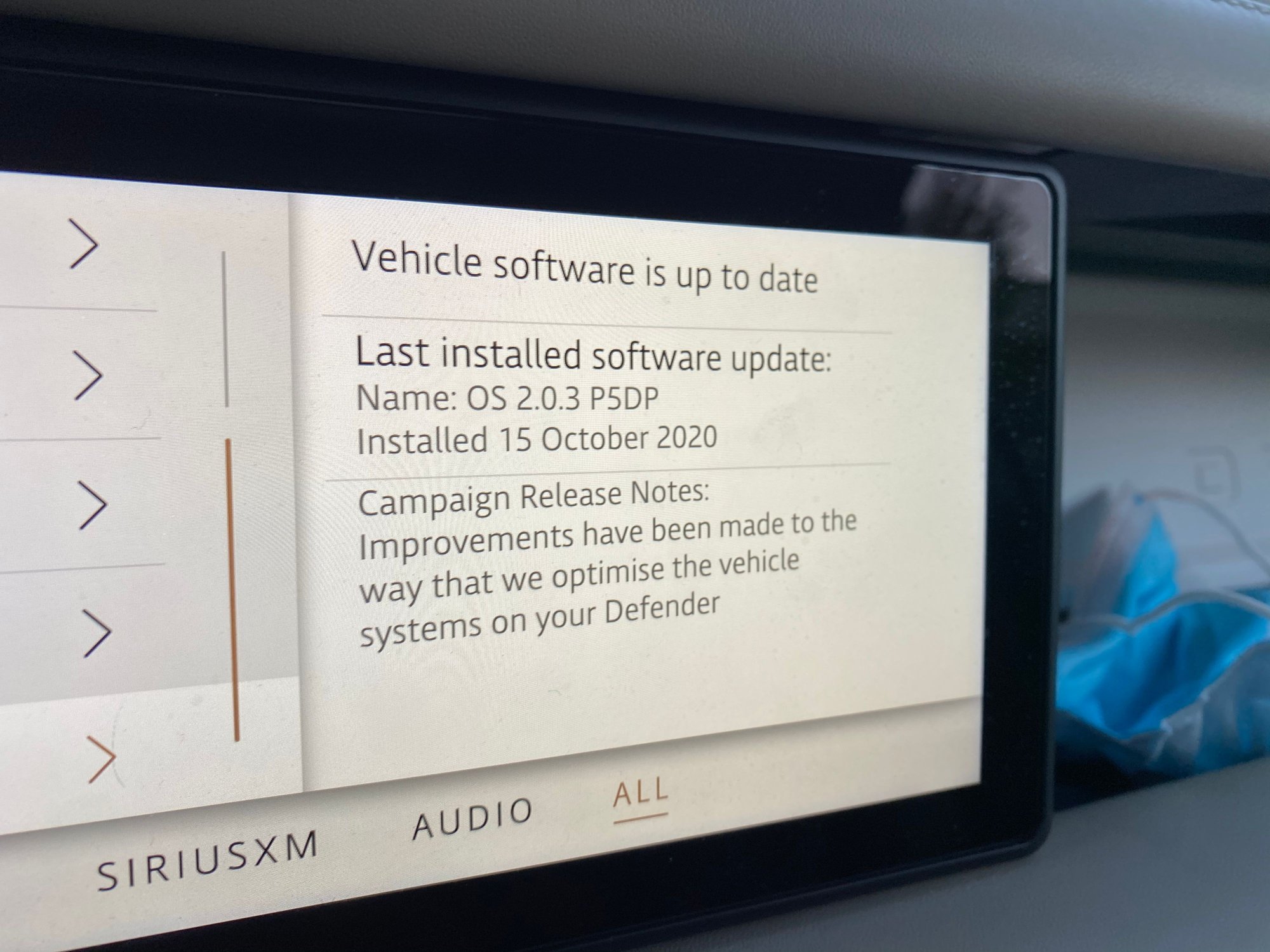

I have the same issue with my satellite radio. It stops working and needs to be reset every few days. When I reset, I lose my favorites. I spoke to service manager at my local dealer and they said they have been waiting on a fix since July.
Old Oct 17, 2020 | 06:34 AM
devonshans's Avatar
4wd High
Joined: Oct 2020
Posts: 9
Noticed a software update on 10-15-20. Maybe this will fix the issue?

The satellite radio still freezes. The software update didnt fix this. The only fix is to hold power button on volume dial down for 20 seconds or so until it resets,. The radio ends up freezes again, usually a few days later. Anyone else having this issue?

The software 2.0.3 hasn't fixed anything that was noticeable. Freezing software, Sirius connectivity are all still present.
