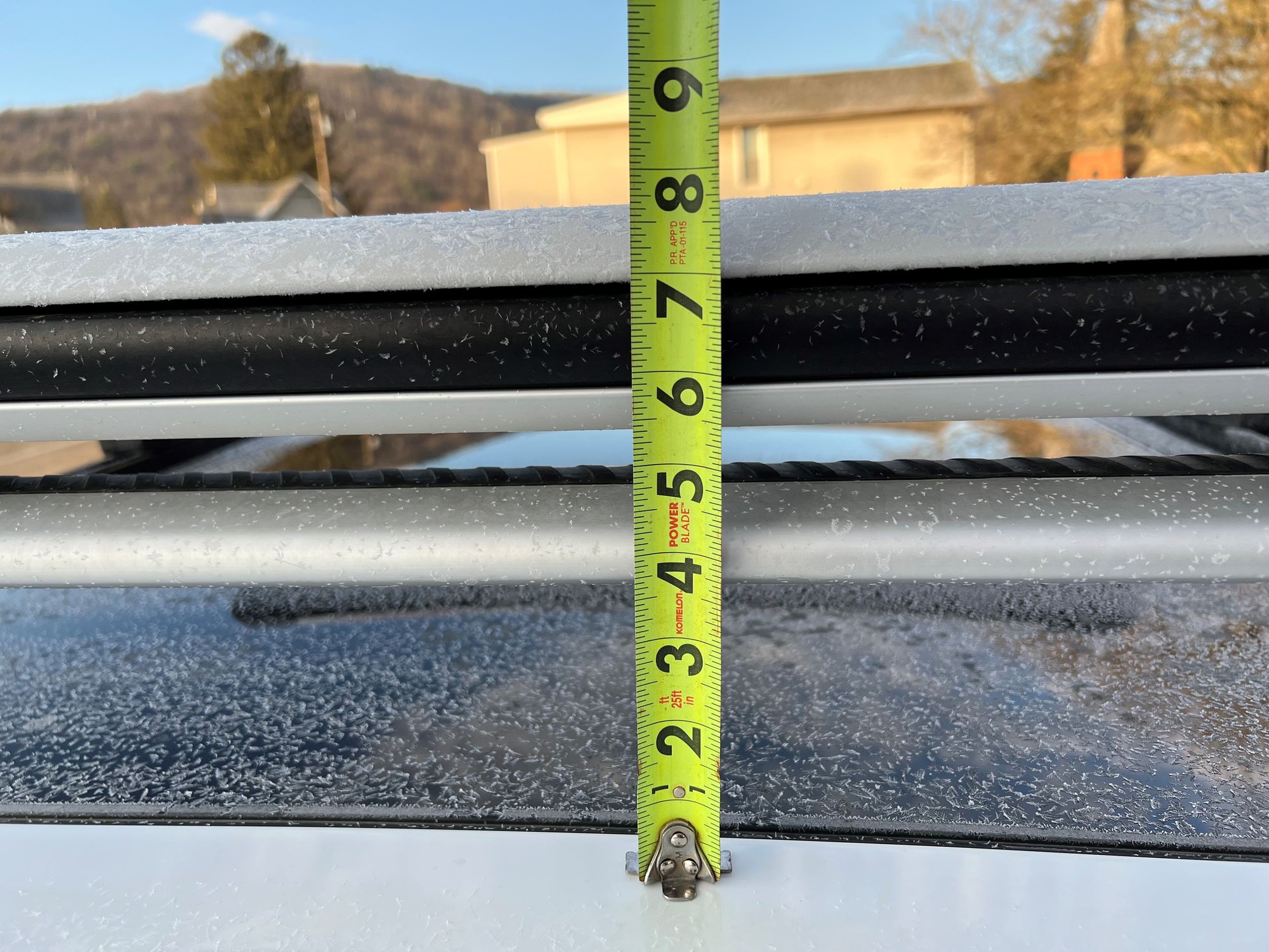

@Dogpilot - you have the Thule crossbars and the Yakima Fat Cat and that combo works with 7' doors right? (ahhh but I see you wrote this "I ended up making different feet adaptors for the crossbar feet to lower it and custom mounting blocks for the Yakima, again to lower it." - how hard was the fabrication? Just cutting stuff not welding?)
@gschmitt - you have the OEM crossbars, with the Fat Cat and smart T-slot set-up. Do you happen to have 7' doors? I was actually leaning towards the OEM bars because I like using OEM parts, but I guess it's not particularly important. If you don't have a 7" garage could I impose on you to measure the height of the top of the Fat Cat above the top of the roof rail? We've got 8" to play with
Below is a picture of the FatCat 6 attached to the OEM Cross Bars with the SmarT-Slot Kit 2.
The top of the FatCat 6 is approximately 7 11/16" from the roof of the defender.
The distance from the top of the OEM Cross-Bars to the top of the FatCat 6 is approximately 3 3/4".
WOOT WOOT - THANK YOU SO MUCH!
We measured 8" of clearance from the tops of the rails themselves - that means we have the height of the rails as cushion and the OEM crossbars with Fat Cat (w/ T-slot) will fit at normal ride height for us!!!

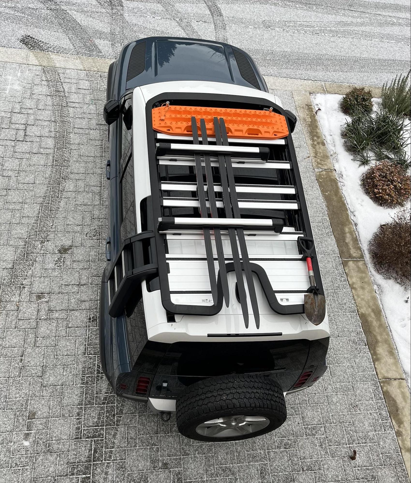

First day of the season here today.
Compared to crossbars, the rack is handy as you can carry other stuff too.
Shovel and Trax.
Both are especially useful when someone decides to (unsuccessfully) plough their own parking spot in 2+' of snow and gets high centered.

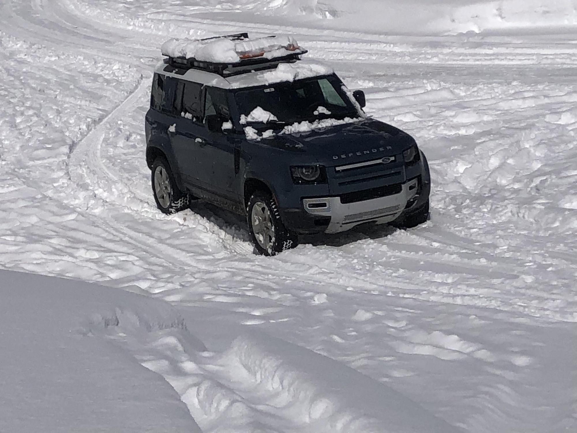

Personally, I have way too many things for the top of the car, Expedition Rack, Front Runner Slimline II Rack and the Thule Crossbar system. I, personally, dislike any of the racks on the roof in the winter. I find it challenging to get the snow off them and from under them. If we let the whistling wind as we drive do it here, we get ticketed. So I pull them off and substitute the crossbars, which were, by comparison, dirt cheap and easy to get the snow off the top of the car. Besides, I only run the racks when I need them, they waste gas.

My garage lacks the space and hoist of your hangar so my rack stays on.
Clearing snow from it is a PITA but fortunately my scofflaw, half-assed efforts don't get ticketed here.
