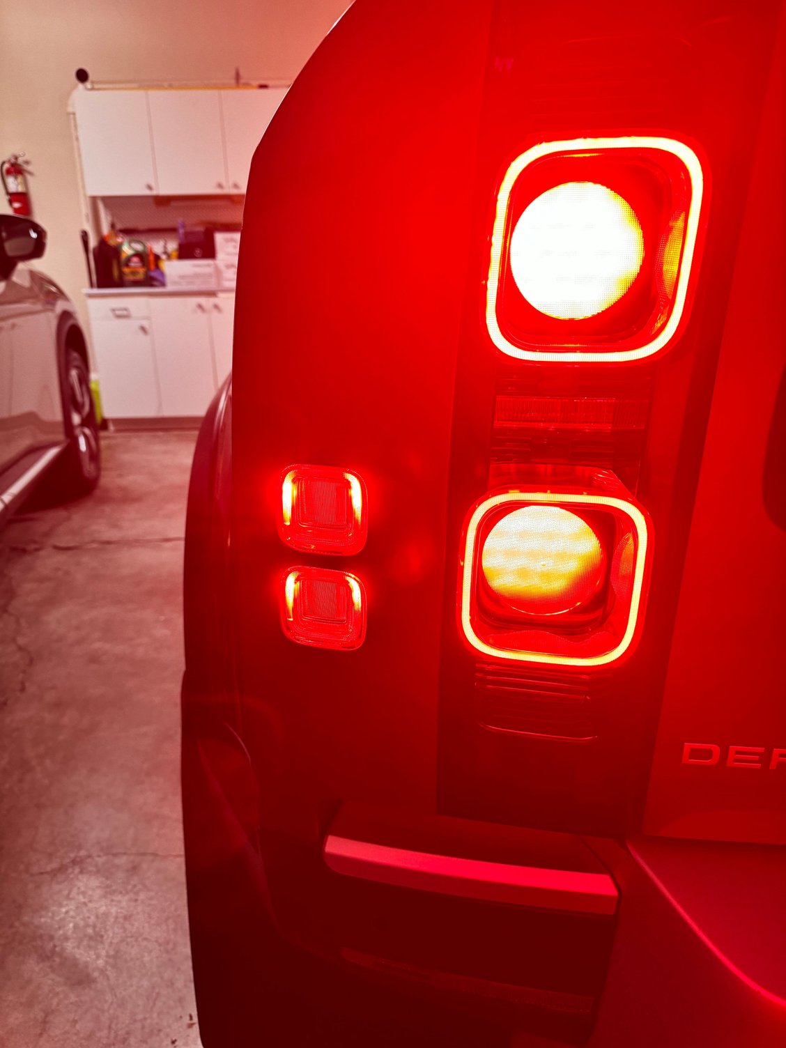

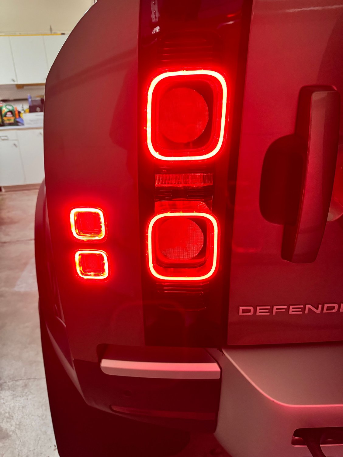

I purchased some of the Chinese replacements. They look identical to OEM “X” taillights. Just be aware that most of them are universal rather USA spec or ROW. US spec uses 4 wires and ROW uses 5 wires. The universal will work as plug and play if you don’t have any of the additional reverse and turn signal accessory lights hooked up. Mine worked fine until I reconnected my accessory lights then the brake lights would not illuminate. Fortunately the brake light function returned when I disconnected the accessory lights. It appears that the microcontrollers for the lights don’t play well together. I decided to run the smoked tailights and drop the extra accessory lights. They looked sharp until they lit up. The quality was just not there. The outside “ring” did not light up properly. I ended up returning them to the vendor.

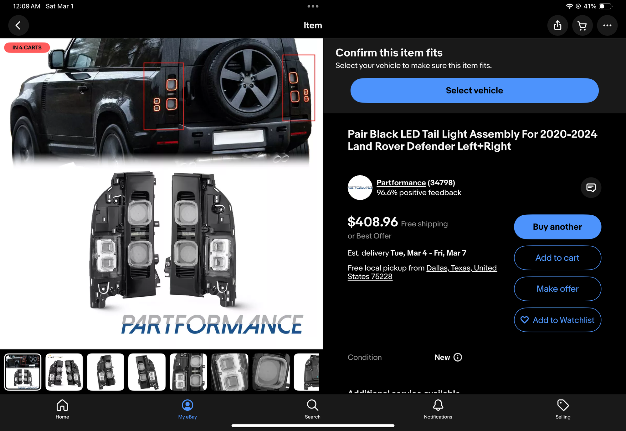

I purchased the taillights via eBay. Although the lights were defective (at least in my opinion) the vendor was very responsive and fully refunded me to include return shipping. I would not hesitate to order a set from Lucky 8 as I’ve had great service from them. I would check with them for their return policies on defective items-just in case as they normally charge a 20% restocking fee.
I ordered from this vendor on eBay.
