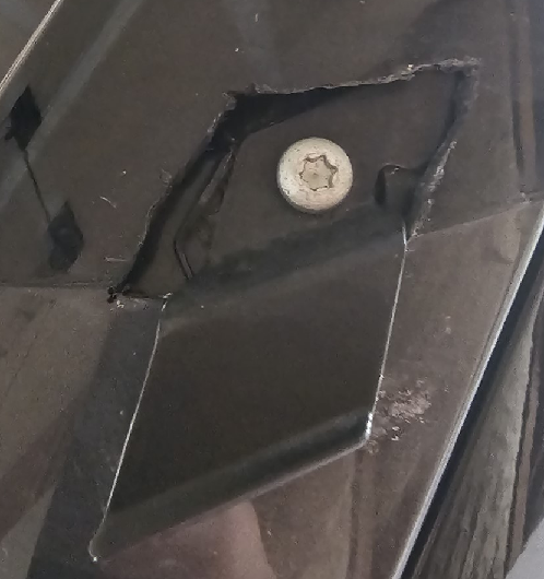

Just wanted to send @GCSchmidt a big thanks for the help here - I rescheduled my appointment for tomorrow and decided to take the RAI off this afternoon to make sure there weren't any issues.
I thought my ratcheting box wrench would come in handy, but ended up getting the bolts loose with my 1/4" socket wrench (shallow 10mm socket on the top from the inside of the door with it almost closed, deep 10mm socket on the bottom from the outside with the door all the way open. I put strips of masking tape along the front edge of the door to protect from scratches and wrapped my socket wrench with electrical tape for some padding just to be on the paranoid safe side, but while it was a bit cramped for big hands it wasn't exceptionally hard to get off once I got the bolts started and could hand-loosen them.
Back on hopefully isn't anymore challenging than off - it looks like it shouldn't be too bad. At least I know what I'm doing and the tools will work, so thank you again! Fingers crossed Safelite doesn't have any issues with the glass or recalibration tomorrow afternoon.
I was a bit less than impressed when I saw the work that was done installing the snorkel. While I recognize most people are never going to take the snorkel off and see under it, this is quite a hack job on the A-Pillar cover. Now I'm going to have to take this off and clean up the opening before I reinstall the snorkel because even if nobody can see it or know I'm going to know this is under there.
