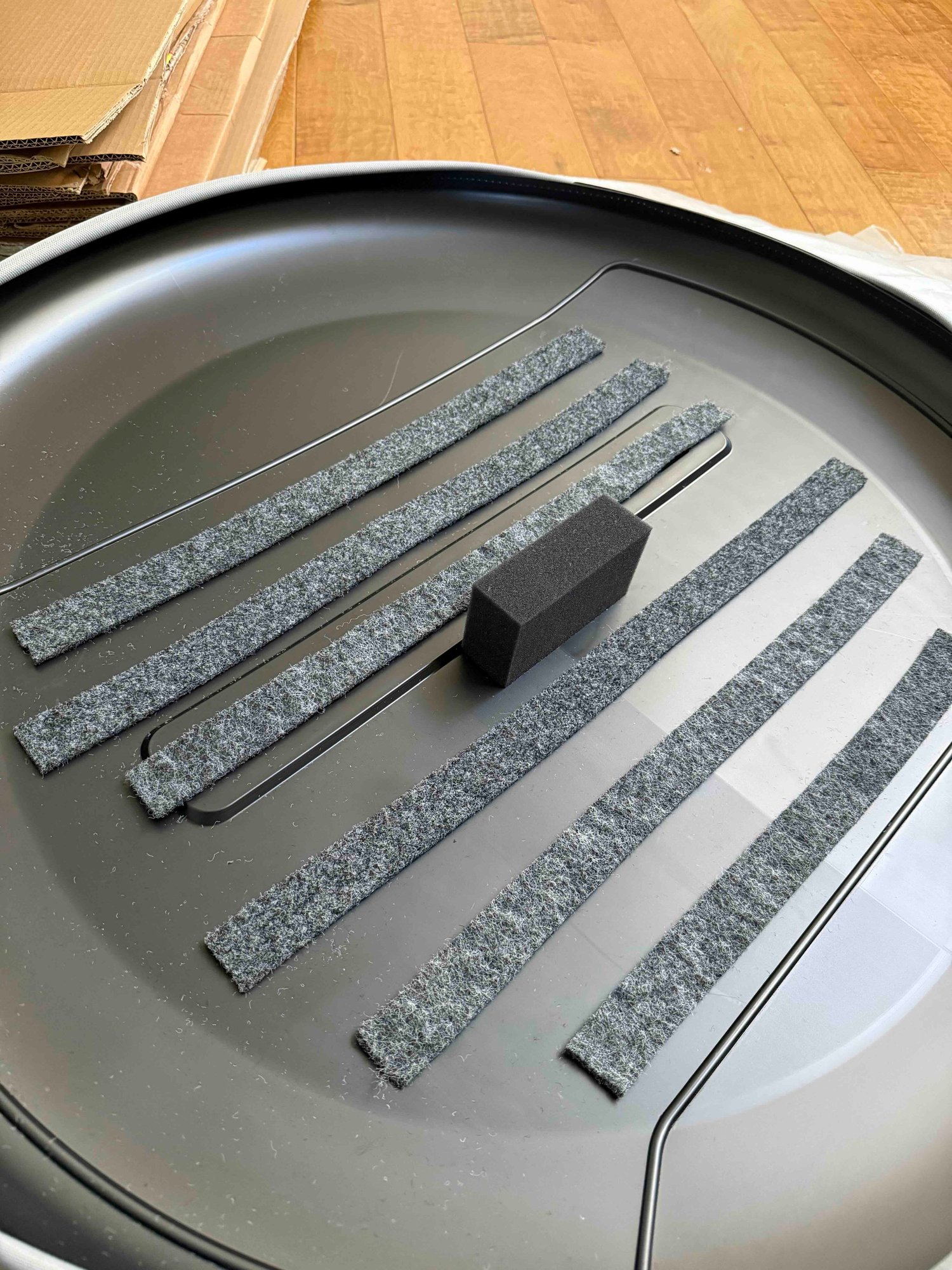

As I wanted to add the spare tire cover and worried about scratching the new wheel on the back so this is what I did.
Mine is replica as LR never offered 75th green cover. I made sure to buy a version with foam then went to home depot bought the weather sealing felt roll attached with double sided tapes. I hope this can prevent any potential wheel damage.
