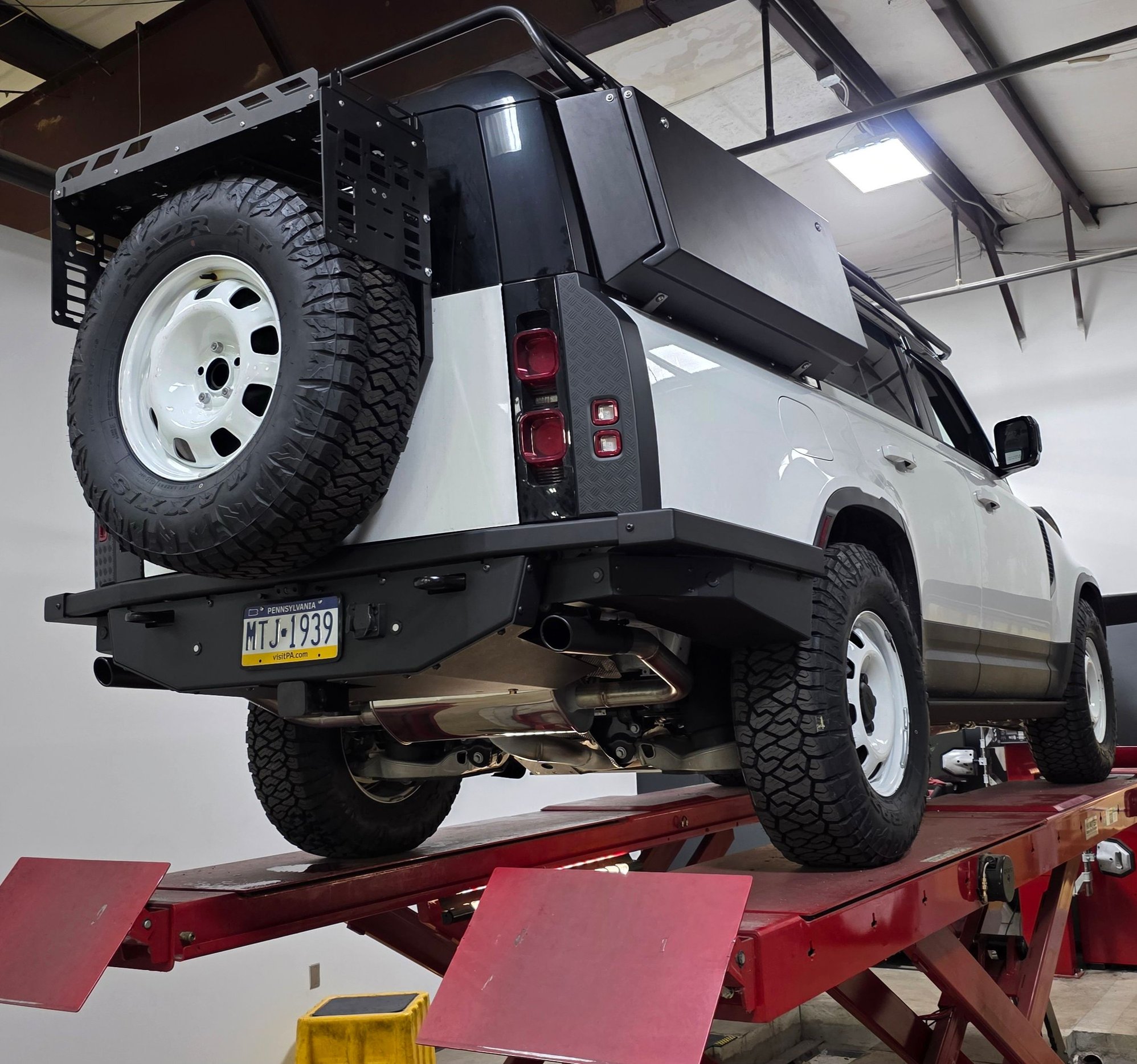

Here is a p400 130 that we installed steel wheels on. It requires a bit of caliper modding, but can be done unless u have the big painted brake calipers like the V8 has. Usually the p400 with larger than 20" wheels from factory have the v8 style calipers. This has 285 75 18 (35") tires installed and a 1 inch lift rod.
