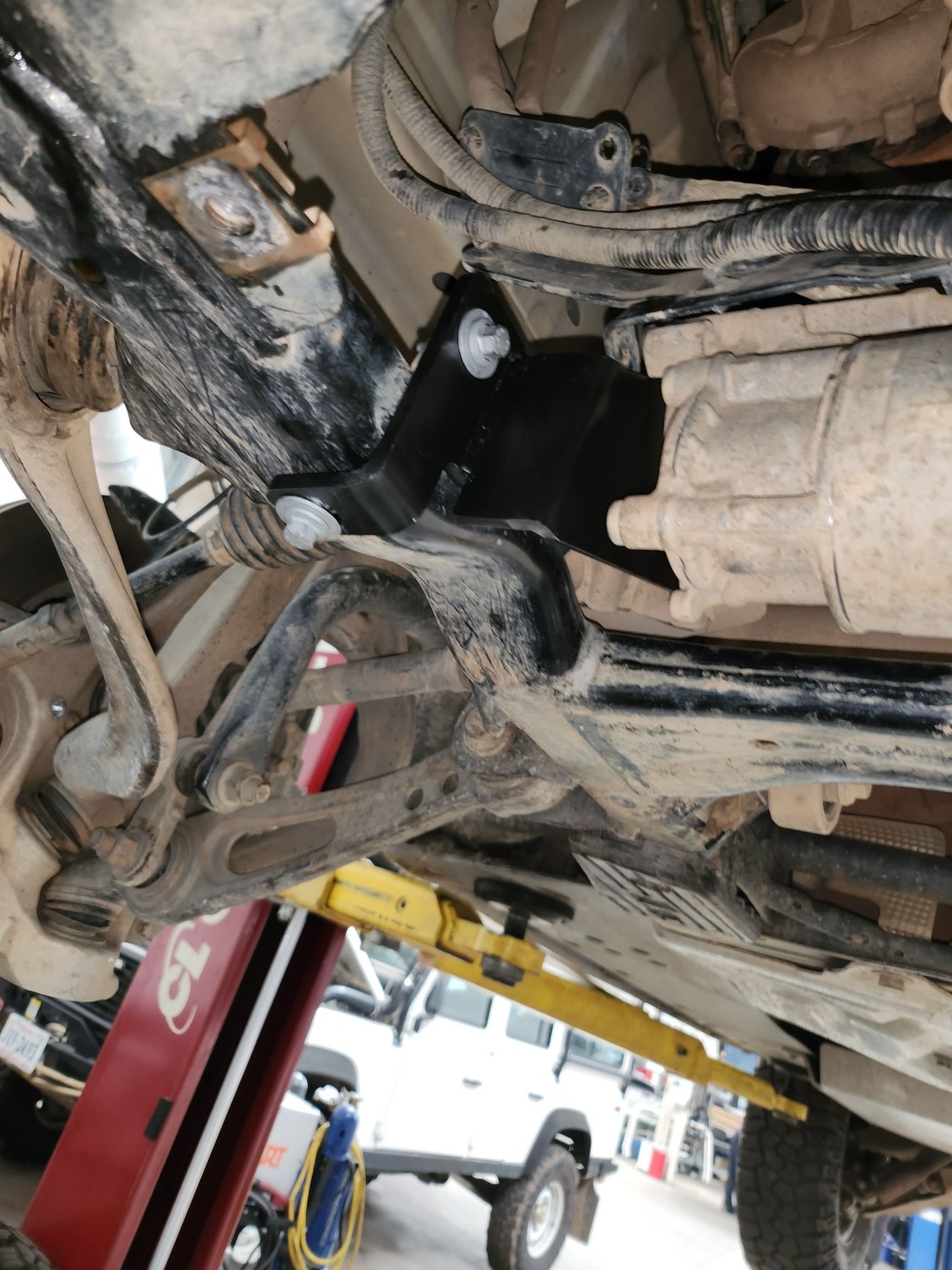

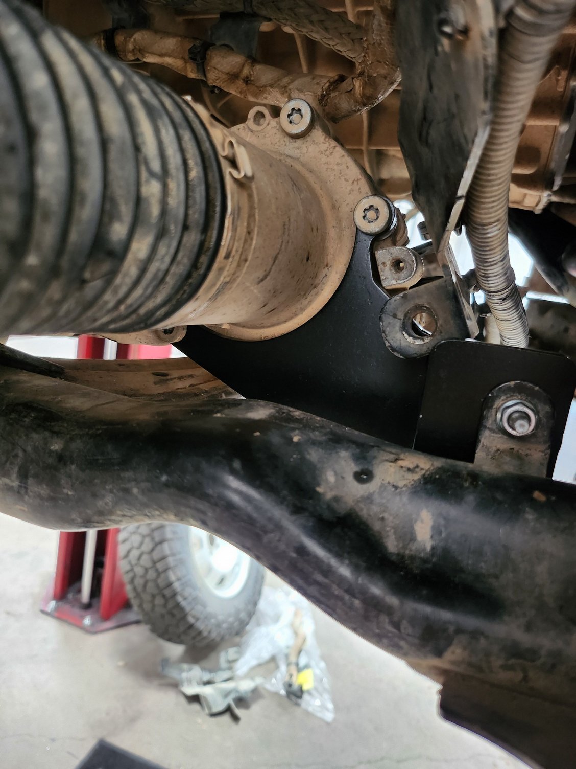

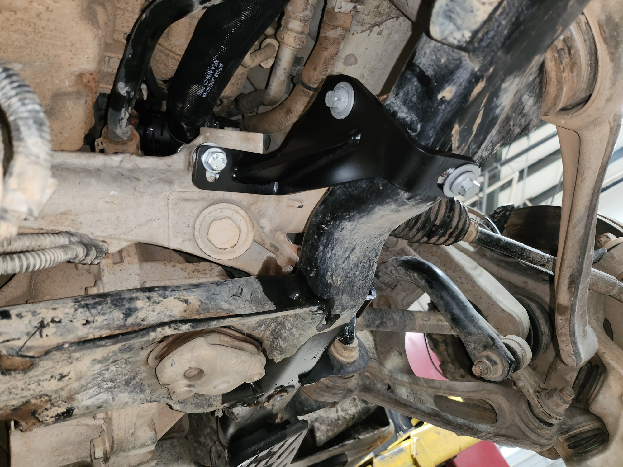

Here are some pics of the reinforcement kit we have developed. Basically adding 2 additional mounting points to the front of the steering rack. This now makes a total of 4 mounting points. We will also be putting the original mount in a double shear configuration. I believe this will be some simple insurance.
Looks great. Are you thinking of adding that to your stage builds? Or is it a repair for the very rare cases of this failure?
Definitely part of stage builds. We will also be offering it as a kit for purchase. i would suggest to add it before failure. Cheap insurance.
