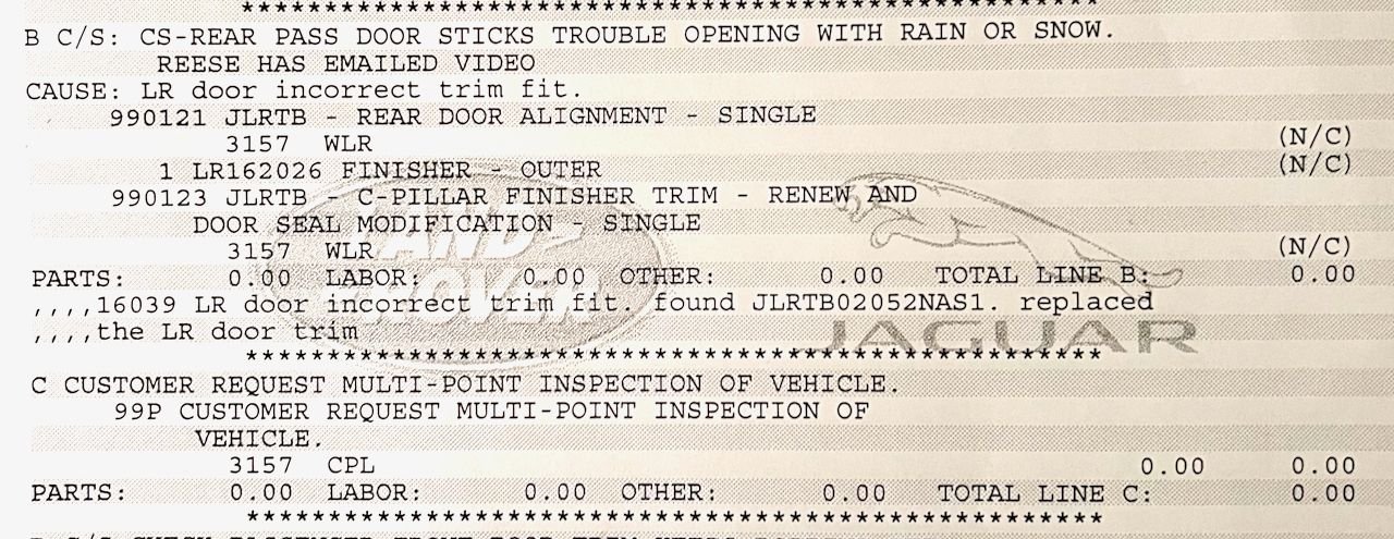

Got the issue fixed! It was a defective trim part. The dealer told me there is a bulletin issued by LR for this problem. The dealer had the car for about a week. Mainly because the part took a few days to arrive. Once received, it took them a couple hours to install. See attached photo for the part info.
Part for sticky door

2020 D110S with 21k miles -- I have the exact same issue in exactly the same place. It has been going on for months.
I will print out the correct part number and make a warranty claim when I get around to it. THANKS FOR SHARING THE DETAILS
Here is the technical bulletin direction steps for those interested......
