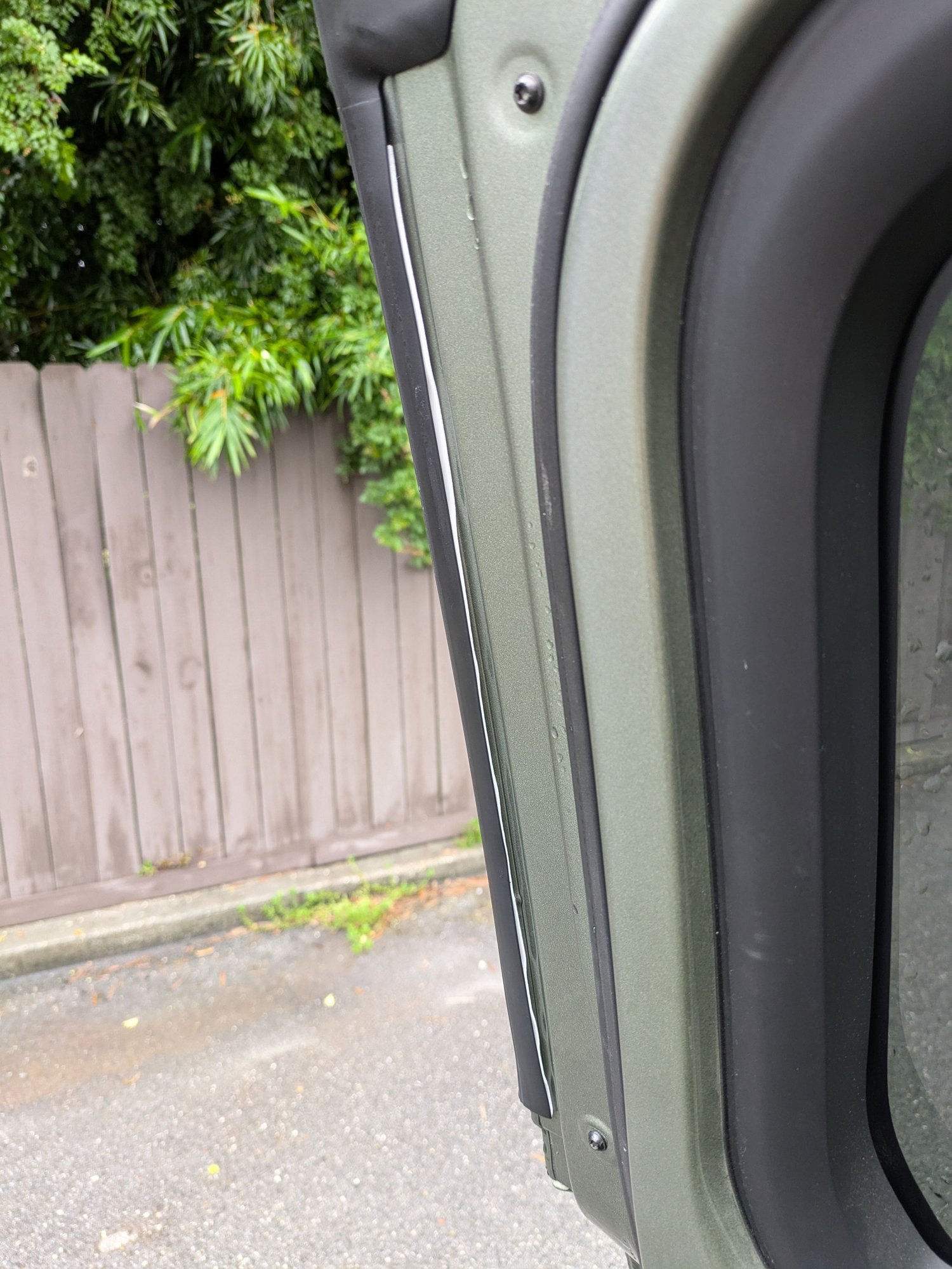

For me the fix was to stick some good double sided tape behind the seal. The issue is the outermost edge of the seal catches. The tap rotates the seal allowing for clearance. Driver side rear door was very difficult to open before applying some tape. I can take some pics if anyone needs them. I also applied tape to my passenger rear door. The seal wasn't causing issues, it just came loose and was flapping in the wind. Worth a try before leaving it with the dealer for 3 weeks.

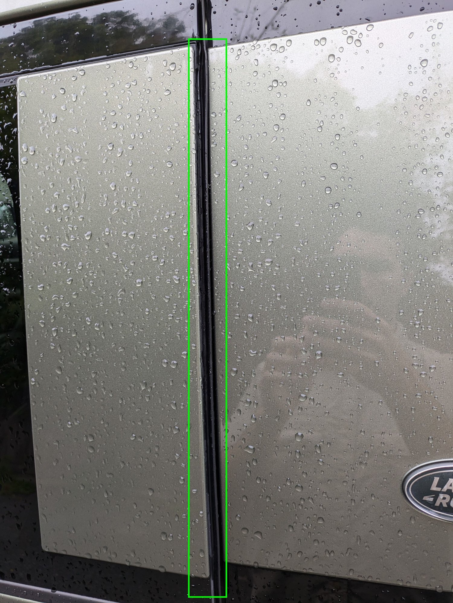

First pic is where I put the double sided tape. Luckily I used white tape so it is visible. The tape is around 2mm thick and 12mm wide. The second pic is the edge of the seal (in the green box) that catches on the rear glass. The goal is to keep the seal edge from catching the rear glass.

Thanks for the pics, Zac. So, it looks like your easy solution was to wedge some double-sided tape into the space behind the interior vertical rubber seal that is closest to the edge of the rear door to prevent the seal from catching on the glass when it’s opened in rain. I think I might try that myself first before submitting to a dealer fix. Sounds easy enough!
Question: is your second pic to show how the seal juncture looks after you have installed the double sided tape?
