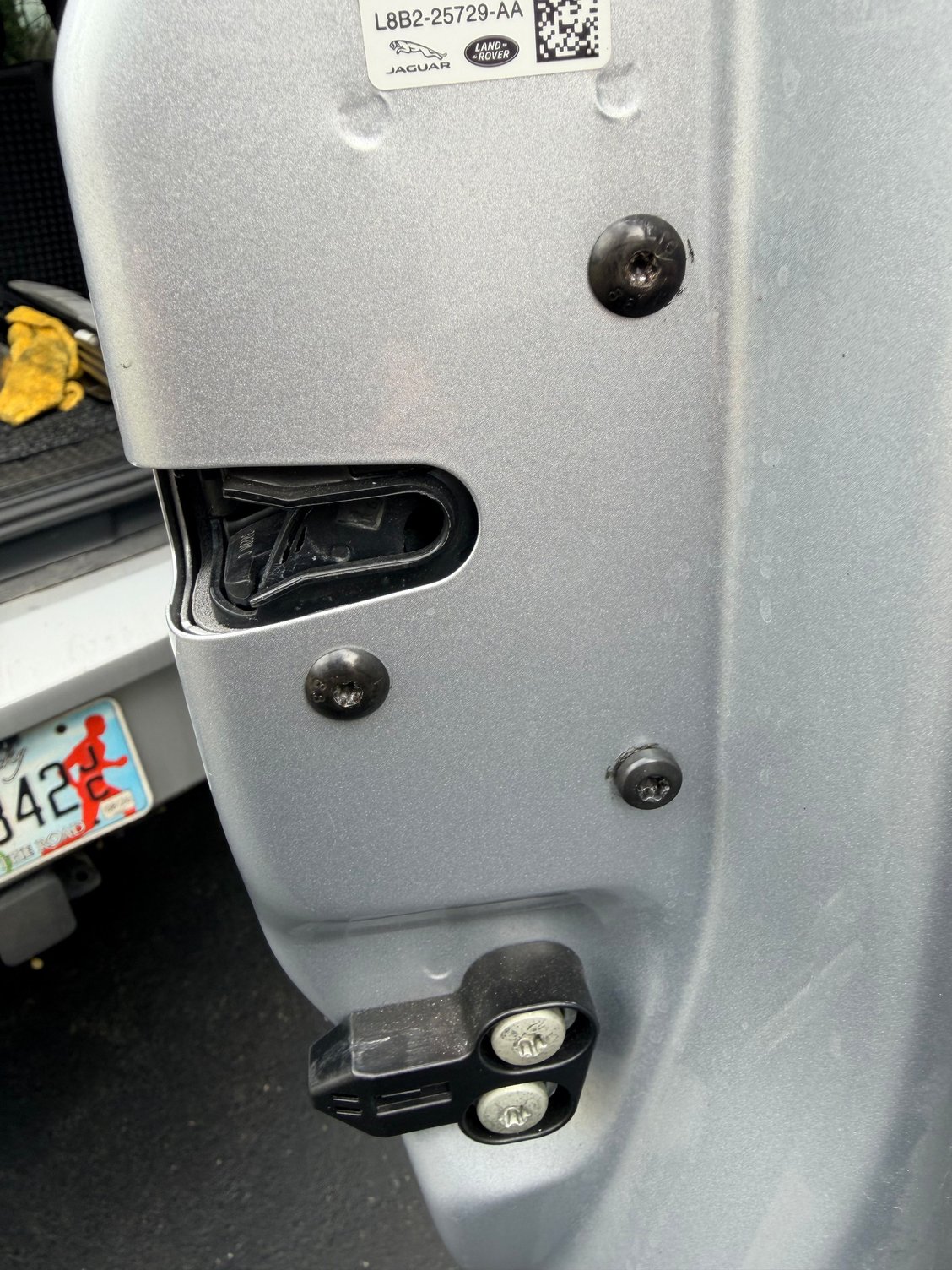

Just an fyi. My tailgate latch started sticking and not completely releasing. While checking the alignment I found one of the latch bolts missing, and the others loose.
I picked up a new bolt at the dealer. Surprisingly they had some in stock. They mentioned they must had been using these a lot lately. I noticed the new bolt requires a bigger socket with loctite pre applied.

I *swear* they gave you the incorrect bolt. That has a pan head, it should be more of a “mushroom” type of head.
I can’t imagine JLR would switch to a bolt head that has far less clearance in the door jamb.
Do you have the part #?
I mean, if it works it works but I think this is the wrong one.

I called and double checked the bolt they gave me has the same part number. I figured some how they found a part out of the bin they could consolidate.

That is the wrong bolt and it looks out of place. It is hard for me to believe that the service department would send your vehicle out in public that way.

And I agree, Pjazz got the wrong bolt. All of those bolts in the area a flat head, I'm sure by intent given the tight tolerances in that space. I think the proud head on the bolt they gave you could in itself cause a door sticking issue at some point if not scratching up the paint within that opening depending on the terrain you drive or angles you park and try to operate the door. They need to swap it out, they can see it is the wrong bolt looking at any other Defender on their lot or within their service department - regardless of claimed part number.
