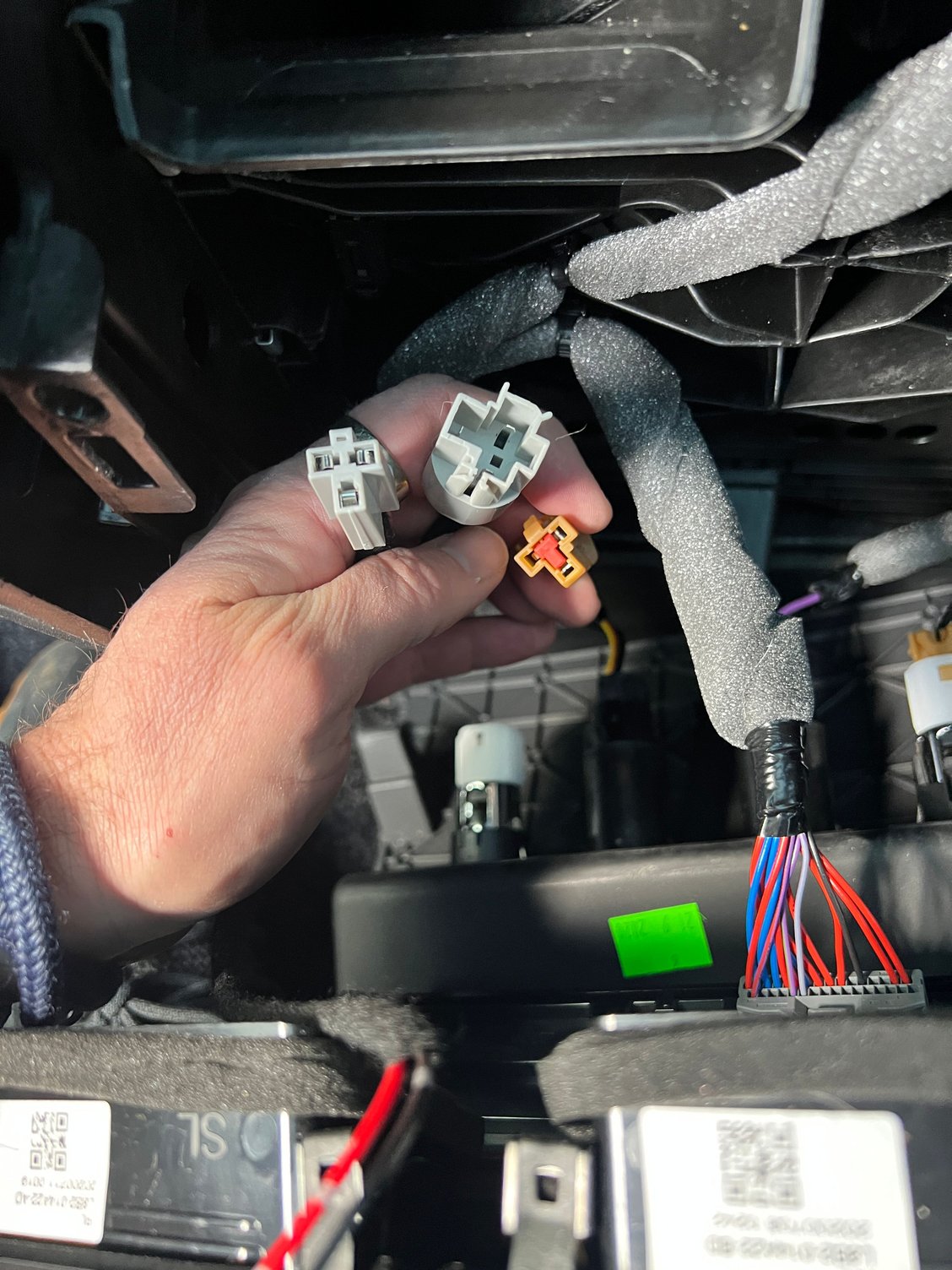

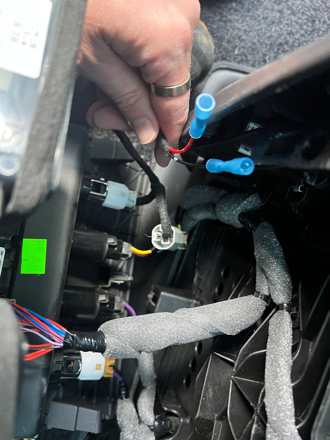

I hardwired in a GMRS radio (side note, awesome new hood hinge bracket for the stubby antenna from Saltek Motorsports which I bought from their website). Anyway, to tap off the rear power plug (not USB, the one with the lighter-style socket), I did not want to cut wires or alter the vehicle harness.
-- Looked at Simon's splitter harnesses...which are great but I wanted to complete the project this week, not wait for international shipping
-- Thought about sourcing a female connectorplug to use on my GMRS radio wiring, however, then I lose 1 rear power port and I couldn't find the proper connector anyways.
-- Finally, I figured out Jeeps use the same exact plug style that JLR does on the rear of the power ports. (3 prong)
Bought this from Amazon at 6pm, had it 10am the next day and now all wired in perfectly.
Amazon Amazon
. Harness appears to be decent enough quality and it worked properly.
