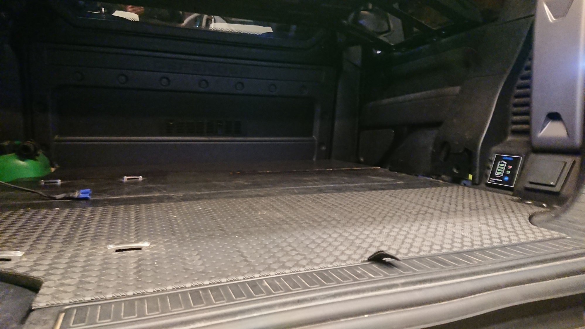

Finished this install yesterday. Side panel back and connected. Recovery gear back in place.
Flat flooring back.
Rubber lining and ARB fridge straps back in.

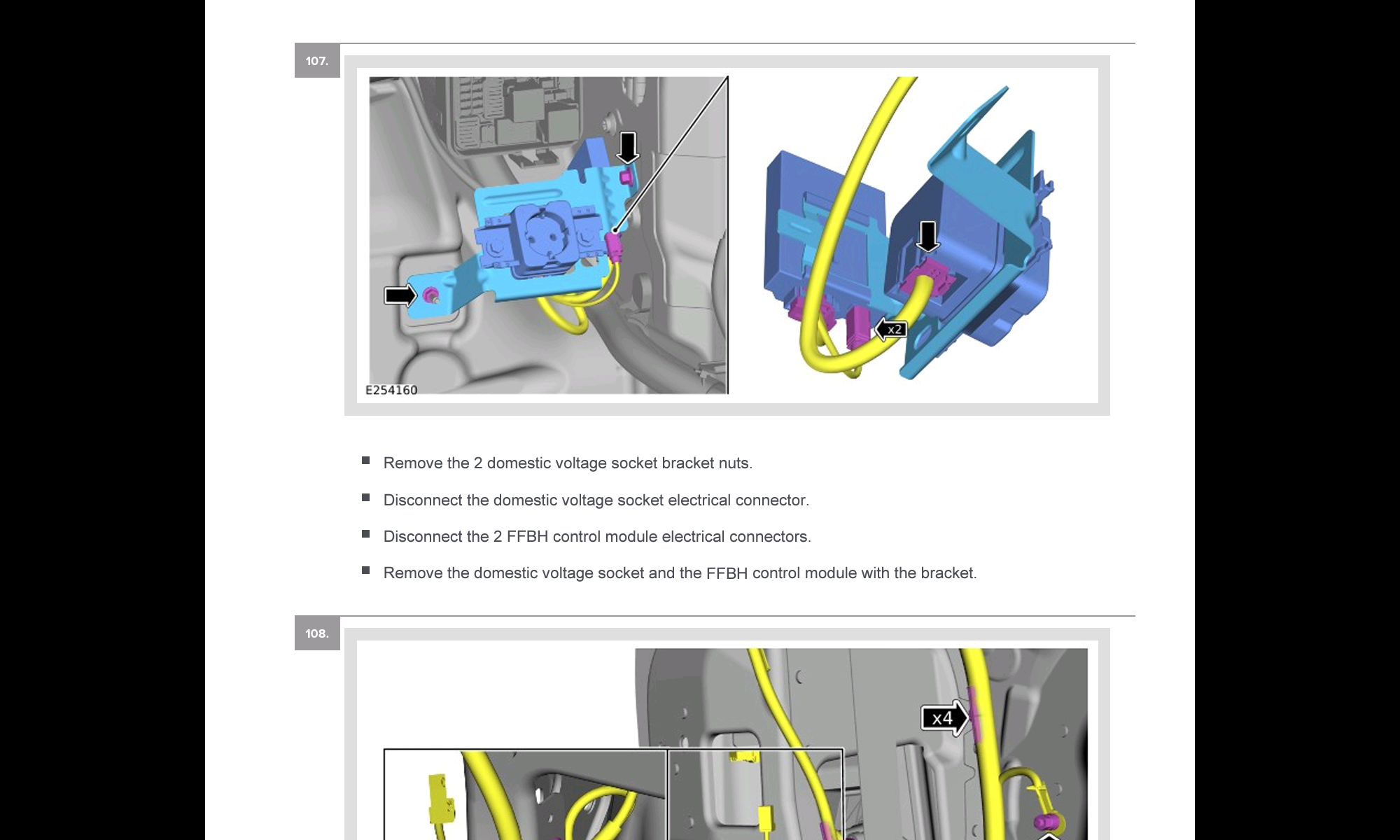

Question: I am not planning on Overlanding; however, I would like to increase capacity of the domestic plug in the cargo area to allow use of a 600 watt electric tea kettle. Without going crazy; could it be as easy as swapping the OEM inverter with a larger one? Would I have to replace the outlet itself as well?
On that note: where is the OEM inverter located?

No you can not just swap this inverter for a more powerful one.
You also can not use the outlet, needs to be replaced for a normal domestic one.
The inverter is located nearby the EAS unit, in the rear right side.
