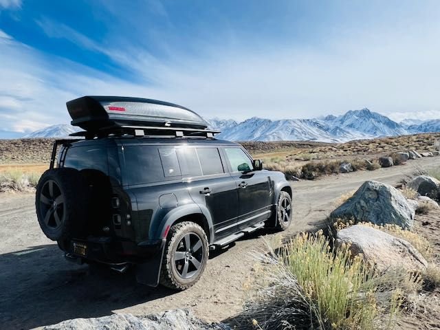

Default 1 year V8 roof rack experience
there's another thread on this, but I will summarize: we are all speculating, but it seems to be more of an issue with regulations than actual performance or capability. I say this based on weight differences and other factors that many others have commented on... I have a 2023 V8 and I installed factory roof rails and rack (I am also running 20" factory wheels and KO2 tires) I have nothing but positive things to say about my experience... I am also not driving 120mph or trying to drift corners in my defender, I am not getting anywhere close to its road limits....However, my local JLR dealer would not do the install soI had to have it done at an independent Land Rover Shop. That said, the V8 comes with the same factory mounts and all fits exactly as it does on the 6 or 4... no modifications required.
