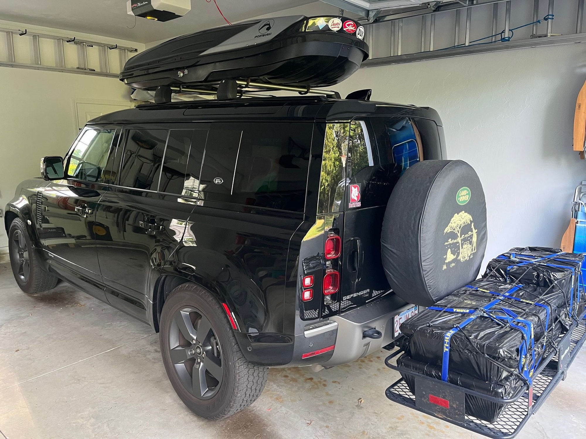

We packed our Defenders with over 2000 pounds of people and stuff for college move-in trips and they handled perfectly fine. Just be sure to run XL load-rated tires.

No question the defender is robust and the info in the owners manual says so. If you go by the capacity on the tire and load placard on the door jam you may be legally over loaded. What could happen if you get into an accident and your insurance says they won't cover the damages because according to the placard you're overloaded. This really concerns me and should concern every defender owner. The info on the placard is wrong.
