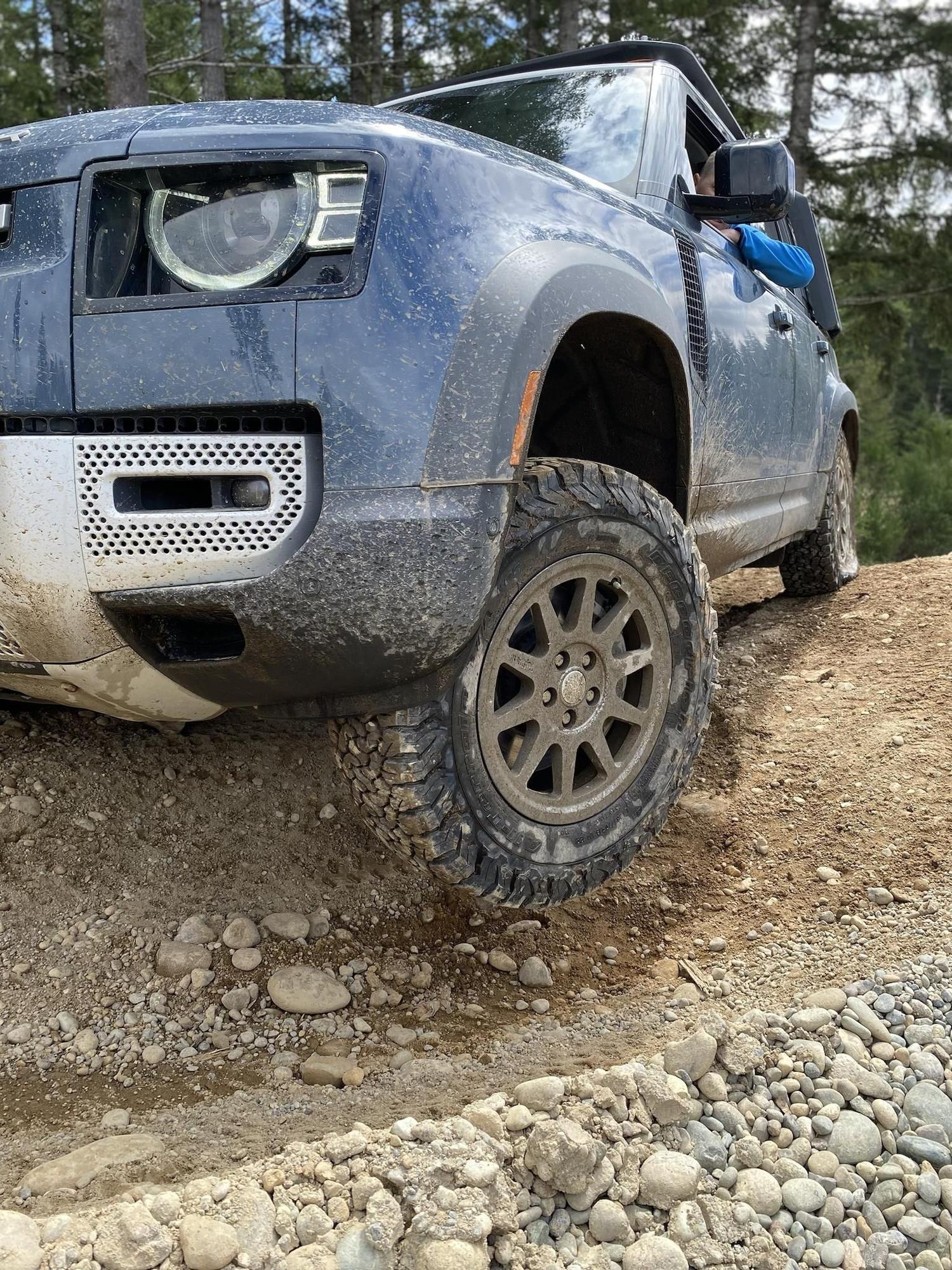

Love the wheels @GavinC . Sorry, thread depth question was for the OP, given he is wondering if it might be too late to start rotating,
